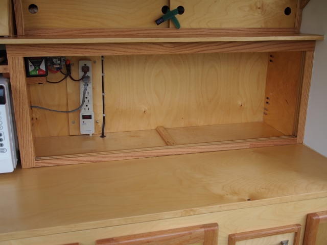

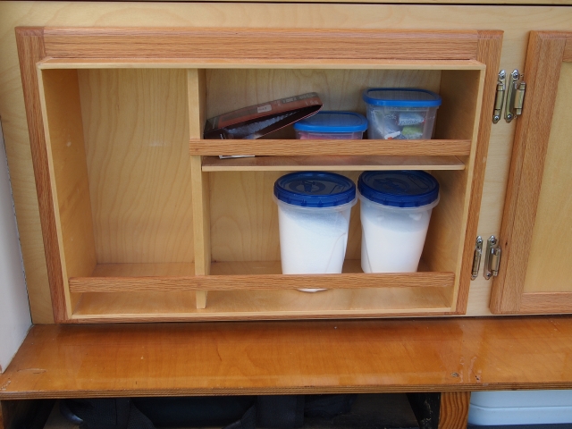

On the inner cabinets, we installed a 1/2 inch red oak barrier, to stop the baskets we use from sliding and knocking the doors open

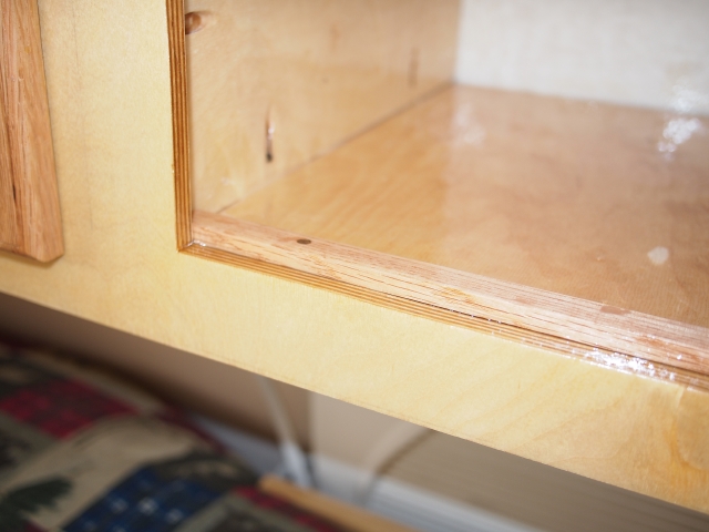

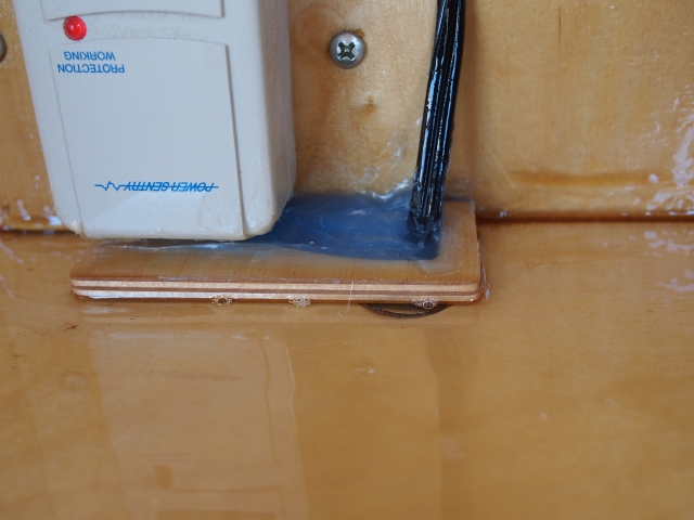

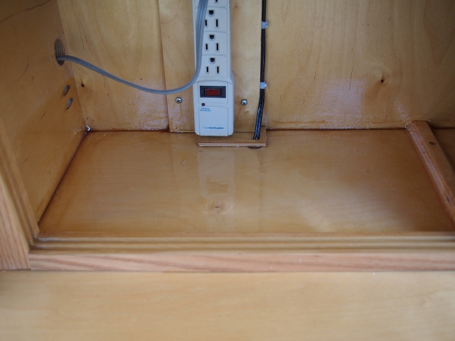

On the rear cabinets, we were storing the liquids in a basket to help protect from any spills, but it seems we always have more than will fit in the basket, so I fiberglassed and epoxied the entire bottom to help contain any spills
Before
After
I built a small dam around the wires and after epoxying it, filled it with silicone

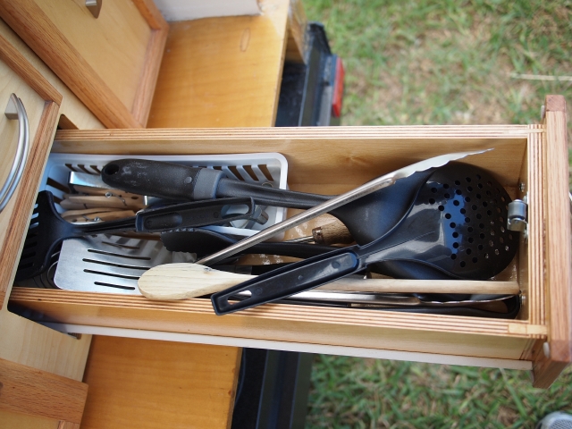

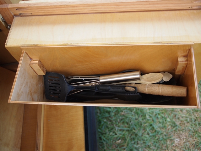

We had this one drawer, where we stored the large cooking utinsils, that always seemed cluttered and difficult to open and close

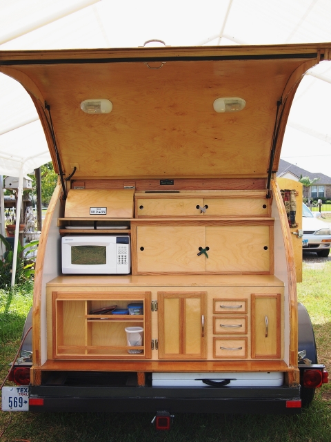

So on the rear of this coffee station, we had some free space
Where we added a box to store the utinsils

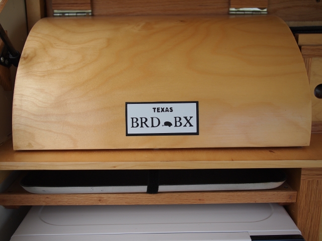

We cut from some vinyl a license plate for our bread box

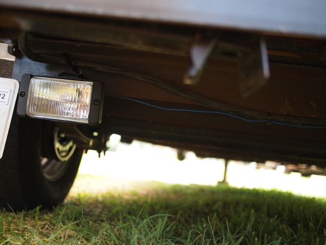

Installed some 55 watt reverse lights under the camper, so not to blind anyone guiding us in. I wired these to the reverse circuit in the truck through a relay I added

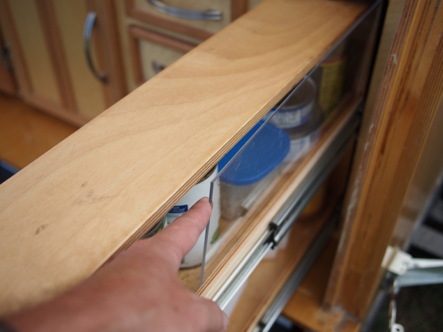

I am looking at adding plexiglass to one side of the pantry drawer to stop items from bouncing out a getting lodged against the wall

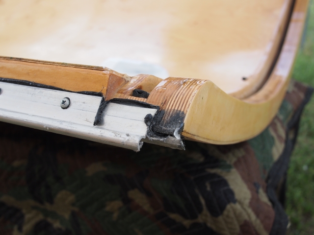

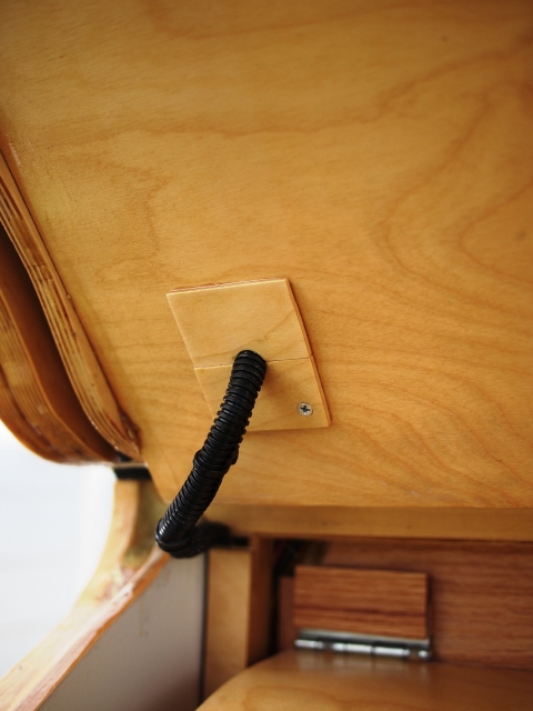

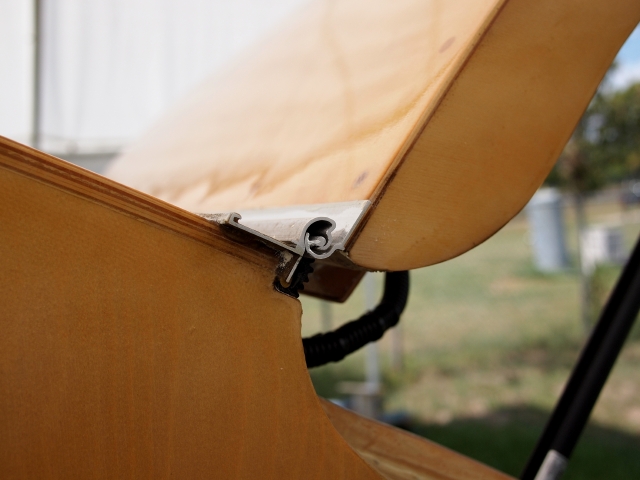

On the original install of the hurricane hinge, I goofed and cut it back too far, even though it did not leak, it would drip into the galley if it was open during a rain.
So we installed a new rear half of the hinge
and encased the wiring

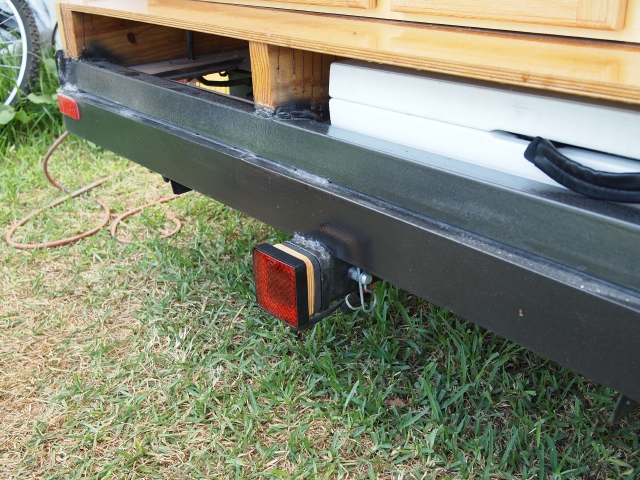

We installed a third tail/stop light

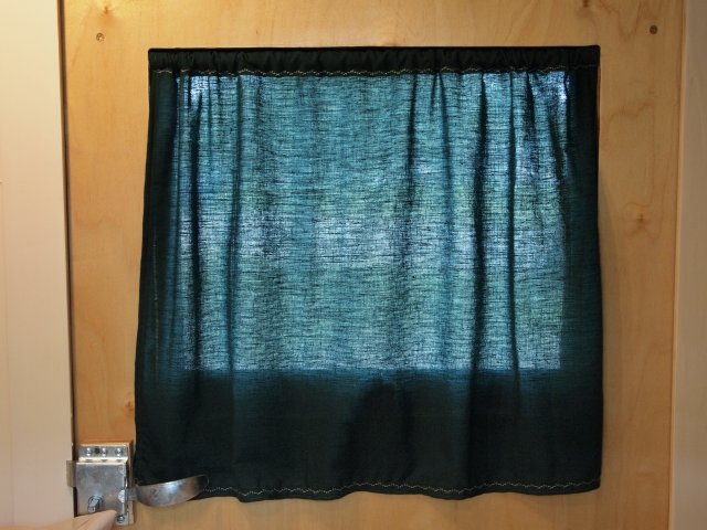

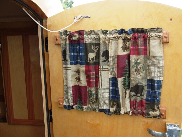

Our original curtains worked, but with them not being secured at the bottom, on windy days, we had to make sure we didn't close the door on them.
Original

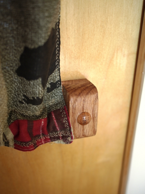

So we built some new curtain rod supports for the top and bottom out of some red oak
We installed the new curtains that Lianna sewed up to match the new bedding, and in this picture, you can see that we replaced the rope door limiter with ones we found in a cream color and secured it with a bowline because the caribiners we had could not stand up to the wind.
