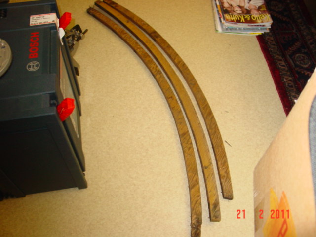

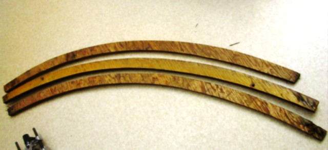

Well since its been colder than cold outside again and it doesnt seem to be letting up this week cant do much. However its time to start cutting side walls and ribs.
At the moment weve got templates of the Hatch Ribs and will be cutting them by router. We,ll do them for both Kits since they are being done.
10 pieces in total using Oak. The original ribs were rotted real bad so its time to lay them to rest and work on some new ones.
Here,s a pic of what I salvaged. The rest were totally gone off of Kit number 1 in progress ;) .
And the trusty Router will be waiting for tomorrow morning when we go out and get some Lumber. :twisted: Let the wood work begin.

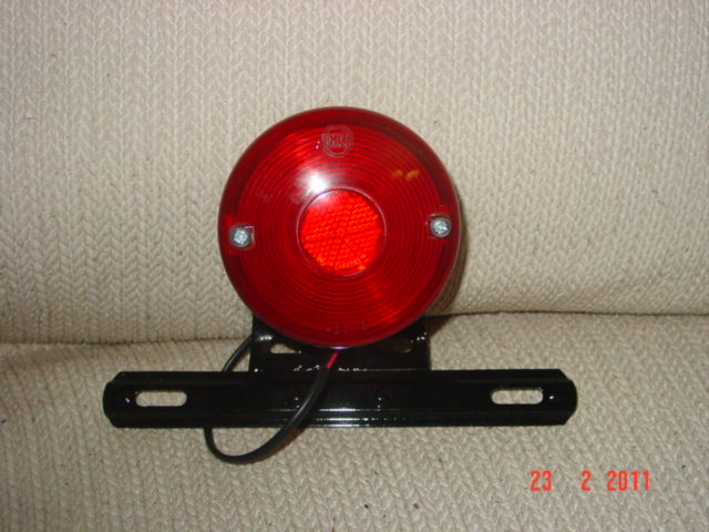

Classic Finn wrote:Stay tuned for the restored brake light pics coming shortly. :D Including the restore of the light lens ;)
Here,s a (before pic)

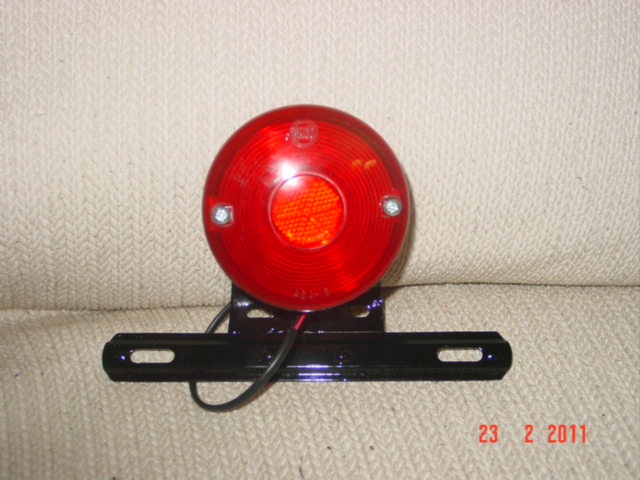

Postby Classic Finn » Wed Feb 23, 2011 1:07 pm
Ok here is the back light restored.. ready for mounting. All new wiring, bulb base and inside is painted in a high gloss aluminum paint so the lighting will be a bit brighter. Also the plastic lens was buffed out from scratches as is the license plate lens. All is as new.
I still want to buff the lense out more with the wifes polishing tool. And special polish for plastic & acrylic.
Im no pro but did it as best as I could. It was fairly rusted on surface outer and inner. Also it was lightly bead blasted and sprayed with a base paint and gloss black with 2 coats of clear. Also I used marine stainless screws to replace the 2 old ones.
The best of all is that no EU Law applies.. :R since its a museum oldie. :D
