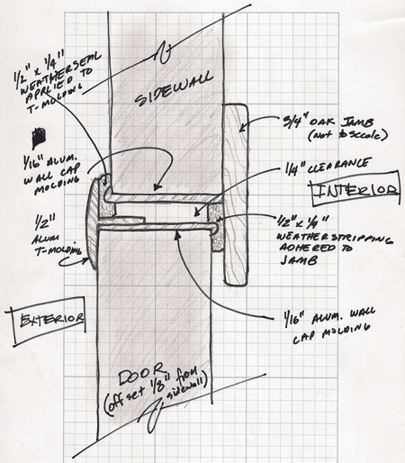

oh... regarding doors i just stumbled upon this (thanks to tom!)

Thanks Kent. I too saw that and it is a great help to visualize how that is all supposed to be. Thank you for putting it here I will need it soon. And thanks to Tom for sharing the work.
This is a classic piece of work that everyone should have. If you all out there are using Grants trim pieces or something similar you need this diagram!
Grants offset door hinges automatically give you the bumpout you need for the weather strip.
