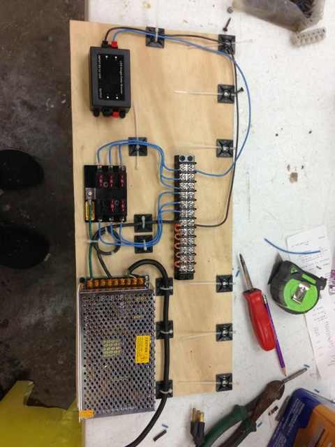

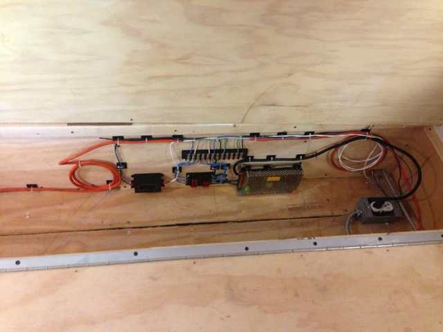

Finally sat down and tidied up all the electrical. I do not have a battery yet but all the lighting is 12v just incase it is needed. Just a ac to dc converter rated at 20amps with a 30amp 6 circuit fuse block. Then to the terminal strip. The black box on the left is a led dimmer that is also remote controlled for the under trailer led lights.

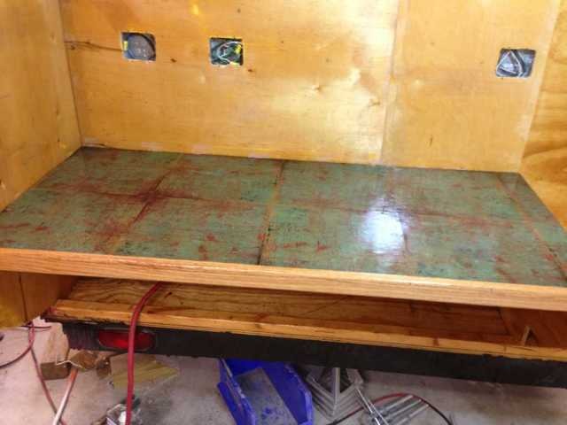

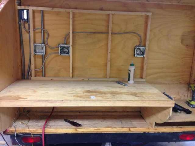

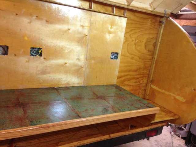

Also been working on the galley this past week. After a year of camping we decided how we wanted it. Built a false wall in front of the rear bulkhead to hide the electrical and insulate. Plenty of plugs and a spot for the light switches. Used urethane on everything to seal it up and the wife took some scrap booking paper and decorated the countertop. We have some white led lighting figured out as soon as everything dries.

Postby aggie79 » Mon Jul 22, 2013 9:24 am
Beautiful Clint!
What a tidy and neat wiring job. Makes mine look like spaghetti.
