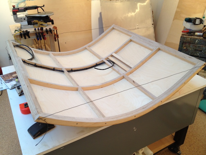

Re: 1955 Benroy - Rebuild (9/20 - Hatch question...)
Postby TRP » Sat Sep 22, 2012 9:45 am
I was looking at the differences last night over a beer.
The curve from side to side didn't change. I clamped the two sides together and sanded them to match after I cut them (waaaaaaaaaaaay back in July).
I think it's a combination of a few things:
1) I didn't use a laser level frame jig to line up the placement of the sides. It's hand built, they may be a little off.
2) We're talking about two separate hand laid laminate pieces - they aren't going to be identical.
3) Minor variations in the curve over a 4' length will result in variances at the end of the curve.
The difference is like 1/8" on some pieces and 1/4 on others. I think I'm going to scrap the ones with the 1/4" difference and simply lay up new pieces and pay closer attention to the side edge/curve on the new pieces. In the end, I only need 5 semi-perfect pieces to lay up the edges and the hatch. If I need to strengthen the hatch any further, I can cut the supports from ply wood like everyone else seems to do.
I mean, people do that for a reason. :)
Long story short, I think I was over thinking / worrying too much.
We'll see. :)
Ted

Postby TRP » Mon Sep 24, 2012 7:31 pm
Yeah, I'm starting to think you may be on to something. I worked on my hatch this weekend. Below are the results. It's a lot heavier than I had anticipated. Much heavier than the original!
The left side is near perfect. The right side, not as good. The lower right corner wants to creep out a bit. The arc of the right side doesn't quite line up like I'd hoped it would. even though it's missing the outer skin, the arc is off by about 1/8 of an inch. I'm thinking about scrapping this hatch and simply rebuilding it the way you and Mike did yours. Unfortunately that marine grade plywood is really expensive. What thickness did you guys go with?
Please have a look at what I created below and let me know what you think:

Postby CliffinGA » Mon Sep 24, 2012 9:38 pm
Ted mine was off a little also do I made 2 sets of spars by using the walls as the template and routed from it. i attached the plywood to the side with clamps and routed half and moved clamp and routed the rest of that side and then did the other. Took each off and did a 1 1/2" sut to finish each and used to route my others, 4 for each side, then glued 2 together of the same batch to make my outsider spars and used the rest as the spars in the center sections. It worked out good and was better when I attached the outer skin. Its my 2 cents worth on how to do it anyway!Hope it helps bud!
Cliff :thumbsup:

Postby real550A » Sat Sep 29, 2012 4:24 pm
Ted, and all...finally, posting from a computer away from home! As I explained to Ted, via email, I have HughesNet
satellite internet and it keeps logging me off, every time I try to post here. Frustrating!
Ted- I used some left over 7 ply, 3/4" sanded plywood for the ribs. Glued two together, then belted them uniform. Seemed
to work well, and the hatch is very strong and light. I treated them with wood sealer, before closing them inside. Mike
real550A

Postby TRP » Sat Sep 29, 2012 10:34 pm
real550A wrote:Ted, and all...finally, posting from a computer away from home! As I explained to Ted, via email, I have HughesNet
I think I'm going to give in and do it that way as well. I thought I had it ready to skin, but I want it perfect. Sooo, tomorrow I will go down and buy some 12 laminate birch ply and do it 'your' way. Hopefully I can make some progress tomorrow. I feel like I've kind of stalled out a bit. :(
