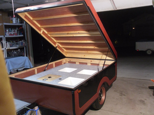

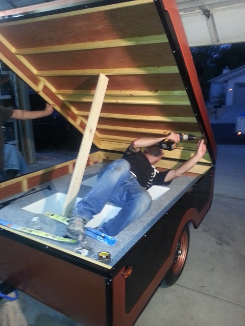

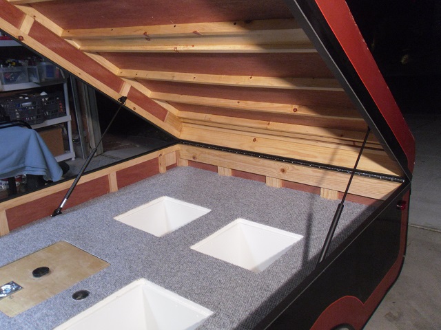

Here, installing the pneumatic rams to hold up the top. They worked perfect! just the right length and psi. The lid opens itself and then isn't too difficult to close.
Working late into the night. HOT night. Cutting out the nylon tent material after the test fit.

Closer view of the inside, storage boxes, rams, lid....
Further back

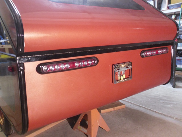

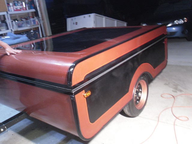

Back of the trailer. Brake/running lights, licence plate holder. Hinge...
Blurry side view. almost completed outside... Whoo whoo.. :applause:

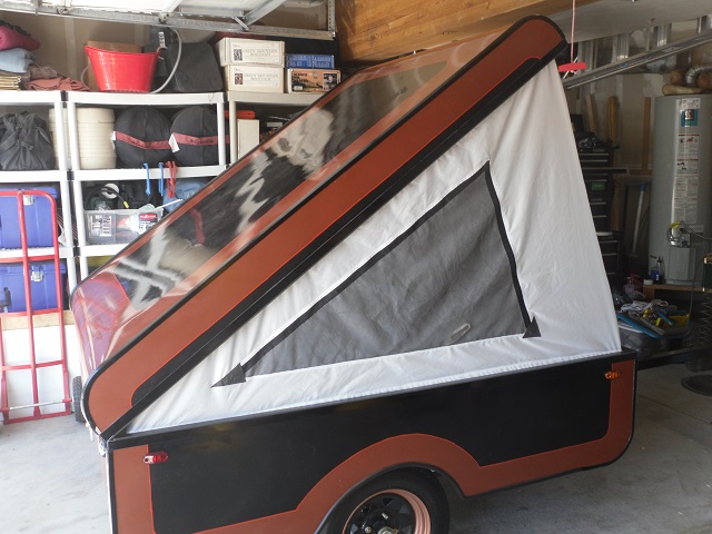

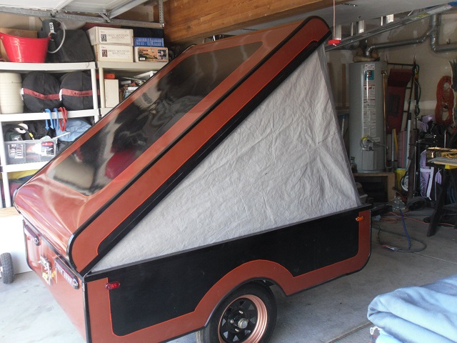

harleykamper wrote:Test fitting the patterns. Mock up. Made from the floor of an old tent. We only shortened one dimension by 1/2". Measure twice, cut once.... :thinking:
Another view of the mock up.
One quick comment ... with your fabric attached on the inside at the bottom, any rain/dew/whatever will run inside the trailer. Perhaps a little "flip out" piece of fabric to divert moisture to the outside.
Very nice project BTW.
One quick comment ... with your fabric attached on the inside at the bottom, any rain/dew/whatever will run [i]inside the trailer. Perhaps a little "flip out" piece of fabric to divert moisture to the outside.
Yep! We thought of that. Good pickup! That's what they do on the Lees ur lite trailer also. I'm still torn between a waterproof flap that will snap to the trim on the outside, or a rain fly! Or both..... :roll:
We are expecting rain on this trip and the trailer will fill up pronto with a big down pour. I'm leaning toward the flap. It's not hard to sew and a couple of snaps will hold tight. Also going to need a rain gutter across the front, top lid. Because water dripping off the roof will hit the front tent material. I'll probably still make a rain fly to really make it comfortable in significant rain! A rainfly that has a vestibule in the front over the tongue. And if we really start getting wet, it's off to the hotel anyway. Since we're traveling cross country, it's not really a camping trip so we're not staying at any campground more than just one night. The 3-4 day layovers are at family and friends houses. I hope to have enough time to work out these little details before we leave in mid Sept. :NC

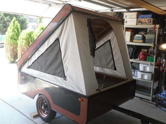

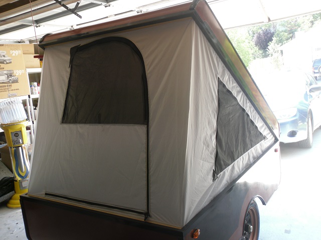

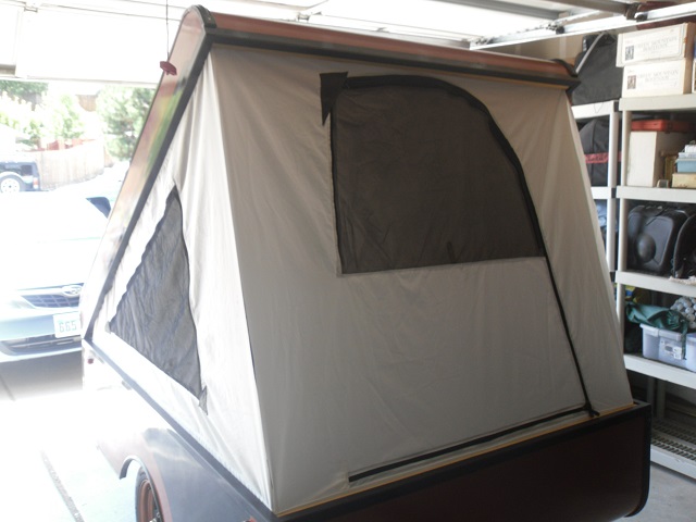

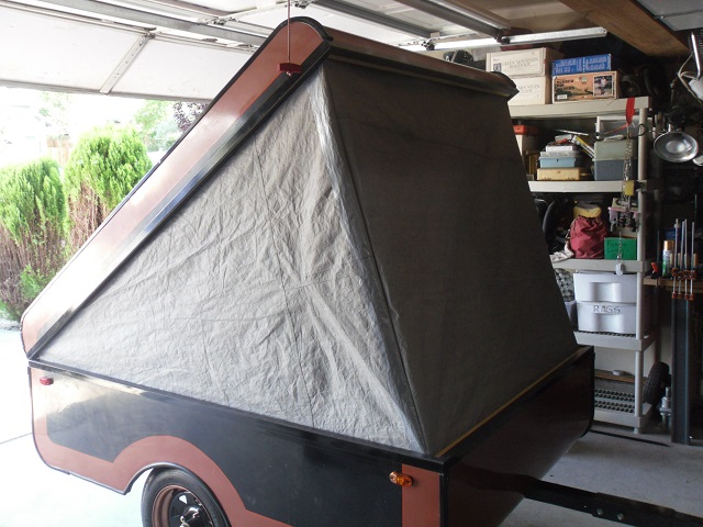

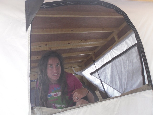

Spent all day working on the tent, sewing the pieces together, zipper covers, rain bib, etc. Wednesday I'll spray the tent with polyurethane spray to waterproof it. I'm hoping with polyurethane and lots of seam sealant I can forgo the rainfly. I'll need to install a rain gutter along the top edge over the front. That would take care of most rain and if it got really bad, it's off to the hotel. Again this upcoming trip is "travel", not camping per se.... :roll: We need to save weight on this trip. After spraying the tent I'll install it!! Then install the latches, locks, and remove two of the leaf springs to soften the ride. Good to Go!! :thumbsup:
In this pictures the two sides and the front are not sewn together yet, just test fitted. This is the front of the trailer. This is where we will enter through.
Right side view. Without the rain bib sewn on yet.
left side view. Still lots of wrinkles, I haven't secured the tent material to the trailer yet. After I do that it will be tight and smooth all around.

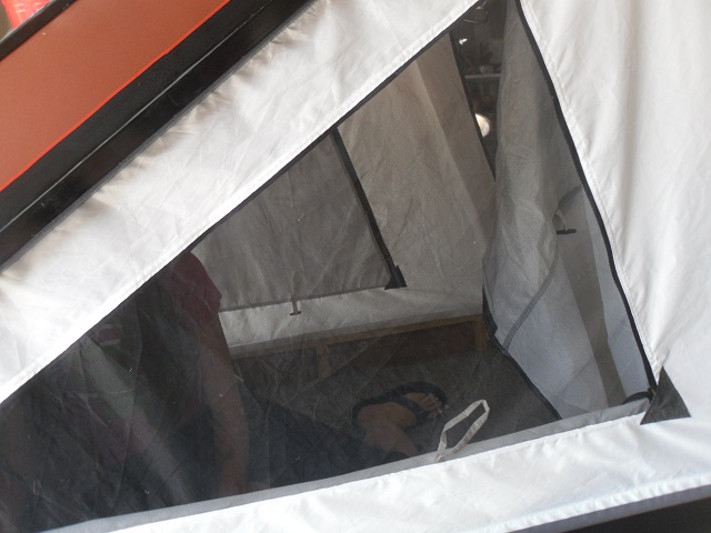

Looking though right side window. These are fairly large windows. Hopefully enough flow through ventilation.
My lovely and extremely helpful daughter. She has been invaluable in sewing this tent portion of the Kustom Klamshell Tent Trailer. It looks great because of her!! :applause: :applause: This is looking through the front door.
Looking though the front door window. That gives us three windows to ventilate this thing. I hope it's enough.
Full view, still without the rain bib along the bottom edge.
Starting to test fit, measure the rain bib.
I hope to take a test spin this weekend. See how she pulls. Still need to put on the decals and wax it. Make it all pretty like... ;)
