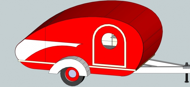

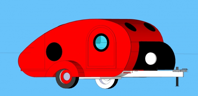

The colour selection process was to go from an original sage green and white design (sage green was the stumbling block) decided on a red and white, much like a Chevy Bel-air flash down the side.
This changed as apparently red and white represent blood and bandages (Barber pole) so with this information from Sara (ex nurse) the colour needed to change. I really liked the red. Well a ladybird was the obvious choice. I've added on a tongue box as the "head" of the ladybird. I thought plastic antenne would be finishing touches. I've now bought polyester resin and "pirate red" pigment....When it warms up enough, I'll get it painted and glassed.

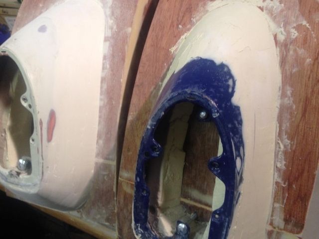

The joys of vody-filler, I'm on fill number three and the job now is filling holes rather than sculpting. I've never done this before and it seems to be working really well. Once it's the right shape I'll fiberglass it to the wheel arch/fender.
This a before and after....not perfect by any stretch of the imagination. Since I've taken this photo they have both been sanded, re-filled and are curing today ready for final sanding tomorrow.
Once these pedestals are completed, I'm going to fibreglass the inside of the wheel arches/fenders to strengthen and also waterproof the whole structure.
The earlier post showing what I did with PU foam to build the pedestals.
