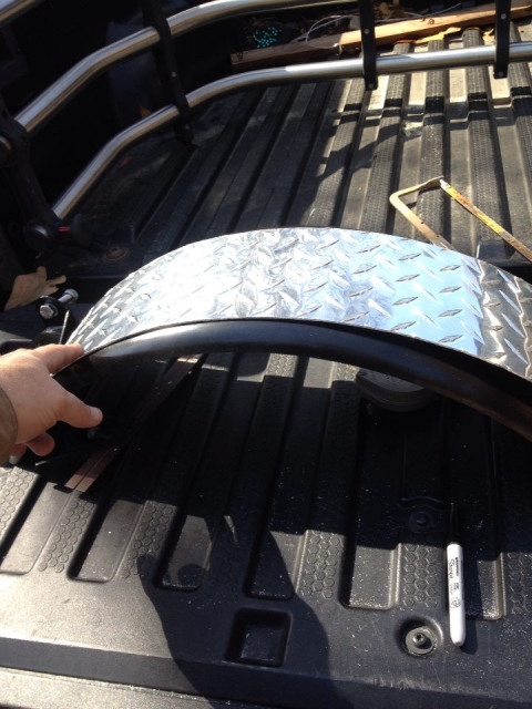

Postby Tommy2tone_1999 » Fri Feb 06, 2015 11:55 am

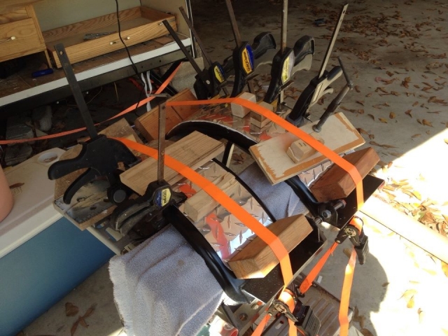

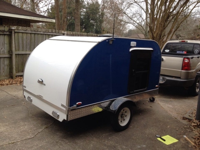

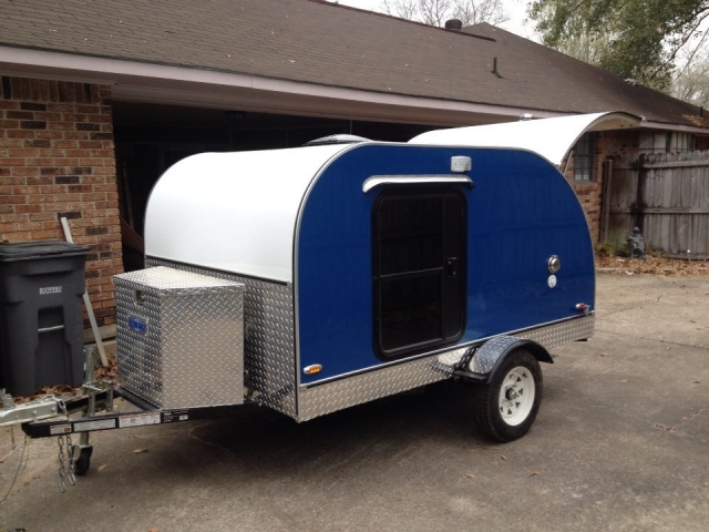

Using some scrap diamond place to make fender accents.
Wheels, fenders and trim all on. Decals coming soon.

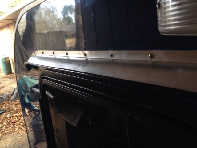

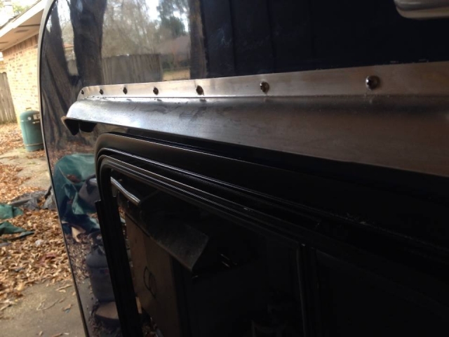

Drip gutters installed over doors.
Covered the sharp edges with auto door edge trim.

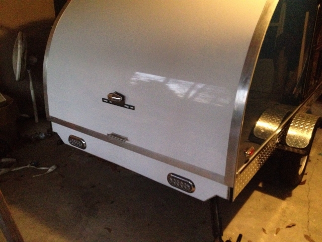

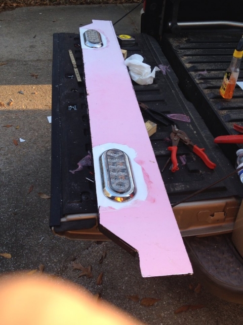

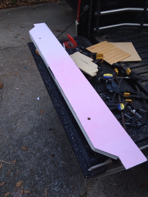

Making and installing the rear bumper and tail lights.

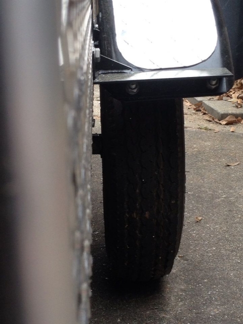

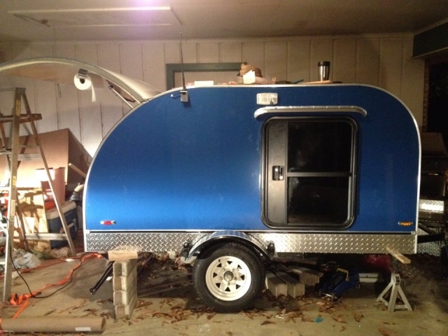

Postby Tommy2tone_1999 » Sun Feb 15, 2015 11:14 pm

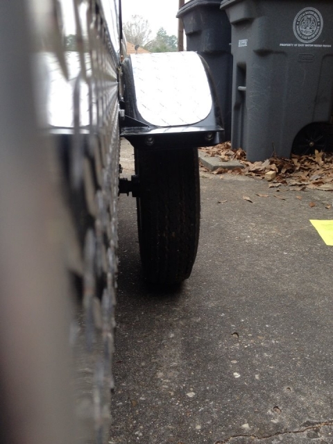

After adding ¾" walls, aluminum skin and diamond plate, I am left with only ½" clearance between the tire and wall.
To fix this I put on 1" wheel spacers over the existing hub.
Now I have 1½" clearance.
Getting really close now.

Postby dales133 » Mon Feb 16, 2015 1:17 am
Looking good mate.what plans did you use...was trying to work it out from the hatch/galley style

Beautiful build. I was wondering were you got the 1 inch spacers for your hubs? thanks

Thanks Dale, I came up with the plans by looking through all the great builds here, then picking out the elements I like and incorporating them into my plans. I can't tell you how many times I changed things as time went by.
Bass, thanks. I ordered the spacers through Amazon.

Postby Tommy2tone_1999 » Tue Feb 17, 2015 10:12 pm
I spent the weekend trying to trouble shoot problems with my running lights. Looks like it's in the hatch. I think I may have planted a screw right through the wires to the license plate holder. Oh well I guess I can sacrifice that lighting up.

Re: Mobile Fit Club Build - Tommy2tone_1999
Postby lfrazer98 » Thu Feb 19, 2015 12:15 am
Tommy2tone_1999 wrote:I spent the weekend trying to trouble shoot problems with my running lights. Looks like it's in the hatch. I think I may have planted a screw right through the wires to the license plate holder. Oh well I guess I can sacrifice that lighting up.
Just make sure that your license plate light doesn't have to be lit for registration purposes/inspection. It was on the list of things that my trailer had to have for NYS, but we are a stringent state... Sorry to hear that though. There were a couple times that we placed screws and then said "I hope I didn't hit that wire. I forgot it was there." Luckily everything worked in the end and for inspection. :) Looking great!
Postby Tommy2tone_1999 » Fri Feb 27, 2015 9:34 am
Lauren,
I checked Louisiana law to see what it says about a license plate light. Here's what I found:
Louisiana Revised Statue 32:304
(C) Either a tail lamp or a separate lamp shall be so constructed and placed as to illuminate with a white light the rear registration plate and render it clearly legible from a distance of fifty feet to the rear. Any tail lamp or tail lamps, together with any separate lamp for illuminating the rear registration plate, shall be so wired as to be lighted whenever the head lamps or auxiliary driving lamps are lighted.
I guess I have more work to do :FNP

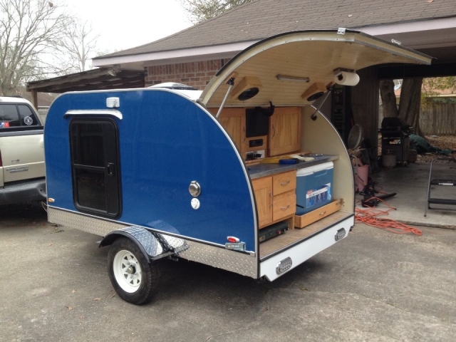

Postby Tommy2tone_1999 » Mon Mar 16, 2015 9:39 am
The Galley. Thanks to all those who posted pics of their galley.. I went through hundreds of pics to come up with the design elements I wanted in mine. It really helped to see all the others.
