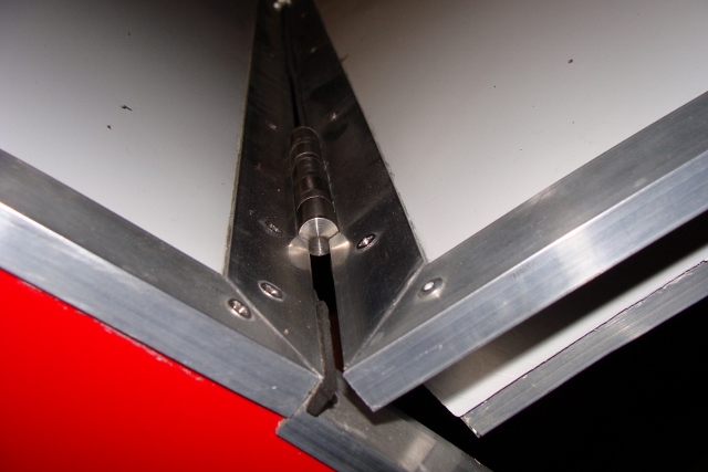

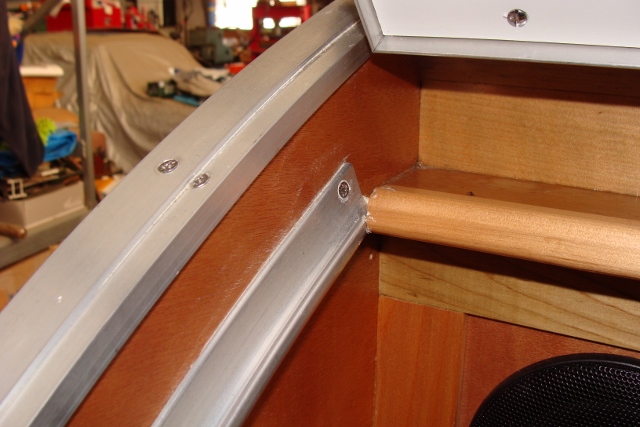

I assume the molding you are referring to is what I have covering the join between roof and sides. It is unequal angle alloy, we got it from Ullrich Aluminium , part No. UA1093 1.6x25x12x5m. I used it all the way around the roof and the hatch.
Click here is their extrusion catalogue http://www.ullrich.co.nz/pdfs/Brochure_pdfs/ebooks/extrusion/files/index.html
I also used UA1731 1.6X20X12X5M around the inner liner on the hatch. This had three uses 1), to protect the edge of the liner, 2), to have a tidy finish along the edge of the liner, 3), to created a drip line for any water that gets in that far and direct it into the channel down the inside of the walls. I also used UA1534 22X10 down the back edges of the walls under where the hatch closes. I put one each side and over lapped them. I wanted to use a U section there but they are all deeper than they are wide and that wouldn't have bent around the curve and would have looked too heavy if it had. They come in 5m lengths and at the time were about $12 - $14 +gst per length.
The channel I used in the galley is UA1410 drip mould 22mm comes in a 4m length.
Couldn't find Hurricane hinge in NZ and didn't want to risk damage possibilities of shipping from overseas. I got three big stainless steel hinges from Bunnings, and with the alloy trims have a narrow gap with a foam weather seal. The hatch overlaps the walls down the sides and I have the foam seal down there as well.
Should any water get past there I have a ledge across below the hinges and the drain channels down the sides. We haven't had any issues with water getting in to the galley either camped or on the road.

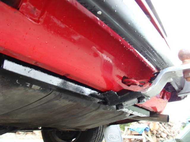

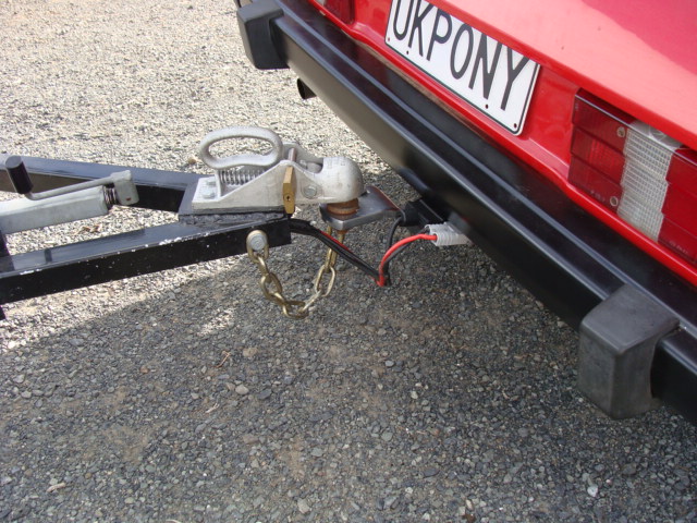

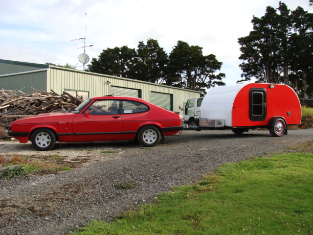

It was about time to give the old Green Capri a rest and reluctantly put a towbar on the not so old Red Capri to give it a turn at towing duties.
Unfortunately it wasn't just a case of going down to the local Ford dealer or auto accessories store and buying one off the shelf, most of the kids that work in these places wouldn't know what a Capri is. The towbar installers would have to make one from scratch and I wasn't prepared to let them loose on Dales precious toy. We checked with the Capri club, but not much luck there, then looked on ebay, but shipping from England was too expensive. I had seen some pictures which had given me some design ideas so decided to build my own. I had taken a towbar of a Sunbeam Rapier that I have sitting in the basement that I thought I could adapt but ended up only using the tongue. The issue is that there is not a lot of space between the rear valance and the fuel tank. To put it behind the bumper, bracing was going to be a problem and I didn't want the main beam hanging out where it was in plain view. The gap between the rear valance and the fuel tank was too tight to use tube, but I had a good hefty length of angle that I could squeeze in there and a length of flat bar that would weld inside the angle to box it off. More of the angle mounted this to the sub frames just behind the spring hangers with bolts going through non crush spacers in to the boot area, with big backing plates. To stop any for and aft movement I took braces from the bottom of the angle forward to where the exhaust mounts go through the chassis rails (v6 Capri has exhaust each side). There are anti crush tubes in there too so was a good solid mount point. It has ended up tucked up mostly out of sight and is as solid as the proverbial brick out house.
All wired up for lighting and the heavy wiring for battery charging in the TD.
