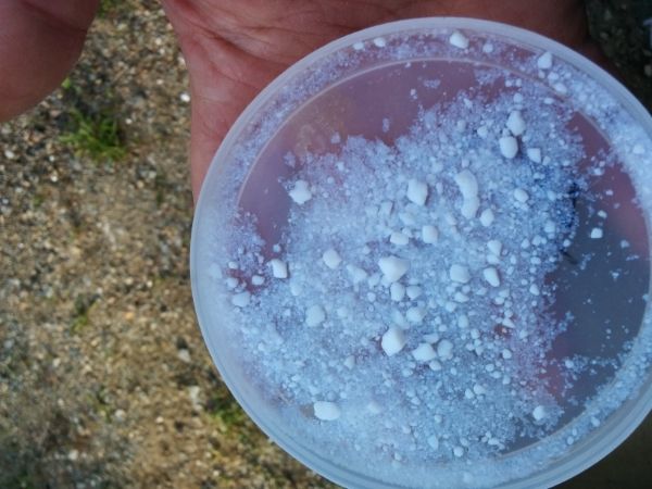

In my haste to get the trailer moved, I didn't bother to goop up the bottom of the tongue box the way I had the floor. It made the run with the front edge secured with two carriage bolts, which I now undid so I could flip it over and make a nasty, gooey black mess. I have found that cutting the roof patch with paint thinner makes it a lot easier to soak into wood...and skin...and brand new leather seats - not sure how I'm gonna 'splain that one when she notices it. :lol:
I'm certain that any long term benefits gained by wearing a respirator in the previous step were promptly undone by my impromptu arm-bath in straight paint thinner to get rid of the offending stain (Out, damned spot. Out I say!). I'm a mechanic and see nothing wrong with being covered in grease, dirty oil, or anything else rolling around in the bilge of a boat, but a let a few drops of paint hit my skin and I cry like a little girl.
I got the box gooped up and after it dried I flipped it over and put the bolts back in. The back edges and top are going to get glassed so they blend into the front and side walls, so another glass job was ready to go.

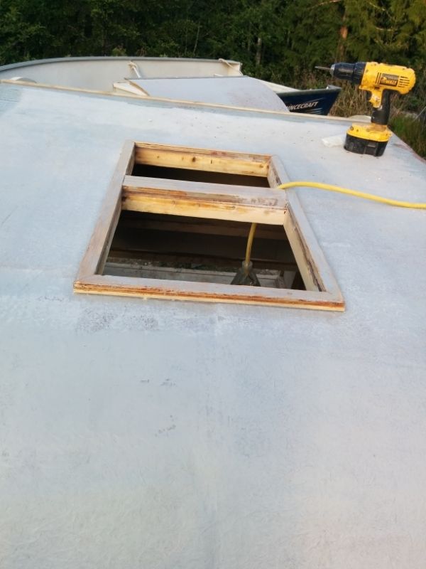

Third time's the charm - I got up to where I could work on the roof and pulled off the scrap of 1/8" ply I had pinned over the hatch/skylight opening. I pulled out the remaining pins and ground/sanded away the excess glass from the inside edge. I mixed up some resin with some cab-o-sil to make a thick resin-based glue lovingly referred to in the industry as bearsh*t. I glued down the curbing I had previously made up from 1/2" ply to keep any standing water on the roof out of contact with the hatch/skylight fasteners. The screws will be heavily bedded in sealant but the first rule with any sealant is not to rely on it !
The next job was to cover it in strips of glass so that the roof glass would effectively run up and over it, so now that too was ready to go.

I picked up the aluminum strips to secure the gasket over the piano hinges on the hatch and tongue box. I tried some scrap material we had around the shop to figure out what thickness aluminum to use. Because the gasket material I'm using doesn't compress much, it didn't seem to make much difference going with thicker stock to keep it from puckering where the screws went in, so I ordered 4X 3/4" wide strips of 1/8". If it doesn't seal I can easily replace it with thicker material later. I had mounted the hinge to the hatch and roof at every other screw hole so I could use the remaining ones to secure these strips as well as the hinge. This is the tongue box hinge with its strips drilled out (every hole on this one, every other one on the hatch hinge):
And the way they'll be installed (imagine the gasket between them):
Like the hatch/skylight, I wanted to have a bit of a curb at the hatch hinge to keep the screw penetrations and the edges of the hinge and gasket up out of any potential standing water. I ripped a 1/8 X 1-1/2 strip of pine that would serve as a core for the glass that would wrap up and over it, encapsulating it. It should also help as a 'gutter' to channel wind-blown water outward from the hinge while driving in rain. That strip is serving double duty - since the hinge was attached to the trailer out in the yard and I wanted to use the drill press in the shop to drill out the clearance holes for the screws to secure the aluminum gasket hold-down strips, I first used it as a template to lay out the alternate holes for those screws and drilled them out.
End of the week now (Friday May 1)...
The wind had been picking up all day but it was warm and the rain was holding off, so I could un-tarp it (de-tarp?) and get some work done. I starting off by grinding away the thickened resin (bearsh*t) where it squeezed out around the edges of the hatch frame. I mixed up some more and glued my 1/8" template strip into place over the hatch hinge spar. Once that was secure I glassed over the strip.
Hinge curb glued down and glassed in place:
I also packed some bearsh** into the outboard corners where the upper edge of the hatch closes in behind the roof spar. I laid in some plastic and closed the hatch onto it so that it will harden and create a tight seal where the upper outer corner of the hatch closes without it sticking to the hatch.
In reading others' builds, this seems to be an area prone to leaks and this seems to be the simplest fix given the materials I'm using. I had originally made the outer ribs longer because they would be secured to the outside walls, but cut them down so they were actually shorter to give me more surface area to pack in some more of the "high density structural filler/adhesive compound"...yep, bearsh**
So I've now dammed the flow of water from the front with the curb and from above with the gasket over the hatch hinge. The sides will get a D-molding weatherstrip that will wrap up onto the short vertical face as well, so I think I'm good. If you see a gap I've missed, please sound off !
First application of the putty:
This is right after it was glued in - now it's glassed.
I drilled a 1/4" hole in the end of each rib for the resin to fill but in hindsight it would have been better to have a dowel coming out of the hole and into that gap...like a piece of rebar...but I think that's a great example of how we tend to overbuild: while I would have liked to fasten the end of that rib, it will be backed up structurally by galley cabinet framing. It is mainly a seal rather than a structural joint. It doesn't 'seem' right to do it that way....but I'm not trying to build a tank either....
That completes the structural work I have to do before I finish the glassing. I'm sure there will be little bits here and there but the next plan is to glass over the curbs on the skylight/roof hatch and around the three back edges of the tongue box. Except for the gaping hole in the roof, it will then be weathertight. Next week I'll drill the perimeter holes in the plexi and install it and the hatch.
This is the hatch and plexi as they'll be installed (front is to the right - you can just see the tongue box)

As we go further back, I got the hatch mounted. I went with a 3" SS piano hinge rather than a hurricane hinge and sealed the top with some rubber belting held down with aluminum strips. I drilled the strips to match every other hole in the hinge so they are structural as well. The whole mess is sealed up with marine sealant (BoatLife) but we'll see how it does when it sees the outdoors for the first time !
The skylight is in as well. Having already glued down a curb to keep it up out of any potential standing water, I made up a frame by mitering some aluminum angle trim. I drilled it out, etched it and painted it black to match the other exterior trim. Lots more sealant and it became permanent as well.
The hatch isn't in yet because I still haven't gotten as far as replacing the bug screen. I have the mesh and the roller, I just need to pick up some spline...but there's always something more important to do. The black and white thing behind the hatch a little wonder called a Cable Clam. We use them all the time on boats and they are about the only reliable way to get wiring from inside to outside without water getting in and ruining your day. There's a pic below from when I was laying out the location for the boat rack mounting brackets (roof racks). This cable clam will feed the wiring for spotlights facing outward on each end of the front rack. These will serve as spot lights in camp. Most of the camping I do means rolling into a site well after dark on a Friday night so kicking these lights on for an hour or so will make setup quicker and give me more time around the fire...which is what it's all about !!
