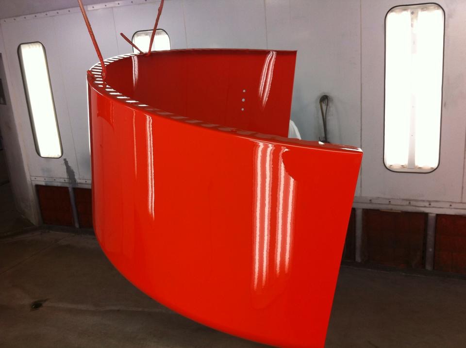

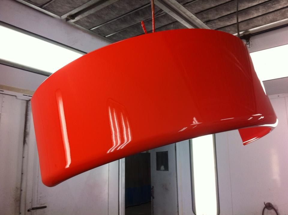

Postby ratrod71 » Sat Apr 09, 2016 3:46 pm
Painted the fenders today. 1969 Camaro "Hugger Orange".

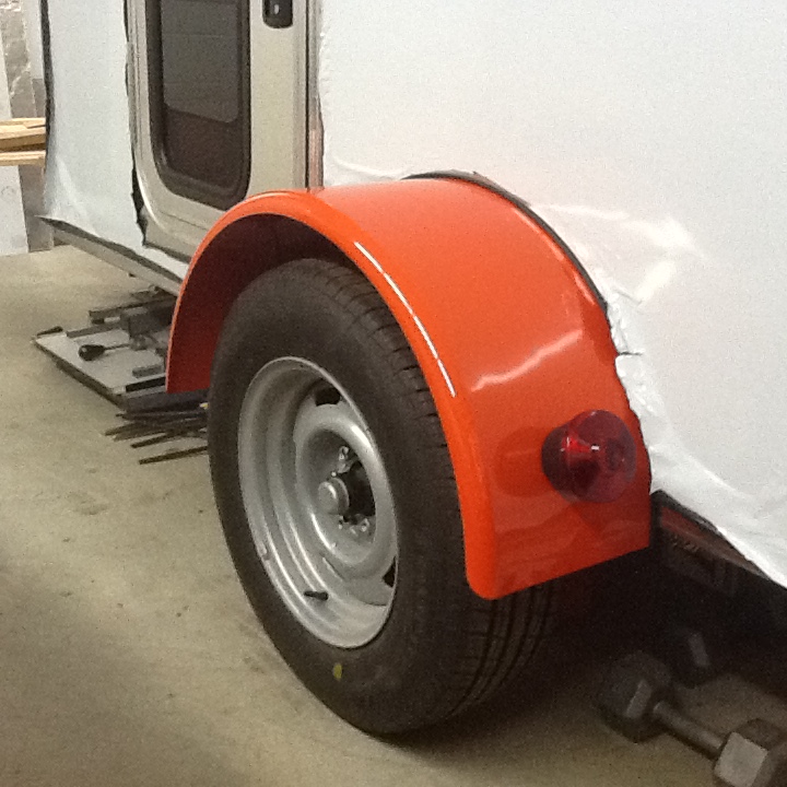

Alaskan Benroy

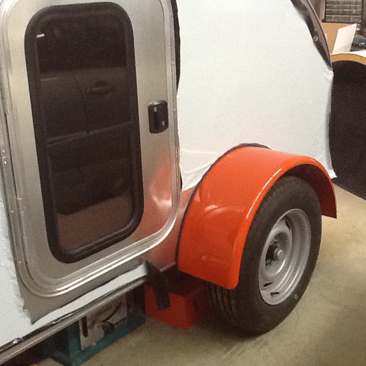

Postby ratrod71 » Sun Apr 10, 2016 7:31 pm
Installed the fenders today. I used automotive style fender welting to seal the seam and give it some contrast between the aluminum and the orange fender.

Re: Alaskan Benroy

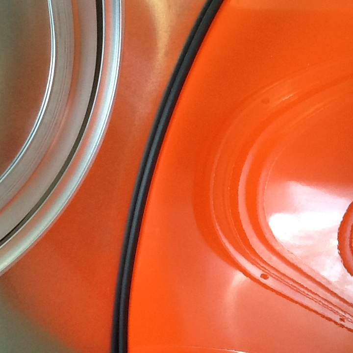

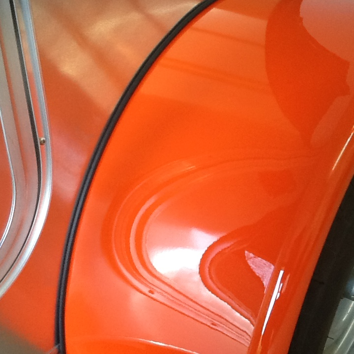

Postby ratrod71 » Mon Apr 11, 2016 8:56 pm
Any chance i can get a closer look at the moulding of where your gaurds meet the body and a brand ect.
Love your work bryan
Here is the picture of the fender welting between the body and fender. I think it gives a nice finished look. Bryan

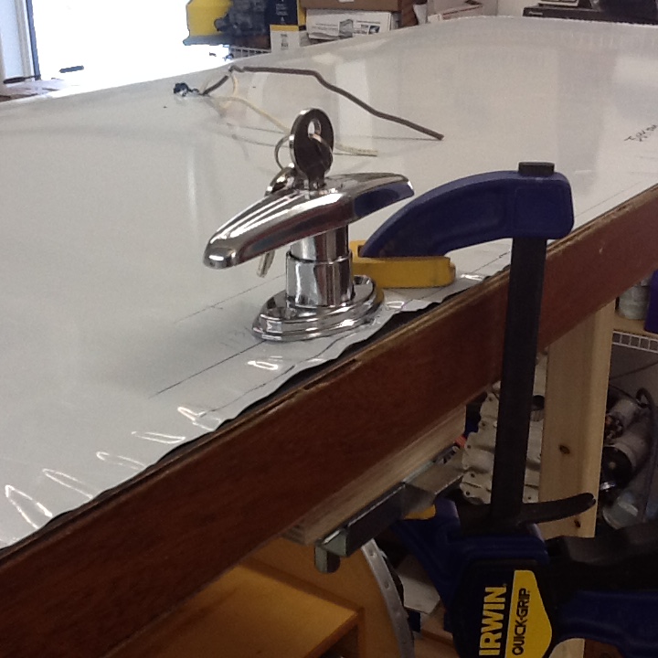

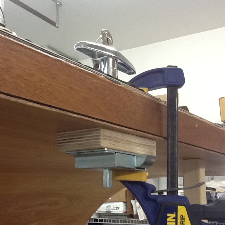

Alaskan Benroy

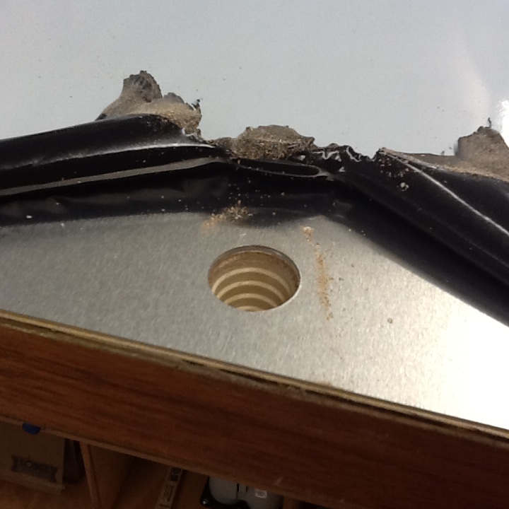

Postby ratrod71 » Sat Apr 16, 2016 6:13 pm
Working on the hatch latches today. Useful tips! 1. I drilled a perfectly straight hole through a small block of 2x4. I then clamped the 2X4 to the hatch and used that as my pilot to drill a straight hole through the hatch. 2. I used a step drill to open up the hole where the t-handle screws to the outside. The t-handle has a step in the mounting surface that requires the hole to be enlarged. Happy building, Bryan
Alaskan Benroy build journal: viewtopic.php?f=50&t=61738
