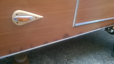

Now the bad news. The trailer has been sitting outside the past couple of weeks and we have been getting some rain. The water seems to be getting in under the aluminum trim and up into the walls. Not sure if it is impending doom or a big issue coming down the line. I used silicone caulk when I attached the trim to the walls but either not enough or it didn't work. I was going to pull the trim and epoxy the wall edges but now that I think about it, I used adhesive caulk and will probably damage the trim. Same problem on the tongue box.
Water is getting in around the seams

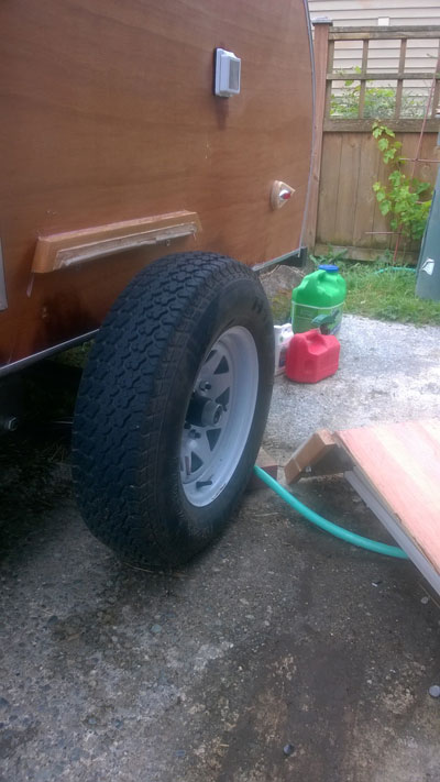

I also misjudged how much spring travel there would be on the axle leafs. Went over a bump on one of Seattle's side streets and busted the fender right off. I noticed it when I got home from registration I immediately redrove my steps and luckily found it. I am glueing it back together now and will reattach higher up.
Ugh
You can see where the tire hit.
