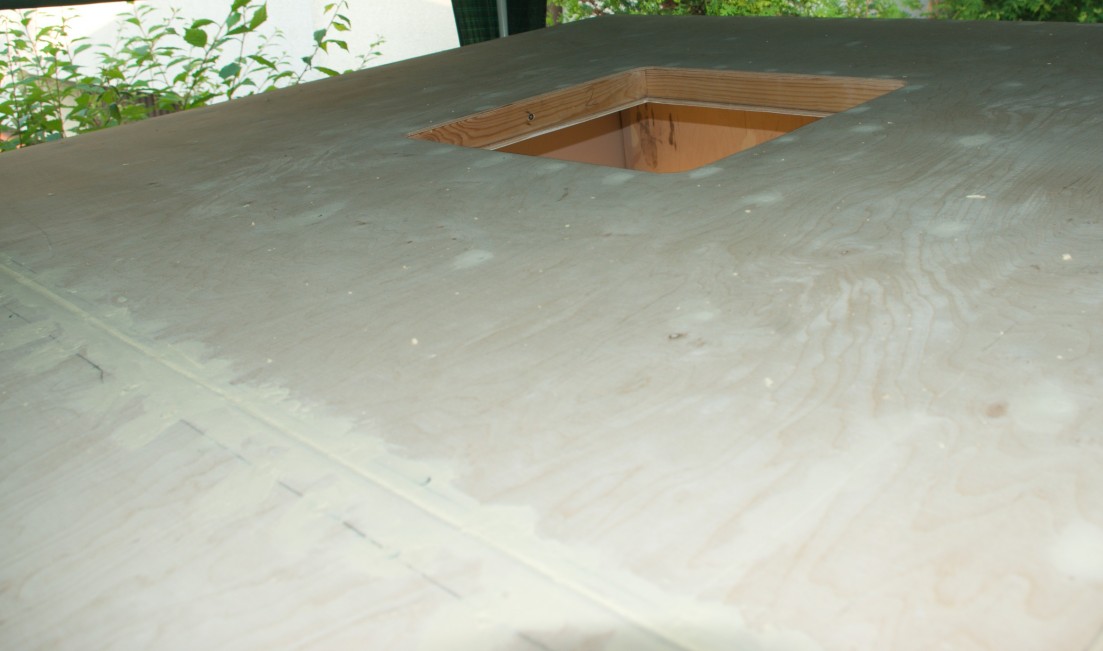

I returned lasure to the shop and visited another shop with laminates. The crew recommended me using epoxy resin as well as a fibreglass cloth. But, they only have a heavy (thick) cloth (300 grams per a square metre).
Can I use only one layer of a fibreglass cloth, supposing it is strong?
Should I laminate the whole thing or just a roof and front and rear walls? Side walls are still covered with paint (which is very difficult to remove) and looks like nothing bad happened to it during the rain a week ago. What do you think?
Today I installed the last part of the roof. Filled all gaps- tomorrow, after it is sanded I will apply filler last time.
I also built a lower part of the capsule. Used an OSB framed with impregnated wood from my first version. Only sides are new, made from a plywood.

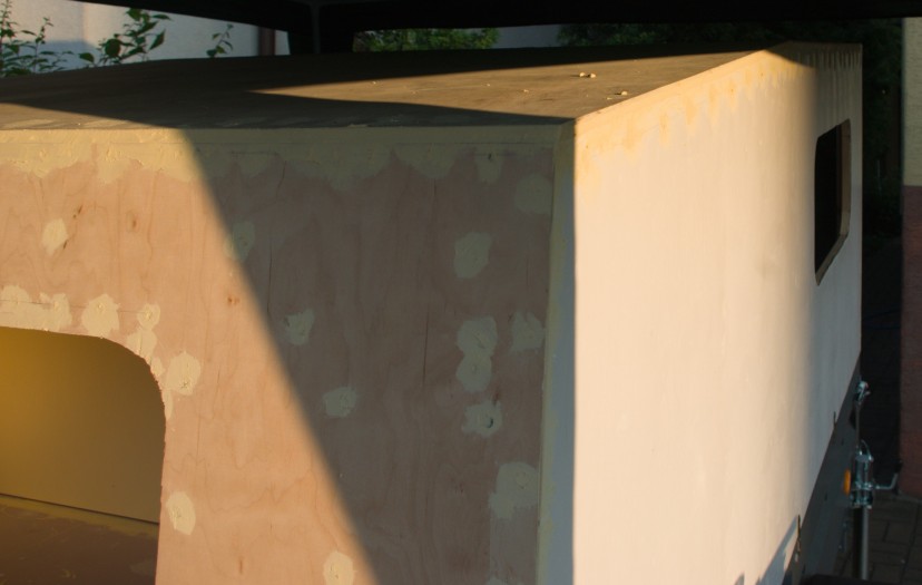

Friends, I am confused about finishing my caravan box. I can start doing it right now but do not know what option to choose.
If I decide to remove paint from side walls in order to laminate them it would take me very long time as the paint is really strong and tough and when I was trimming roof panels to the side walls edges I realized it is nearly impossible to clean walls from paint. Paint seems to be waterproof as small painted pieces I left on rain are still ok.
If I laminate whole thing without removing paint then laminate can come off from side walls.
If I decide to laminate the roof only I am afraid that place where laminate finishes and painted wall begins will be a point where water can penetrate.
And I do not know how to laminate properly and if I do something wrong there is no undo option.
If i decide not to laminate but paint the whole thing I am not sure what to do. My idea is as following:
First, I think I could use the same paint as on side walls- apply at least 3 layers on the roof plus one more layer on side walls.
Then, I would like to paint gray areas as I designed.
Finally, I would like to cover the whole thing with a varnish so to ensure the whole surface is waterproof.
What do you think about non- laminate option? Is acrylic paint + a varnish a good solution? What kind of a varnish should I apply on an acrylic paint?
