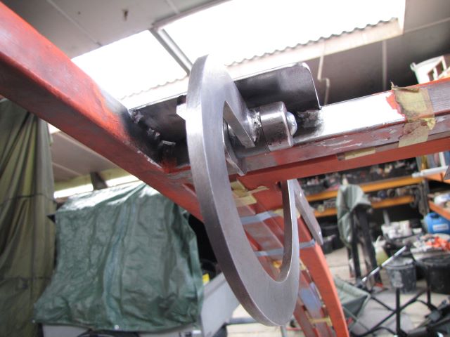

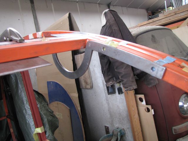

Postby smeerkees » Wed Oct 25, 2023 4:41 pm
I think this is more like it.

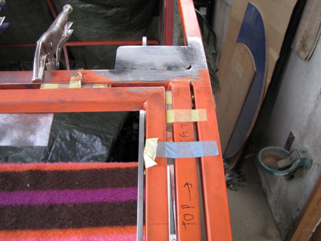

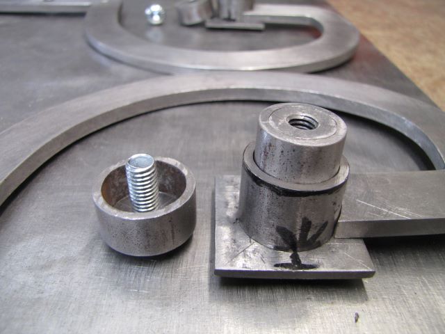

Postby smeerkees » Wed Oct 25, 2023 4:44 pm
Yeah, definatly.

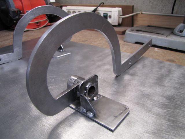

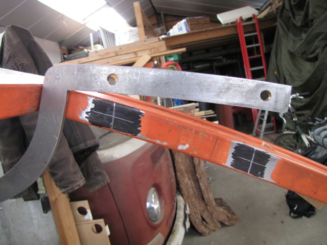

Postby smeerkees » Wed Oct 25, 2023 4:50 pm
So at last some real progress.
Something what looks like real hinges...

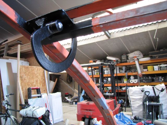

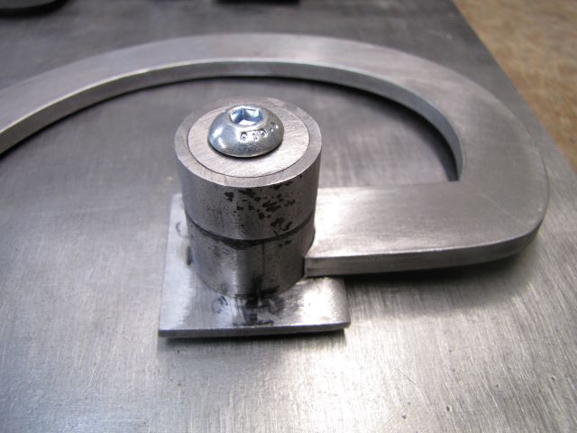

Postby smeerkees » Wed Oct 25, 2023 4:53 pm
From another angle...

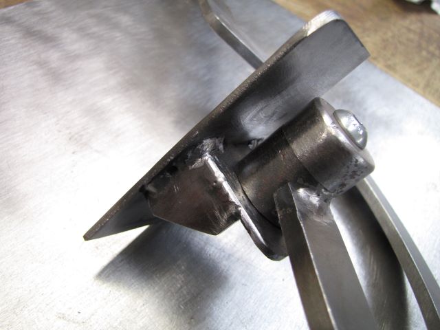

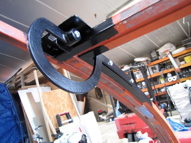

Postby smeerkees » Wed Oct 25, 2023 4:58 pm
Then at last the complete sum of parts...
Something like this.

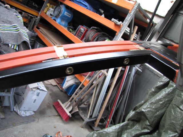

Postby smeerkees » Wed Oct 25, 2023 5:16 pm
the underside also some weld props.
Welding only on the topside is to thin in my eyes, and may couse taering over a long time
caused by loadpeaks while driving and bouncing the teardroptrailer behind your vehicle.
IMG_2716 resized for tnttt 19.jpg (47.05 KiB) Viewed 2335 times

Postby smeerkees » Wed Oct 25, 2023 5:40 pm
The side of the hatch will be mounted with nutserts.
In part that i dont want to weld on to the pre bend hatchsides.
By bending those square tubes there is a lot of tension in the material.
By welding on them they will lose some of there pre bend form.
And those bends being part of an elipse it is very difficult to bend them the same way twice.
(You have to bend all the square tubes symultainusly inch by inch on your rolbender.)
Also you want to have a way to (re) position the hatch a little bit.
Using bolts this way it is possible.
It is pretty precise.
I even have acounted the collarthickness of the nutserts in the measuremants.

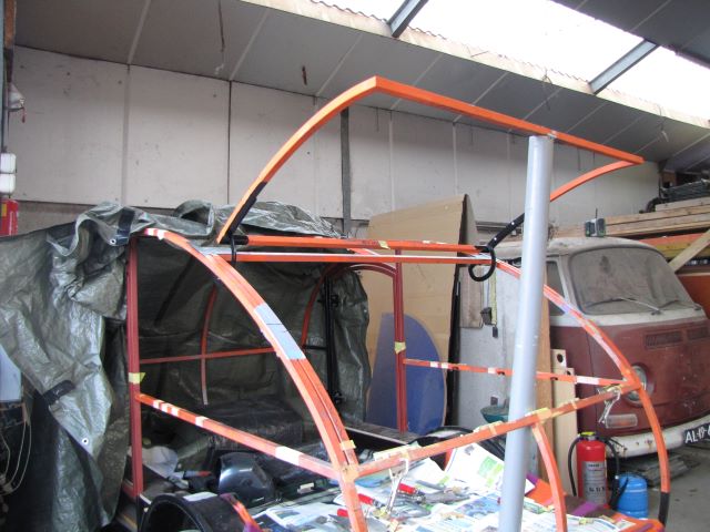

Postby smeerkees » Wed Oct 25, 2023 6:02 pm
Well this is about where i am at the moment.
Next is placing the nutserts,
place the middle rib of the hatch,
and only then can i see if i can mount the middle hinge.
The aligning of 3 hinges must be very precise.
If not the hatch will only open with difficulty, if at all.
The reason i want 3 hinges is simple: when you unbold one (the left side) the hatch will still be in place on the remaining 2 hinges.
Then you can easily slide the complete hatch to the left and voila you dismounted the hatch.
Hope to update you a little faster next time.
Greetz, Kees
