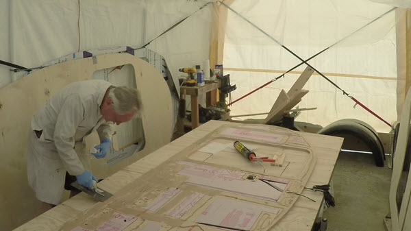

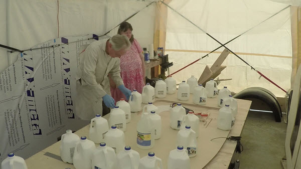

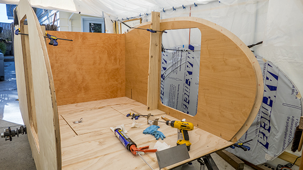

I now have the outer plywood glued to the cores. I used PL and troweled it on with a notched trowel. Then I walked all over the wall and then loaded it with milk cartons filled with water. I do believe it's well bonded :thumbsup:

I did have one very unusual situation. I ran out of glue just before I finished applying it so I cut the tip off a new tube and then tried to put it into the gun. It would not go in! It was too long and would not fit.
I worked on it for about ten minutes while the rest of the glue was setting up and I was running out of working time. I finally pounded it into the gun and finished the glue up but I've never run into a situation like that before and at such a critical point :x

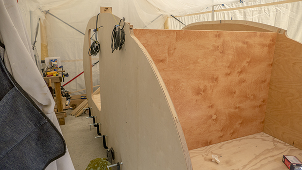

I got the walls stained and installed including the galley wall.
Walls up as viewed from the front.

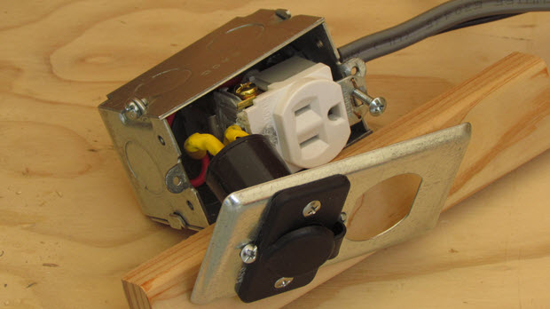

I've started on the galley cabinets and the first thing is installing the 12v/120v power plug, and sizing and installing the slide out tray for the refrigerator/cooler.
I made a custom power outlet by cutting a 120v plug in half making room for a 12v outlet. It's a areal squeeze but it works.

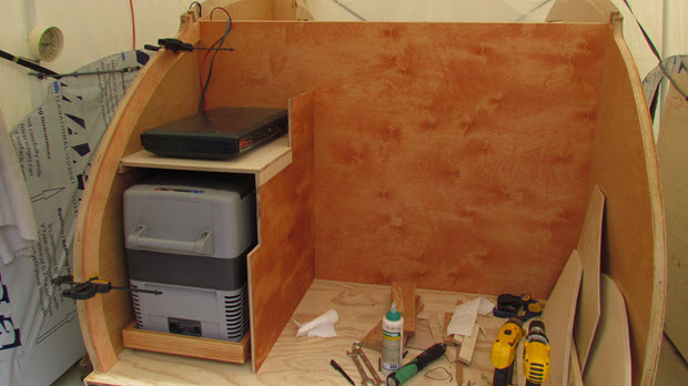

And here's the installation of the refrigerator/cooler.
refer wall.jpg (48.53 KiB) Viewed 3651 times
The try is on 110 percent slides so it comes all the way out. The cooling vents are in the front and I hop that's enough space for it to "breath" OK.

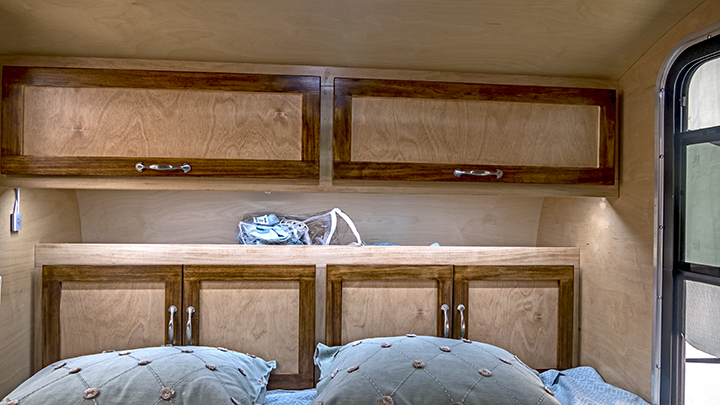

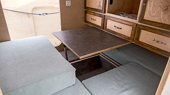

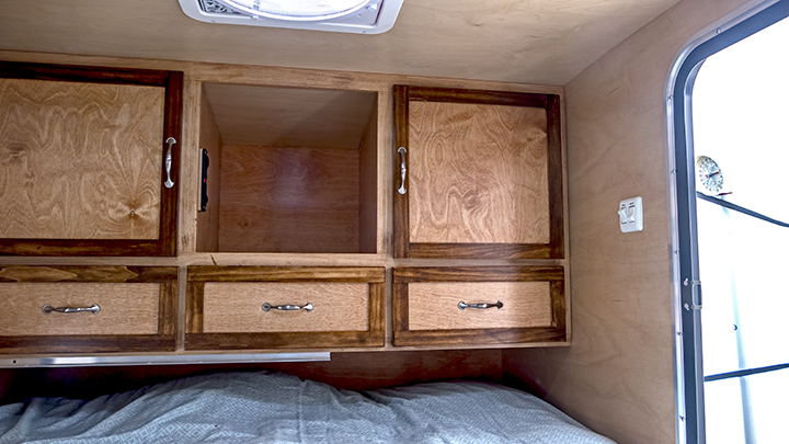

Here is the interior, front, back and with the desk up.
