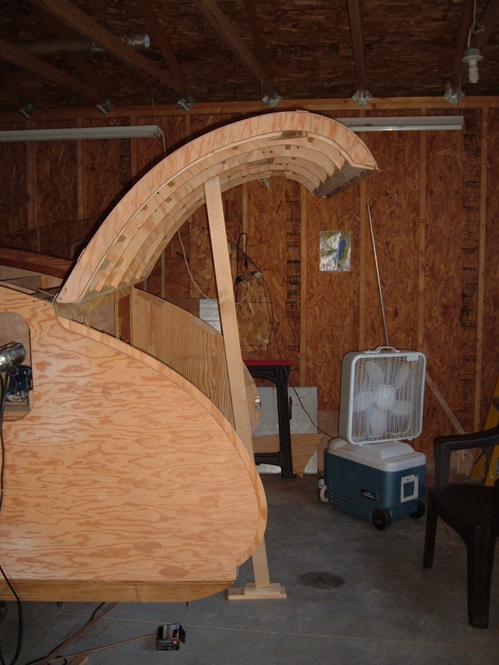

Yes I will be moving toward dry fitting the hatch hinge. I want to get the hatch operational and start the gas lift support install. So I want to get a hatch weight, and see how high I'll have to lift it, for headroom under the low point. Then get my parts ordered and on the way.
One little interesting gaff with the hatch skinning. In my haste to skin the hatch I forgot one little thing. I forgot to remove or disable the hatch locking spring bolts. Once the hatch was skinned, I had no way to unlock the hatch from the outside. So I've managed to lock myself out of the hatch for the first time already. :oops:
Not a real big deal. I don't have the lower galley cabinet installed. So I can shimmy my way back to the latches, to release them from the inside.

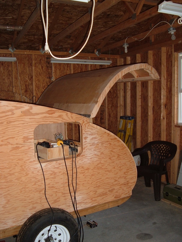

You cracked me up with the "don't know if I was more comfortable" comment with the fan. I did use the word comfort in my post about the fans didn't I. Bearable might have been a more accurate word I think? Hey, it's summer and it's the only time we guys with no heat in the shop can work. I would much rather sweat and deal with mosquito's (got a ton of em here too) than freeze.
Got the shop down to "bearable" temps with the fans after work. Crawled into the galley area from inside the camper and clamped open the hatch lock bolts. Tossed a few screws into the hinge. Then freed the hatch from the side walls.
PRESTO....an operational hatch!! HIP HIP HOORAY!!! :beer:
First thing I did with the hatch open, was to take the locking spring bolts off!
I've got the hatch propped up to provide about 6' 4" of headroom at the low point. Going to start figuring the gas struts from there and order the parts.
It opens and closes great. It shuts with a nice solid WHUMP when you close it. Like a nice solid car door sounds.

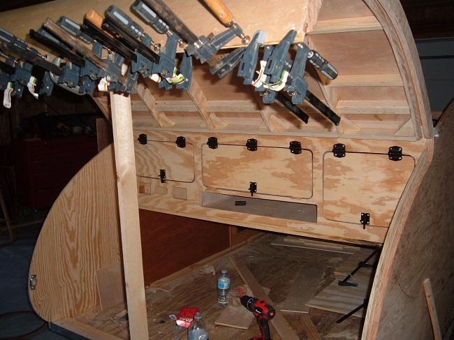

Got started on the camper about 12:30 and kept at till 5:30. Got slowed down by detail work, and "design as you go" issues. Still got a good amount done. Spent a lot of the time cleaning up the lower rail of the hatch. When I skinned the hatch I really laid on the PL adhesive and staples on that lower rail. It's where the skin was really trying to pull away from the bending force. So there was a lot of oozed out dried adhesive and some misguided staples too. They were either on or in the way of the surface that my weatherstrip has to glue to. I also wanted to stiffen the lower edge of the skin. I was unsure if I was going to do that on the hatch surface, or if I could hide it on the back side but still stay clear of my weather strip channel. Once I had the area clear of stray adhesive and staples I figured a way to get the stiffener hid on the inside. So I got it glued and clamped along the whole bottom edge. I'm happy with how it worked.
Then I decided to try out the galley cabinet doors and their hardware. So I dry fit the hardware on the doors. Then hung the doors in their openings. I knew the doors were not final fit. Now I know just by how much. It's going to take another long session of getting personal with each one of them and the belt sander. So I'll scribe them to their openings now that their hung, take them off, and have at them with the sander again. Not one of my favorite jobs. Plus I'm going to need to bevel the hatch rail that is right above the hinges. It hits the hinges just enough when you try to close the hatch. I'll have to get at that rail with a 45 degree bevel bit in my router to clear that up.
I'm also going to have to add stiffeners to the back side of the doors. These are the doors that wanted to curl up. I've had them stacked flat with a heavy tool box on top of them for weeks. They are a whole lot flatter now, but still need the help of the stiffeners. So some more details to fuss with.
I wanted the galley to look like the bare bones early teardrops. I was shooting for that 1940's ididit myself from some Popular Mechanix magazine plans look.
So I used the big grain fir plywood and today's low buck hardware. The hinges are plastic marine hinges with stainless barrels. Very strong, and work real well for as low buck as they are. The slide bolts serve as travel locks and knobs for the doors.

I did get a chance to take my entire clamp hoard off the hatch. The stiffener worked nice. EXCEPT...it drags a bit at the very bottom of the floor when closing. There would be no room to canvas cover the area for my PMF exterior skin. It would end up rubbing and wearing it's way through the canvas and let water into the plywood.
I just finished up the house repairs. Going to head out there now and try and plan tomorrow's approach to solve this. I'm 90% certain I can trim the hatch lip and get the clearance I need for the canvas, and eliminate the rub potential. However it's also one more detail to deal with and slow things down.
