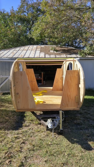

Check it out: it's perpendicular! (ish)
Here's the front. The bottom half of the nose will be a storage area. The top half will be an open shelf. (Ignore the dividers--they're just temporary braces for the dry fit. They do show will the bulkheads will be, though.)

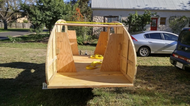

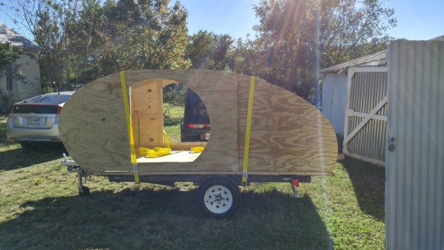

Here's a 3-quarter view.

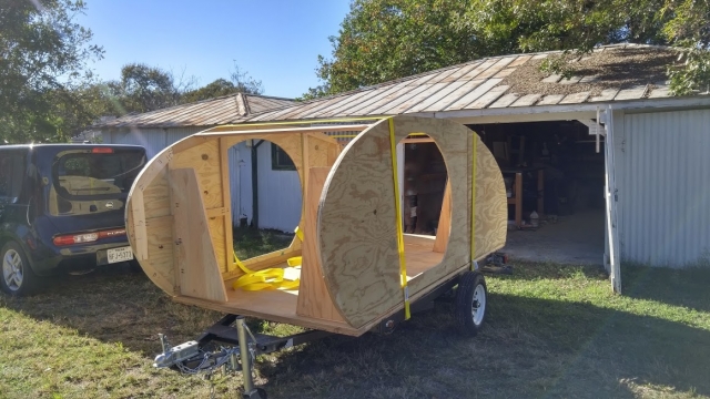

And, lastly, the galley.
Mr P & I loafed inside for a while, which was happily a little more spacious than expected, and mulled over various wiring issues. The weather was cool, the sun was warm, and everything was all right.
So far, the only thing change I think the setup needs is to have a little space dug out in the underside of my walls to accommodate the boltheads that hold the floor onto the trailer--the walls won't sit perfectly flat because the bolt heads stick up too much.

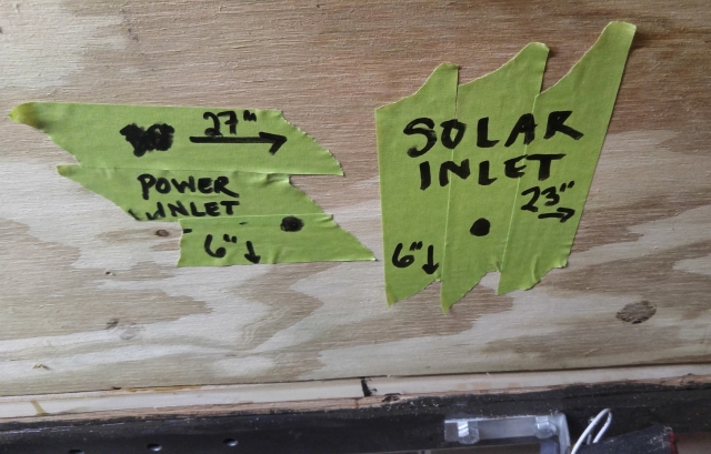

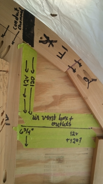

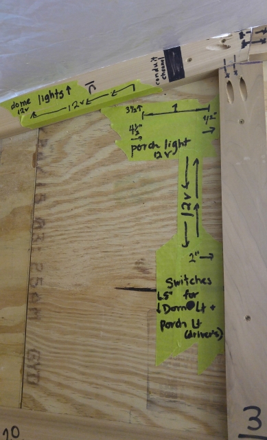

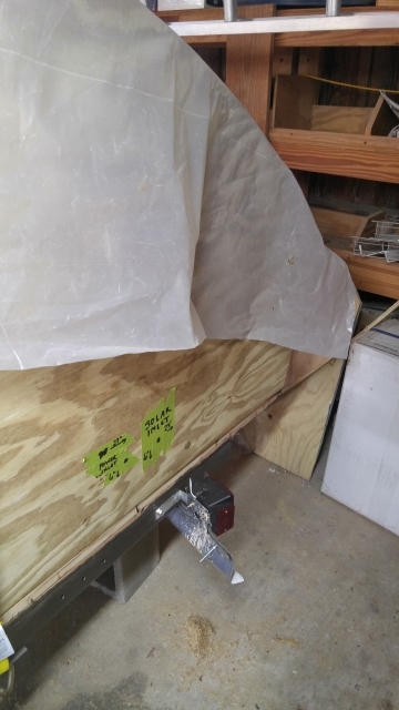

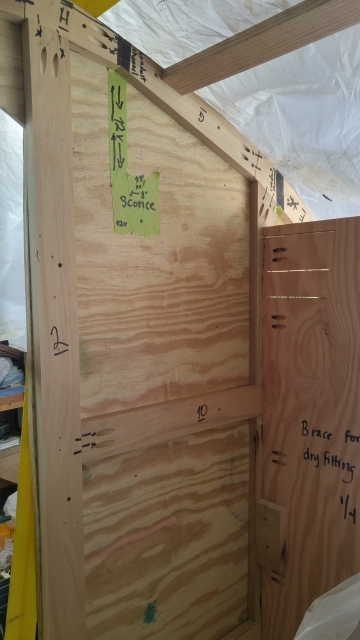

After a rather long lag, I'm back on the case. Last weekend, I mocked up where all the light fixtures, outlets, and wires will go (other than the ones in the roof, since we haven't got a roof yet.)
This weekend, I installed the stabilizer jacks on the back corners and estimated window size and location. I also tried to install some bolts from the middle of the floor (if memory serves, I was able to install the perimeter bolts, but not the middle ones because there is a slight gap between the floor and the central crosspieces, and my bolts were too short for this extra bit of length.)
Owing to tedious problems with the size of the pronged washers I had on hand, further bolt installation will have to wait till next weekend (or the weekend after, due to travel plans). I also ordered a bunch more silicone marine sealant, as having all these holes in my floor makes me very uneasy. I'm planning to inject heaping gobs of the stuff into each hole before inserting the bolts, so hopefully, that will keep everything nice and hermetic.

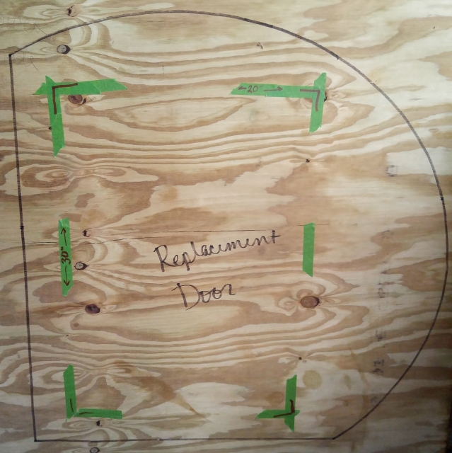

In the interim, I have a question about doors and windows. Commonly available window sizes are ~20x30 and ~14x20. I'm trying to decide which to use in my doors. I'd like the largest size possible, but I want to make sure my doors are strong enough. Here's (roughly) what they would look like with 20x30 windows. What do you think? Is that enough plywood around the glass?
Electrical mockups:
Solar & shore power inlets
Reading light:
Switches for porch light and dome light
A/C vent + 12v outlet and possible 120 outlet
