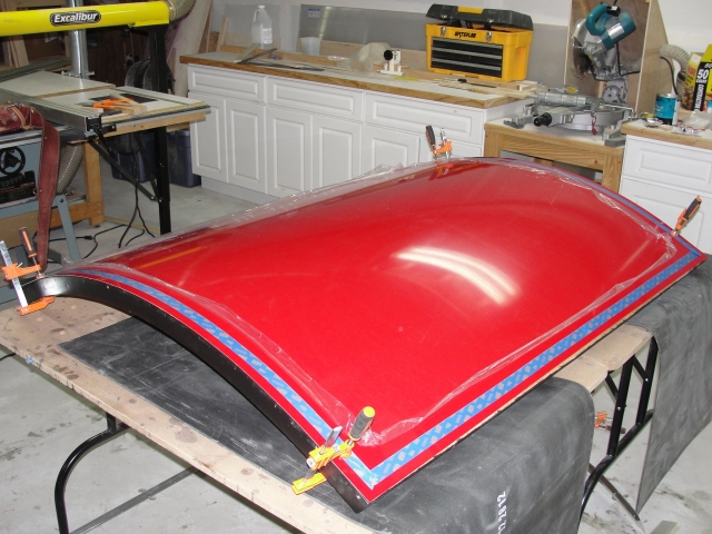

I skinned and trimmed the galley lid yesterday. I discovered that my inner plywood skin has a slight raised area in the middle. I was foolish and used the coiled wire protector in the insulation and it must have jumped out of the channel during assembly. It's only slight and nobody will likely notice.

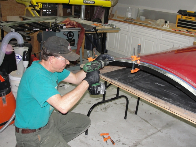

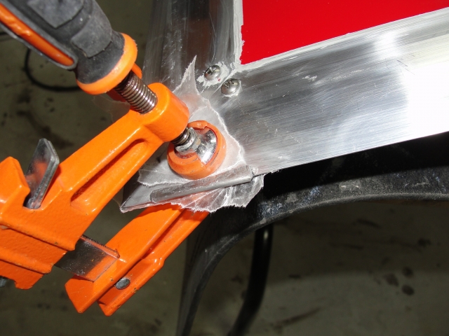

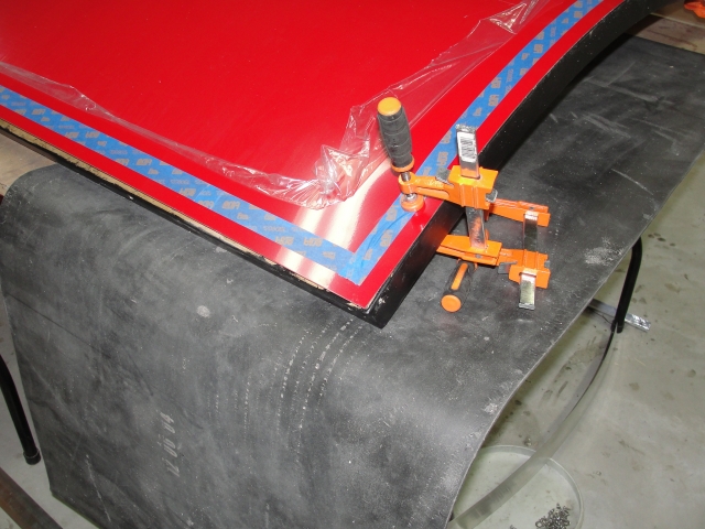

I fit the trim ahead of time and taped in hopes of a clean caulk line.
I used clamps to hold the aluminum in place while screwing down the trim.
Screwing on some trim.

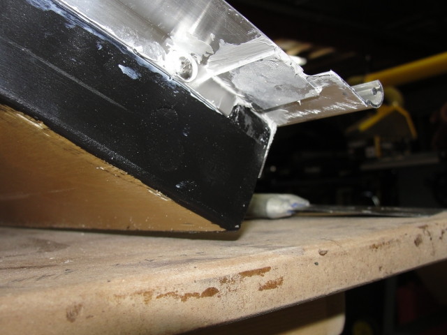

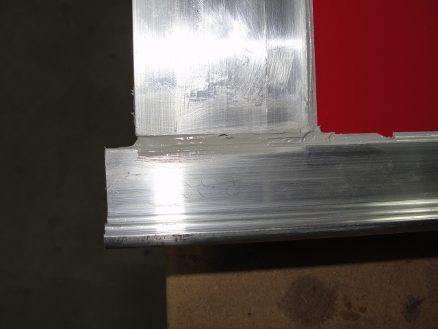

I botched one side of the trim while fitting and it came in about 3/16" short. I glued in a thin plate underneath and caulked it.
View of patch from underneath.

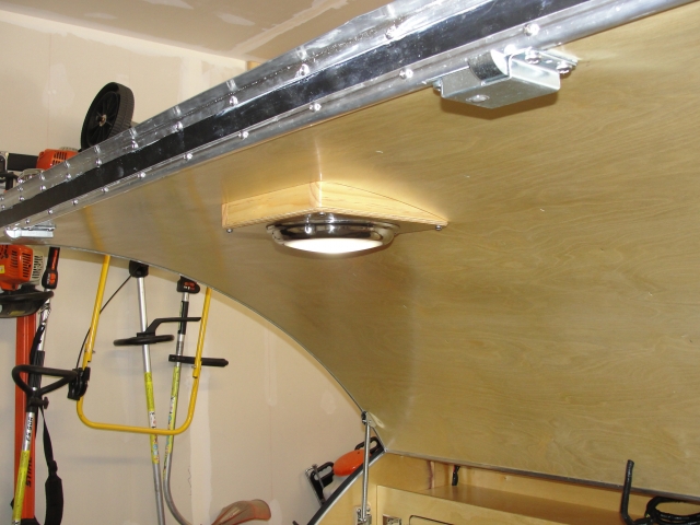

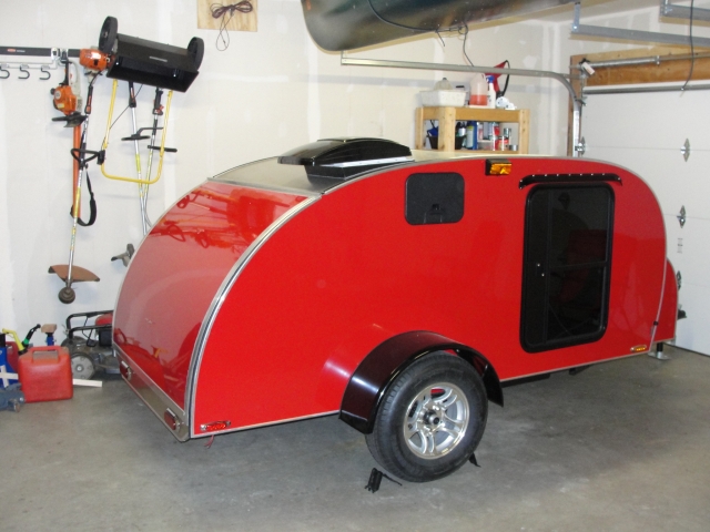

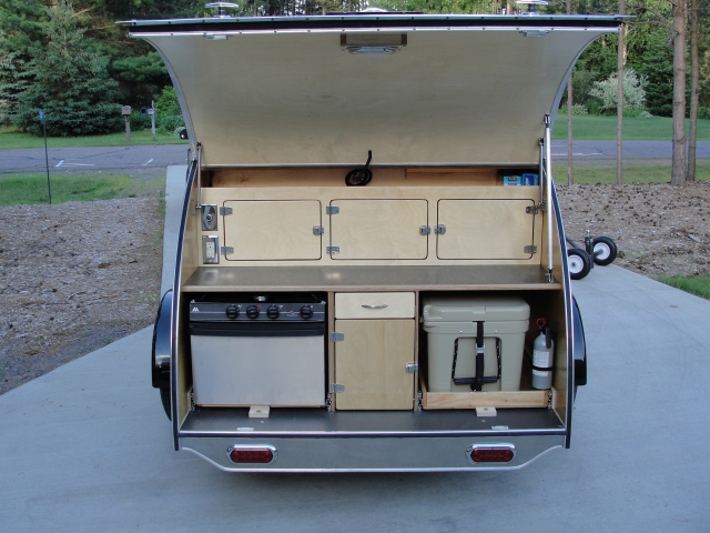

I installed the inside trim on the galley lid today and then put the lid on the camper.
Slam latches aren't installed yet and I'm hoping they'll tighten the lid up a bit on the bottom half of the curve.
Slightly closer view. The lid weighs 44.6 pounds with aluminum and trim installed.
Needs a little solvent clean-up, but looking pretty good to me.
I set the spring supports so they were below maximum hinge travel a little bit. My head clears with some room to spare.
I used spring supports from Oregon Trailer. The base is oriented vertically to allow the spring to stow neatly aft when the lid is closed.
Mary fits in the cooler and stove compartment with the lid closed, so she'll be the one determining the fit of the slam latches tomorrow! :lol:

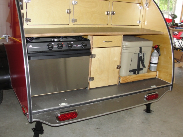

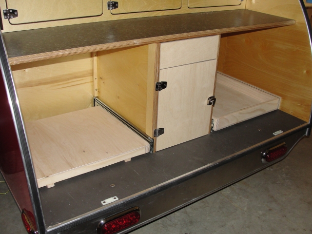

I'm continuing to plug away at the finishing details on the build, particularly in the galley.

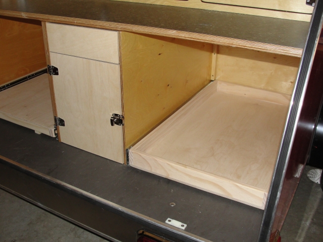

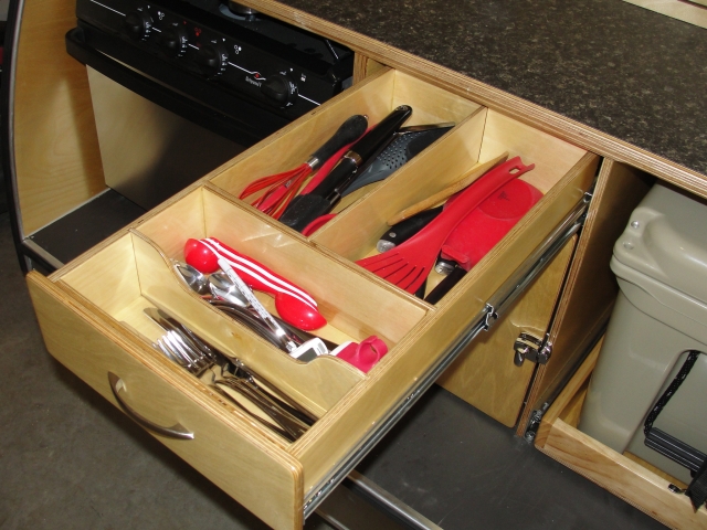

The door and drawer front need sanding yet. The drawer front also needs a handle, but this is a photo during the fitting process. The Yeti 65 cooler will sit in the tray on the right.
The oven rests on the platform to the left.

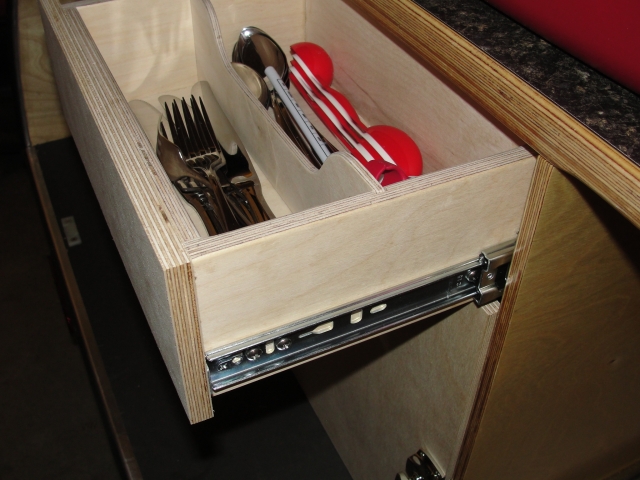

The drawer is customized to our utensils. I still need to build a simple knife block in the back right compartment.
I have a Leigh dovetail jig, but opted to experiment with plywood and pocket hole joinery on the drawer. I'm happy with the results. I think it was slightly faster as well.

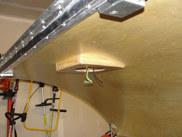

The base for the dome light is angled to help the light shine straight down.

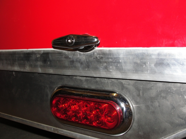

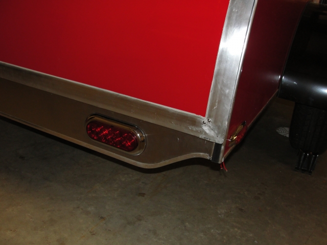

License plate holder/light and slam latches are installed.
I had to router some of the trim to fit the slam latch handle.

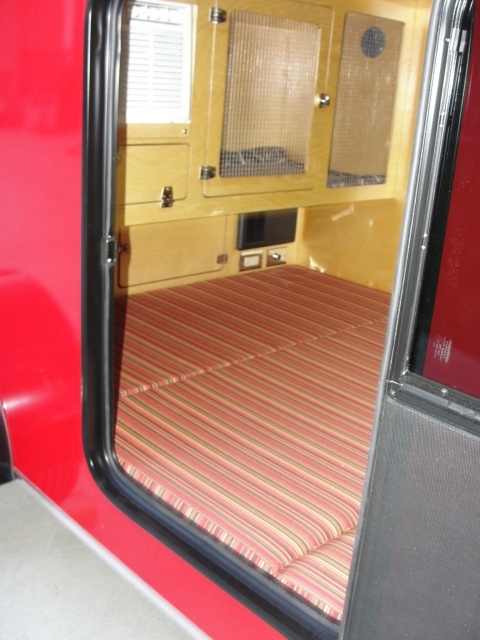

Sewing of Futon Started
Postby Dusty Mark » Sun Jun 26, 2016 10:24 pm

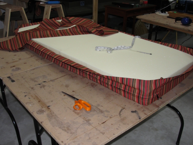

Mary is busy sewing our futon mattress.

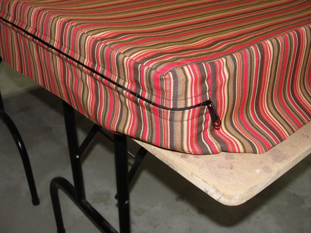

The mattress is 2" of firm foam laminated to 2" of memory foam. The three cushions each measure 56 1/2" by 25". Two of the cushions are joined together and will have plywood bottoms to form the futon couch.
A 5K coil zipper provides a way to install or remove the foam in each cushion.
Mary "nailed" it on matching the stripes and sewing a good tight hinge seam between the two joined cushions.

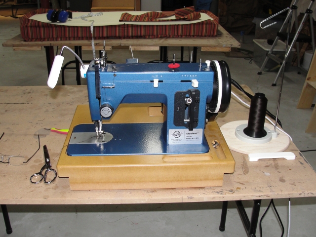

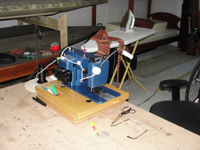

I bought this Sailrite Ultrafeed sewing machine last summer when I was sewing up the blinds for the three duck hunting layout boats I built. I knew it would keep coming in handy!
View of sewing machine from the back.

Thanks, Mary has good attention to detail while sewing. Yes, the machine is perfect for outdoor materials including vinyl. If it can fit under the 3/8" capacity presser foot, it can be sewn. Leather, vinyl, 12 layers of denim...

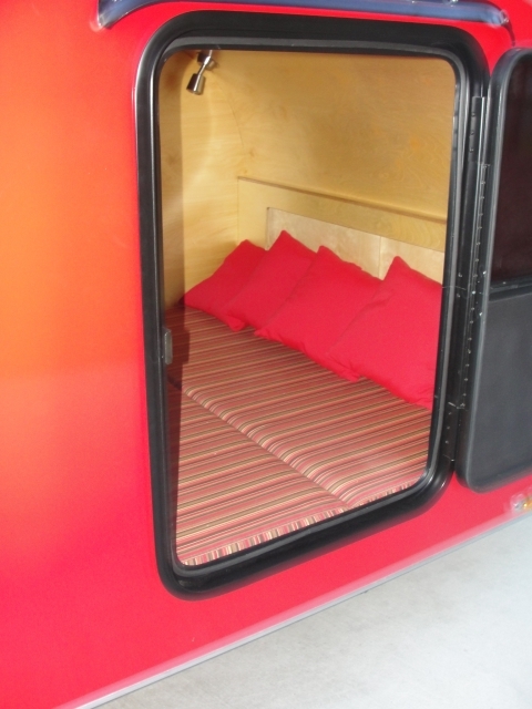

Postby Dusty Mark » Sat Jul 02, 2016 8:21 pm

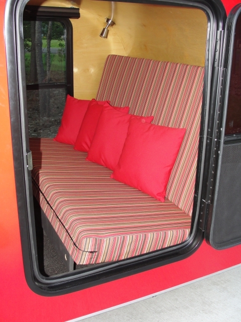

Mary finished sewing our futon and pillows and our design worked well.
In the bed mode.
Each cushion is 56.5" by 25".
In the sofa mode. The two cushions that form the shape of the sofa are stapled to a piece of 1/4" Baltic birch plywood. This helps with providing a firm back rest.
The underfloor storage area provides the vertical clearance we need to sit like a regular couch.
Mary demonstrating the sofa.

Lower Galley Work Complete
Postby Dusty Mark » Sat Jul 02, 2016 8:33 pm

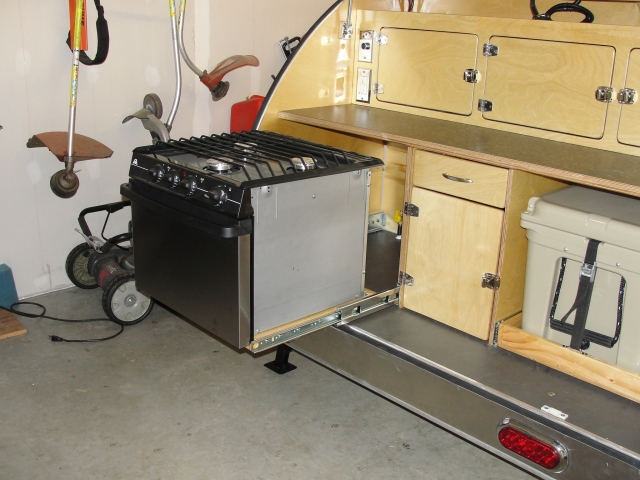

The lower galley is basically complete.

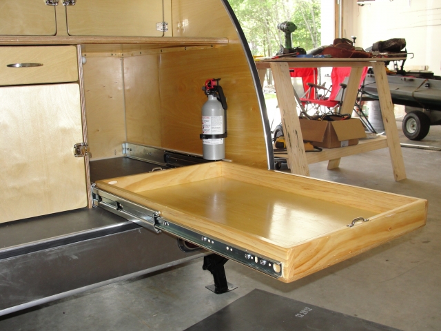

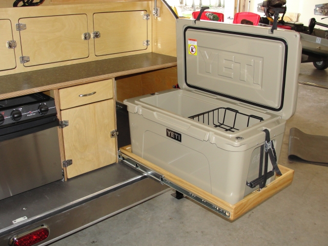

The stops for the cooler and oven are bolted to a threaded insert in the floor. I still need to paint the stops.

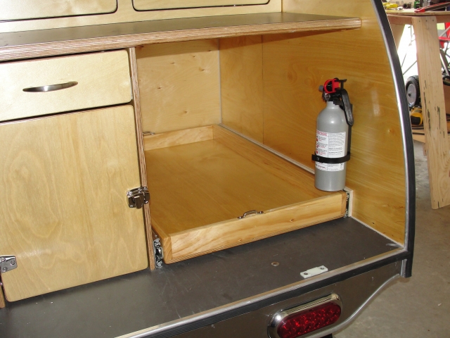

Cooler tray works well. I discovered there was room to mount a fire extinguisher.
500 pound drawer slides are solid.
That's a Yeti 65.
I cut it a little close on vertical clearance for the stove.
The stove is mounted on the same heavy duty slides and fastened at the front and back to the platform.

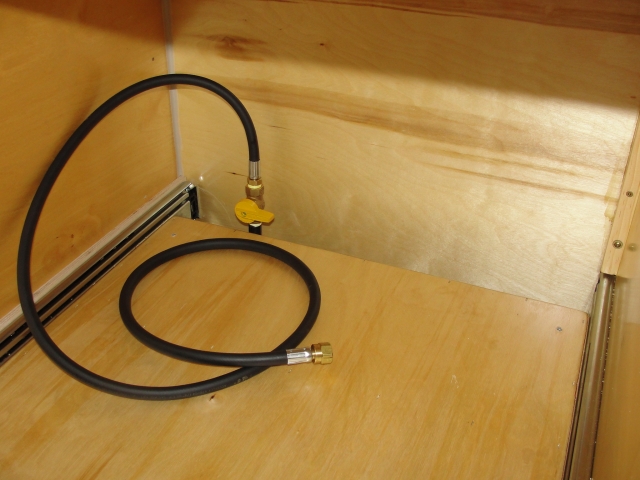

I installed a shut-off valve behind the stove. I also made a simple bracket to hold the pipe solid where it comes into the galley.
The utensil drawer is just the right size.
I really like the white/red dome lights in the cabin and galley.

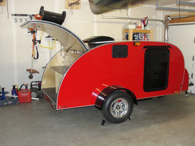

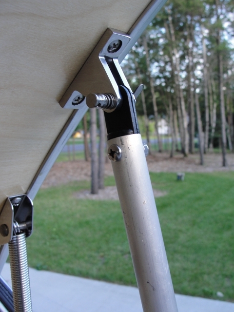

Added Strut to Back Up the Galley Lid Springs

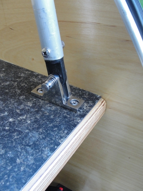

Postby Dusty Mark » Sat Jul 02, 2016 9:00 pm

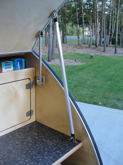

I didn't do a good job of installing the galley lid springs symmetrically and the passenger side spring lets loose a little easier than my safety factor can tolerate. I installed a bimini strut like what's used on boats and it makes it rock solid now. A free-falling lid could cause serious injury to the unsuspecting...
One strut on the passenger side did the trick.
I used similar hardware on the blind system for my duck boat. It's simple, rugged, and fast to use.
I'll add stainless cable to each pin and fasten them to the strut so we don't lose them.
