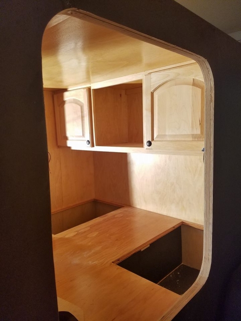

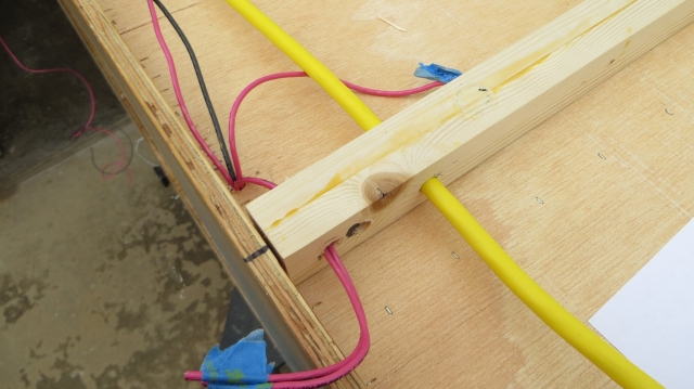

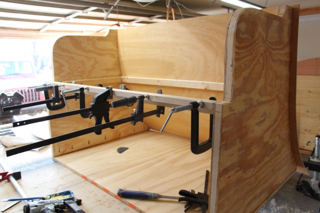

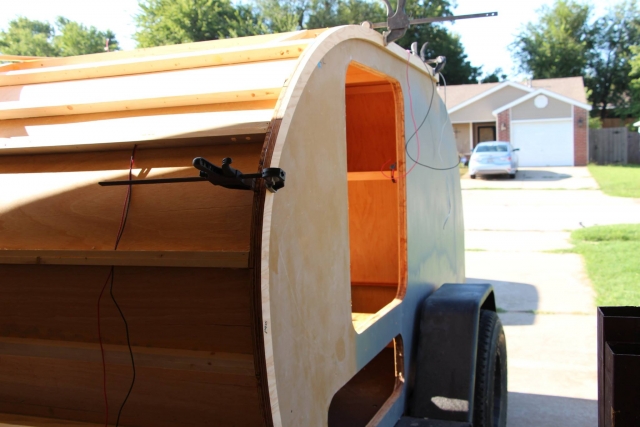

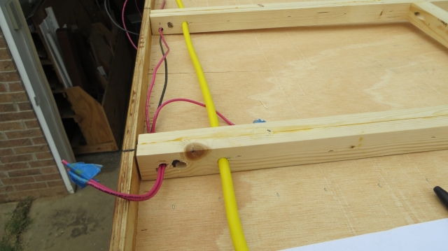

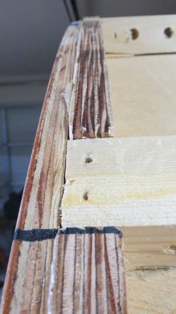

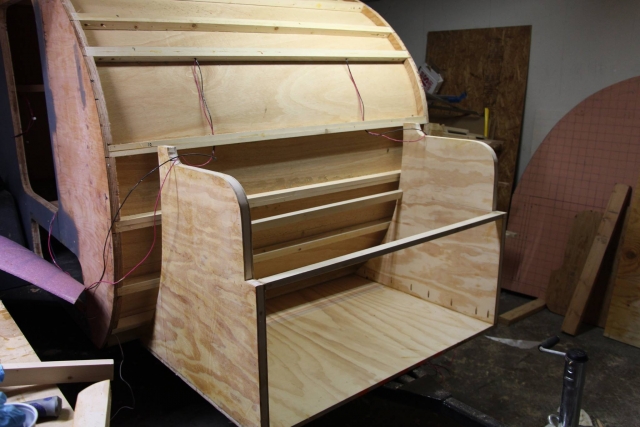

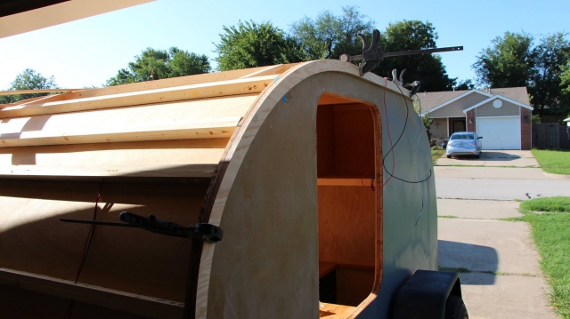

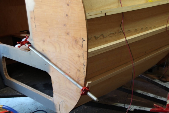

Before I glued and installed my spars. I drilled holes for the wiring and test fit them.
Then I finished with the spars

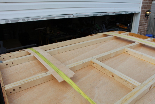

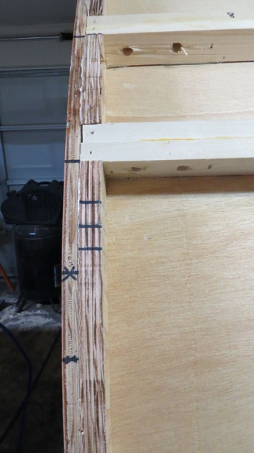

On the first cuts for the supports in between the spars I would go up there, measure, come back down cut the plywood. For the second one I decided to clamp the piece of plywood on the outside of the teardrop then make my marks where to cut. That way there was no measuring and I could take the piece of plywood down and make all my cuts at one time.

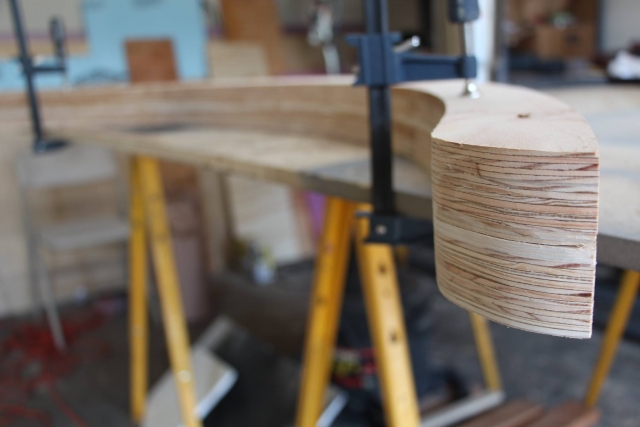

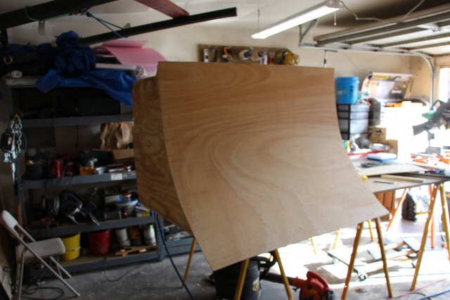

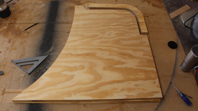

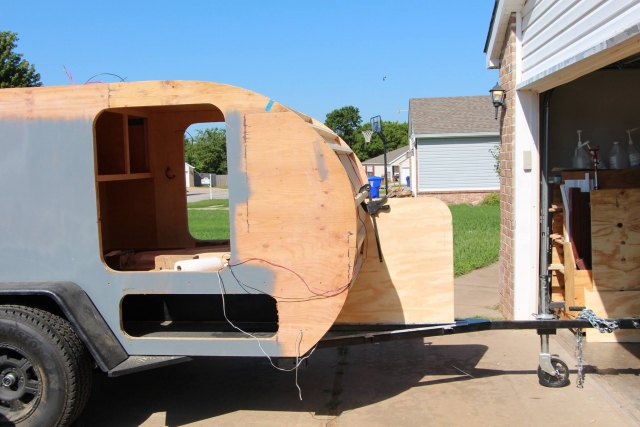

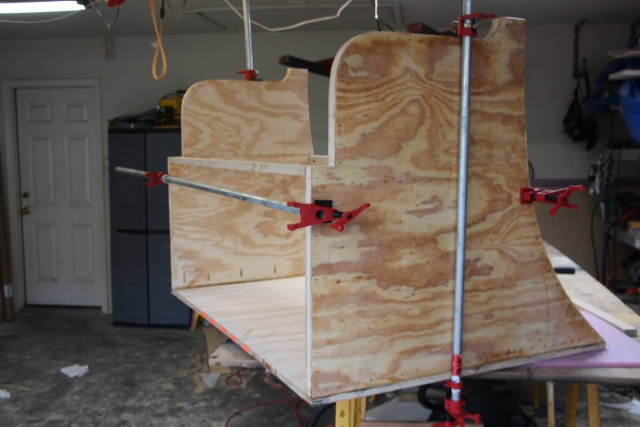

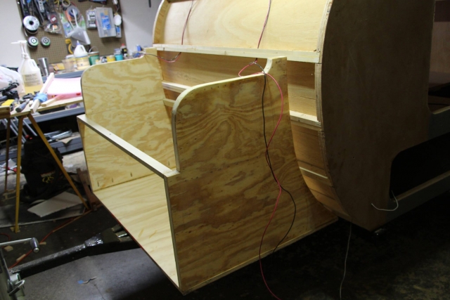

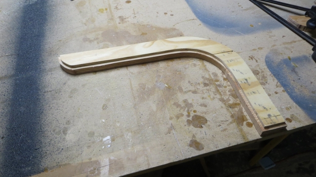

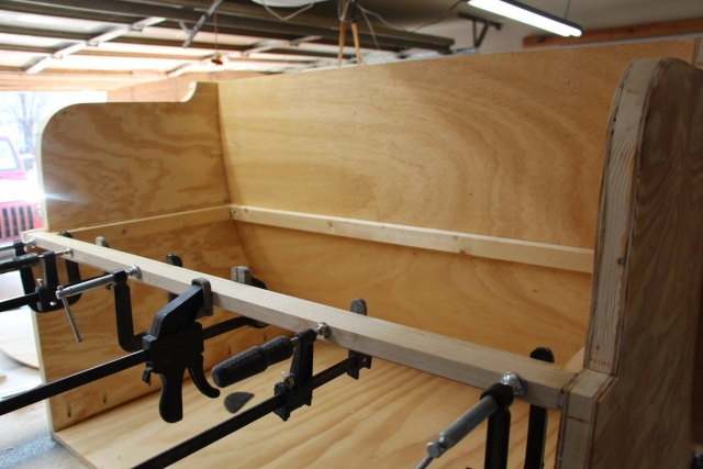

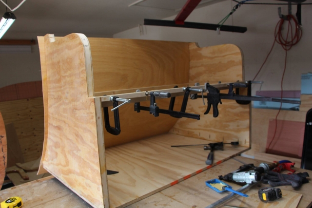

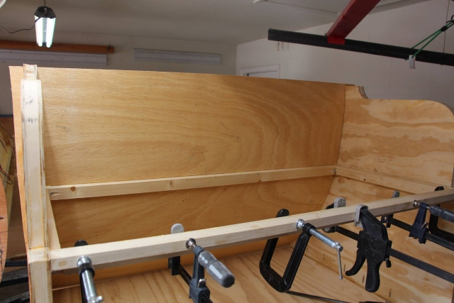

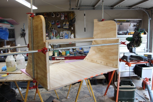

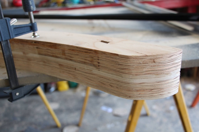

I also started on my tongue box.

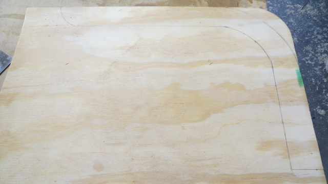

I cut it out and placed it on the teardrop to see what it looked like. I didn't like the radius of it.
I went back with a 5 gallon bucket to make this radius. You can see how much it takes off the previous radius
I cut out the lid

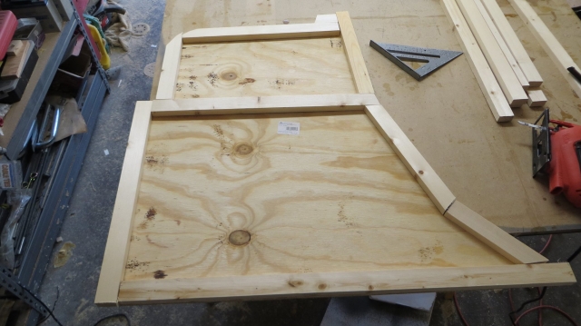

and started building the stick frame for the tongue box

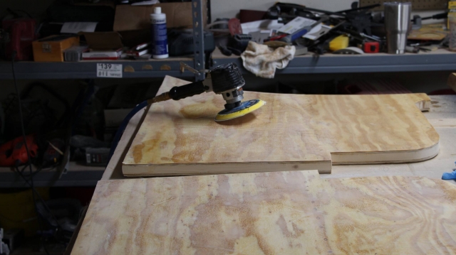

I cleaned up my hatch pieces as well.

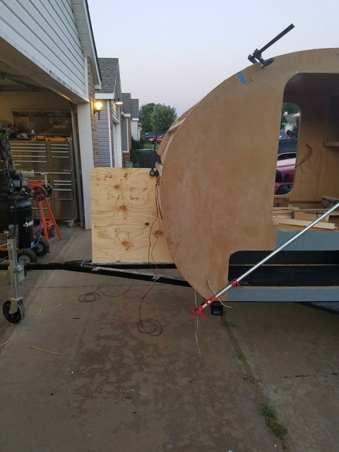

Started building the tongue box. Decided to fiberglass the bottom and sides before I put it together.

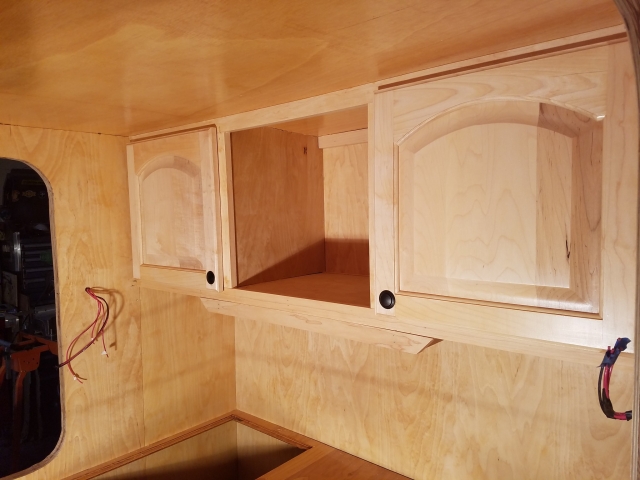

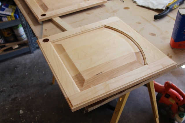

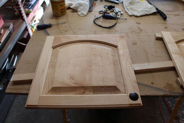

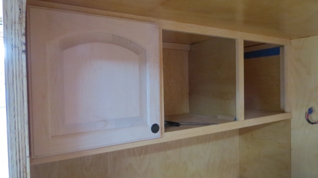

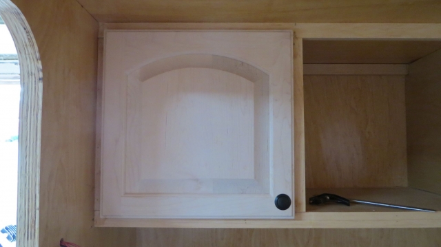

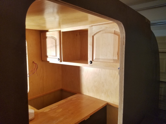

Finally getting started back on the teardrop.

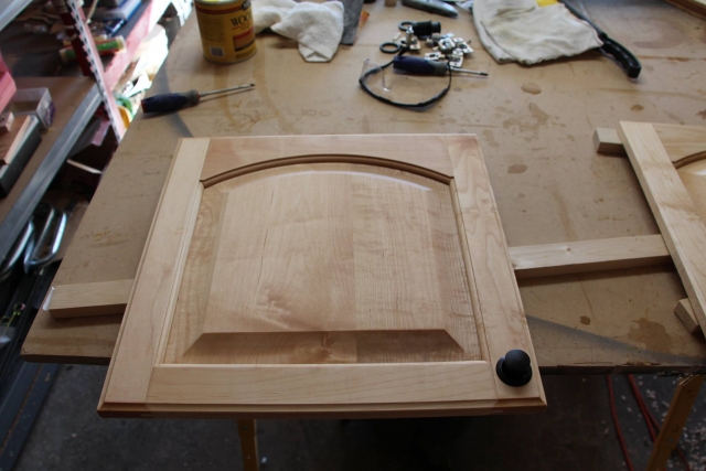

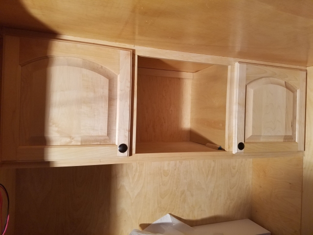

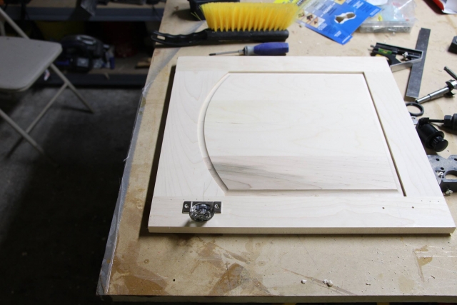

Got the interior cabinet doors hardware completed. Stained the doors but still need to put a finishing coat on them.
I went with push/turn to open knobs
https://www.amazon.com/gp/product/B00GM ... UTF8&psc=1
Soft close hinges
https://www.rokhardware.com/105-degree- ... hinge.html

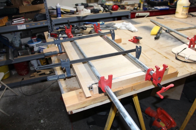

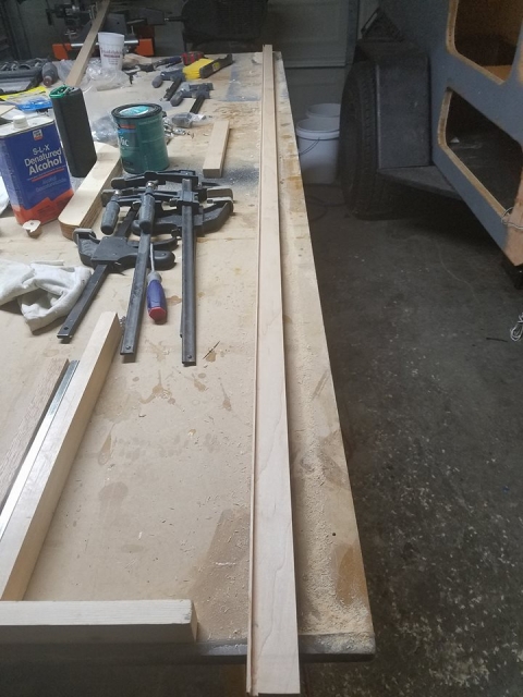

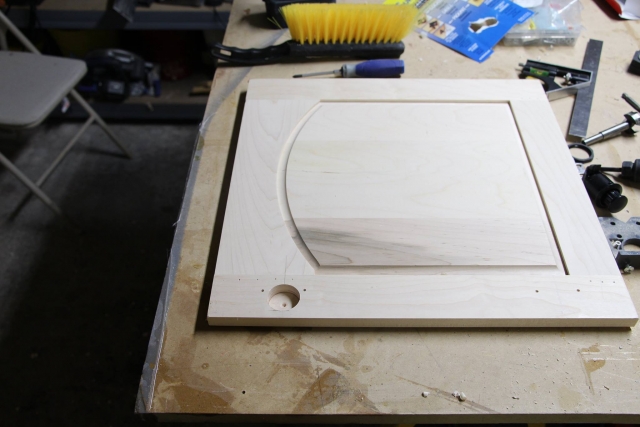

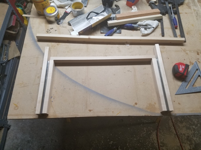

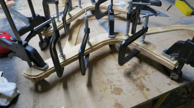

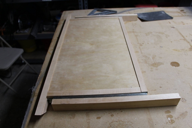

Been working on my interior under cabinet slide drawer. I have seen people use it for a laptop, sit drinks on ect.. I thought that was a good idea.
I took a 1/4 dado bit and ran that down the length of a 8 foot piece of maple style. That gave me a slot to put my birch 1/4 plywood top piece. It took almost the entire 8 foot piece to make the slide so I just cut it all at once so the lines would match up. Still need to stain and install it.
Then I can start back on my tongue box next.

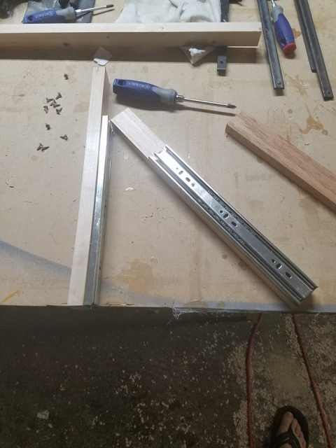

Postby DWT77 » Mon Dec 11, 2017 6:44 pm
I got my slide drawer sanded, stained, and installed.
