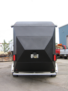

dancam wrote:Do you have another photo of the front of that trailer?

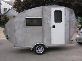

Ok so I attached some photos, I just realized you need to see the window for the effect... its a tinted moon-roof style window, I'm going to tint it even more to match all the windows.

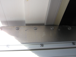

Now that the trailer frame is off I can inspect the setup. Tire wear looks normal and non-existent what with only 650lbs or so on each automotive tire. Trailer tracked straight and stayed straight the whole time. It seems to feel more stable the faster you go all the way up to 75mph (and beyond I'm sure) It handles really, really great, but again, you'd have to tow it to really know :) Haven't re-checked alignment yet, but planning to do it the same way as last time. From eyeball perspective, alignment appears to be the same, drivers side tire appears to be unchanged, it looks like theres a little bit of camber on the passenger side, enough to need a shim on the half axle, but not enough to be of any concern. I will have to take photos and compare them to the fender photos I took before the trip. I'm pretty impressed with the half axles seeing that they were overloaded for 4500km, and typically won't be loaded that heavy. Well that is, unless I get a heavier axle (or half-axles, next size up is 1200lbs), currently not planning to. I think the independent suspension with half axles is a huge benefit for sway control and bumps. Speed wobbles are harder to introduce on independent suspension, as I said this setup has yet to have one and after well over 5000kms now and light tongue weight tests, I doubt it ever will.
Bumps - ok the tongue needs to be boxed in to beef up that front area where the welds cracked on account of all the stress being directed there. Also going to sister the main tongue beam to further increase strength/rigidity. If I did it again I'd go 3" square tube aluminum, but can work with what I've got. Having said that the trailer handles bumps really well, but there was too much flex in the tongue - it is hoped that sistering the main tongue beam and boxing in the front of the tongue will solve this situation.
No under-coating on the bottom, just bare aluminum tube, sheet, and rivets.
Thats all for this long post - here are the pics:

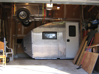

just winch and drag cabin on sliders on crazy carpets to clear the garage
yikes! it cleared but barely.. probably some garages would be too low this ones 81 1/2" as is
aaand there she is on two dollies so its easy to move around to work on (thats a 450lb trailer my Dad bought up top)

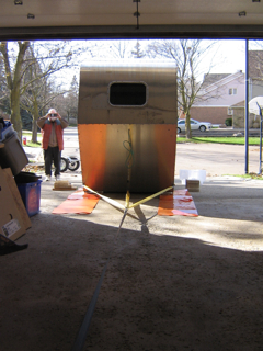

Year 3 begins! 3rd build season, and there is a lot on the wish list. Trailer wintered in the garage, got filled with stuff that I didn't want mice getting into.. all in all it went well. The two dollies used to 'float' the trailer around had sub-par wheels. The front one lasted but the directional wheels are really made for a finished floor, not salt pocked concrete. The rear dolly, two of the wheels failed with little ball bearings all around and whatnot, but still with 2 ppl it was pretty easy to move the cabin around.
4 crazy carpets were laid down in order to slide the cabin out of the residential garage with less drag, as it won't fit through the opening on dollies. Two yellow tow straps were hooked up to my cars trailer hitch using the three eye hooks at the front bottom of the cabin. The driveway is a down-slope, and in neutral the weight of the car was enough to pull it out. Once out of the garage, I backed up the trailer frame, lined up the overhang, and then winched the cabin on sort-of like a boat. Being it was downhill a bit, the winching went well.
No pics today, as the cabin is getting sandblasted as I write and then off to get primed and then line-x'ed on the exterior. Black, b/c it costs too much to pay for a line change-out to silver - what I wanted. Black will be fine, I'm sure. I was worried about the heat absorption, but the guy said that the plastic material doesn't absorb heat as much as one would think. Guess black will be better for colder glamping anyways.
Since I don't really know anything about sandblasting I went to the shop and he showed me an ambulance they were re-painting. I couldn't believe the texture the sandblasting gave to the aluminum! Huuge surface area improvement! No way one could get that with any form of orbital sanding. He said there is a chemical way of prepping aluminum too, but the point with sandblasting is if you overheat the piece, aka 16 gauge .051" aluminum it will warp, and I was shown some examples of the warpage, and that was on .090" aluminum pieces. Well, its at their mercy, surely it will look fine, its all riveted and whatnot. In hindsight I've read about soda blasting, and also maybe if I make another trailer I could use .090" aluminum instead which is almost twice as thick.
So its an exciting and nail biting start to the season! If this plan works as well as I hope it does, this trailer is gonna be waterproof, and then some :D

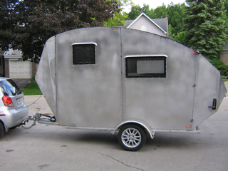

Sooo the sandblasting worked well, I was warned about the possibility of some warpage when the aluminum gets too hot. The person who did the sandblasting did a pretty good job, it was an industrial shop, and my 'piece' was a bit of an exception to what they normally do. If I did it again, I would think about soda blasting, and perhaps finding a specialty shop thats ok with 16 gauge aluminum. Or buy the gear and learn to do it myself.
Having said this, I am happy with the results, a little bit of panel contour here and there doesn't bother this builder much, as he is function over form.
Here are three post blasting pics, also with the shell prepped which means shaving off all the sikka seal squeezeout from around every rivet, led, and seam. Then filling in every rivet head and filling in seam gaps with black polyurethane windshield adhesive. For panel lines, a foaming glass cleaner was immediately sprayed on the polyurethane, and this allows one to smooth it out really well to any contour just using ones fingers.
drivers side sandblasted and prepped
you can see the black polyurethane adhesive to clean up all the lines smooth
passenger side sandblasted and prepped

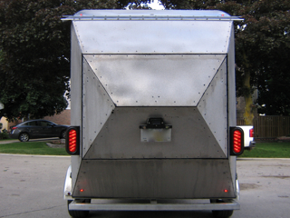

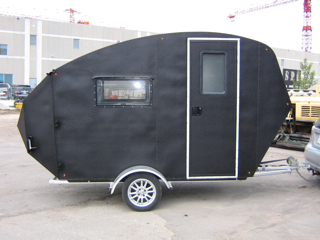

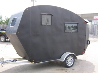

So after the sandblasting session and the prep work, the trailer was dropped off at a local shop for the Line-X premium package which is a three step process - primer, then main coat, then top coat. Shop took only two days to complete the task, I was surprised they called me yesterday, I didn't think it would be done until days end today.
As it is with any paint job, the prep work is key, and I am very glad to have spent almost 20 hours going over the piece to do every bit as best I could to smooth out all the edge to edge transitions, and further waterproof the rivets and seams wherever it looked to be useful. The black polyurethane windshield adhesive is super tacky and is fantastic for sealing in gaps, but at least with this builder, it always gets messy fast. No matter how hard I try I end up giving in and just getting the stuff all over.
First impression - I love it! They did the windows and the door really well, it just ties all the colors in sooo much better now. Its an amazing product, its going to add further water proofing layer, UV resistance, and strength/rigidity. This is one of those line items thats really expensive but I find it hard to believe I will ever regret it. The black color is growing on me already, I've lost the infrared reflecting ability on the shell with the bare aluminum, so its going to add more heat to the cabin, but since I'm going to be living in this trailer for the next three months whilst I work on it, well see how it does! Long term Line-X test commences...
Here are todays pics:
starboard side, you can see the little contours in the shell, thats from the sandblasting.. no biggie a good coat of dirt will likely hide it
cabin from the rear - geez it looks so beautiful imho
aaand cabin and trailer from the port side.. she's a real looker now!

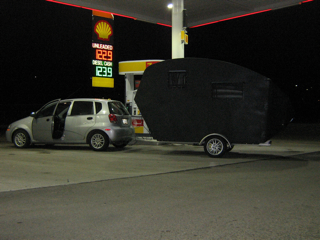

Just a quick update - road trip went very well, arrived 4500kms or so later. Recorded all the gas and odometer, for the summary paper, just have to do the ppwk. I am living in my trailer now, since the fifteenth or so! Its just pretty simple for now - no power, no water, no drapes, but its extremely comfortable for a great nights sleep, even in the rain it just sounds great. I have the clamshell facing east for the solstice, and to see how the sun and shade work on the spot its at. Its still on the frame, since I wasn't sure to maybe move it or just leave it in the first spot. Typing this on my netbook charged by the car. When you move into a bare bones trailer, your car seat instantly becomes your office seat :)
No pics this time, but to follow in a few days.

Ok so I did the spreadsheet to look at the mileage numbers and heres the summary: (all units are USMpg) (I am typing this from my imac now setup in the trailer)
-really strong headwinds and thick traffic for the north run through Ontario starting on hwy 400 put me at 18.4-19.4 mpg
-at Kapuskasing starting to head more North West and evening driving with little wind got me what looks like the best possible mileage of 24.2 mpg
-in Winnipeg there was finally some tail winds (so much headwinds for like 2 days) and got the best mileage of the run at 25.6 mpg
-after Swift Current some heavy head/cross winds were encountered giving the worst mileage for the run at 16.0 mpg
-all through the mountains from Vernon to Hope there was far less wind and in spite of pulling all that weight up all those hills/mountains the mileage stayed around 18.7-22.0 mpg
-average of all the legs of the run was 20.2 mpg, 0.2 mpg better than last falls run. A solid 20 I'd say.
So as Dancam was saying if I were towing a conventional teardrop with typical dimensions I could perhaps expect at least 7-8 mpg better on the mileage, over the course of this run that would be around 35-38 gallons which say with a gas price of 1.40/L would be saving about 200 canadian bucks on the run. So to have this trailer I have to commit more to the fuel budget. This run was waay lighter than that run from last fall where I had to move all my belongings. This run I kept weight to a minimum - I still weighed all the 8 bins that went into the trailer in order to arrange them with the heavy bins in the middle and balancing the load as best I could. Seems to work out great. I gotta beef up the tongue over the season here - gonna sister the main tongue beam and box it in. But thats not priority - installing a propane furnace and a fridge is the priority. Currently I am using a 3 day cooler and topping it up with 2 dollar bags of ice every two days or so.

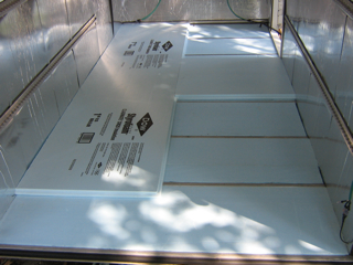

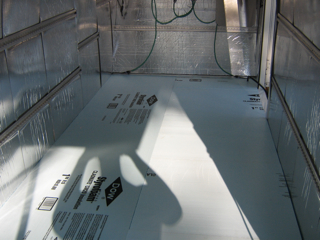

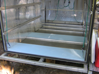

On to where I am at - yesterday I did a complete 'home renovation' and got the main line in from the 30A socket povided at the sight which has a 15A 120V adapter plugged in. Theres a water hookup too I want to plum out somehow, but for now just going to the washroom/shower house to get water. So I got 2 18ft LED rope lights hooked up and one 40W Halogen desk lamp which puts out some heat too. With the shiny interior this is enough lighting but I think I will add a third rope light. Eventually hoping to hide the rope lights in a 'valence' so all the lighting is indirect, but these tiny LED's aren't bright enough to annoy ones eyes, so it creates a very warm experience of the trailer, definitely more red than blue light. I love it! I also created the 'office' setup in the trailer, so now I can transform the space from sleeper mode to office mode.
So here are the pics for today - finally some personality to the trailer as I am living in my functional art piece:

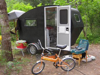

just glampin' life here, my fold up bike is perfect for this campground to get around :)

Slower this season goes, living in the space is pretty great! I am less motivated to actually push any aggressive schedule since I got the 3.4 cubic foot fridge to replace the cooler. Maan having a fridge is the best upgrade so far! :wine: Its so true when you have to buy ice all the time but am glad I did it to know that it works just fine, and all the food was just fine, even the milk and cream. I only have a kettle so far for the cooking station, my neighbor has a big bbq so we've shared some meals to change things up. All in all the 'learning curve' to get life into this small tin can has worked out just fine.

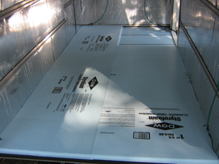

Today I finally got to getting back into the tools and doing a days work. Got the first layer of the floor done with this 1" shiplap blue foam, its pretty neat stuff. A large and small hacksaw, and a serrated knife and an exacto knife seemed to work the best to cut with less dandruff. I tried a handsaw, grinder and skilsaw too.. Second layer/inch to be installed very soon, and then 3/4" plywood floating floor.
started learning how to cut this 1" blue shiplap stuff toight
aahh now gettin' a bit better and faster, second layer will be much easier as its an entire layer of foam
just a picture of the current state of affairs on the machine

Did the second layer today. Used some scraps to fill in a few gaps here and there, its all just pressure fit and removable. The second layer went on really well, I may have been off an eighth of an inch on one cut but all in all a great cover for all those thermal bridges on the floor. I am writing this with the plywood just cast upon the new layer and everything moved back in, as there wasn't enough time to do the plywood layer. Thats up next.
first two pieces of the second foam layer going on with everything all vacuumed up good
got the end pieces matched up really well, working back to the front where the 15/30A wire main is
aaand done! its an awesome floating floor

Time to do a catch up post today, since as of yesterday I am no longer living in my little tin can. Four full time months it has been! Whew! A road trip to the Pacific Northwest coast, working and saving over the summer, and road trip back to Southern Ontario. Two things to say first off - 1) it was an incredible success to learn how to live at a campsite in such a small space, and 2) all houses are now promoted to mansions :) I'm not going to say there weren't some difficulties to overcome, many of them psychological, but in the end there truly is something exciting about glamping. Now I will try my best to keep this post brief.
One major change to the build has been made and I realize now I don't have the pics! I contracted a friend to TIG the tongue of my trailer to fix the 'just for now' fix. The local hardware store had some 6061 stuff but it was twice the thickness - 1/4" - basically he used a small foot long piece to chop off the front of the tongue where the cracks were, remove the threaded rod bracing, and TIG the thicker piece to the front. Its beautiful, sorry no pics of that today but I will for sure post them when I get back to my trailer. Essentially the tongue is shorter but long enough such that the hatch can still open. (yess! so glad I still have access to the hatch) And the main tongue beam was sistered with a 6ft piece using three u-bolts.
So what else to mention - ok in the Pacific Northwest it just doesn't ever get too hot so there were no problems with the black colour (smoky as heck during the fires, yes, but never really hot days). Yes, it would heat up during the day while I was at work, but when I got home I had a 12 watt fan that sucked air in through the front crank out window, and this would cool it back down. Without the fan it was still decent, but that 12 watt fan really helped out! I was really surprised how much of a difference it made versus passive airflow with all the windows cranked out. Now lets be clear here, when I drag this baby to Arizona or SoCal, I have an idea to snap on some white sheets around it .. we'll see but probably would do a huge improvement in truly hot climates, like say Phoenix which to me was hot in the winter - I could only imagine how hot it gets in the summer! So for this summers travels heat soak was not an issue, so thats good to know. If I lived in Arizona white/light colour Line-X would have been mandatory. But you see black camouflages really well at night, and heats up faster in the sunny morning - I'll include a pic.
Now on to the last few weeks - temperatures went down close enough to freezing to have frost in the morning and pretty darn cold nights. I needed to put the heater on 1200 watts to make it toasty in the cabin at night. At 750 watts it would be reasonably warm but barely cycle or almost run full on. At 1200 watts it would cycle decently and keep the cabin very toasty. Remember I haven't even insulated the clamshell yet! Or even put the thermal break material on the L-track. Or install the final 1/2" foam/baltic birch layer for the walls. But enough said, it was 'good enough' for this test of 4 months of full time living. With the completed amount of insulation it will make it better for both cold and warm climates.
On to the road trip - so same one I did last year, even just about the same additional weight the little car had to drag - about 1826lbs over stock, half the cargo in the car, half in the trailer say. Axle weights were 1716, 1408, 1342 from front to back. I was super detailed in my last two road trip summaries so for this one I'll just quote the worst mileage was 17.1 USMpg, and the best mileage leg was 21.2. Overall mileage for the run - 19.3 USMpg for the about 2750 miles or so.
Well thats a decent update - I will take pictures of the Tigged tongue it looks like art compared to my beginner MIG welds. I think he convinced me to start practising with a TIG.
The build is going back into rodent free storage mode, with all my belongings in it. I will probably try out winter glamping in it later on this year or early next year to get a data point on cozyness/lack thereof. Oh and almost forgot, the half axles will be retired to a new utility trailer I'm gonna make - Timbrens is in the hole.
So cheers to this forum for continuing to teach me and the spirit of the trailer traveller - so much fun. Even the tough stuff makes one feel alive. Every day can be an adventure. Here are todays pics:

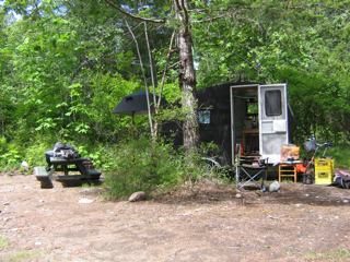

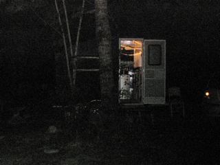

this bad pic is to show how minimal my setup looks at night with the door closed - fits into the night really well
similar to last years run - out of the mountains (and the 4hr snow storm) and into the flats
northern ontario lake superior on a really windy wavy day - should have spent 2 days here
