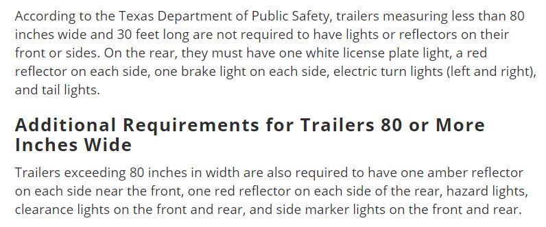

  • My TTT is set up similar to Tom's, even though I camp alone. A side-tent with a Luggable Loo in it (and room to change clothes in...hard to do in my 4x8), and with exterior lighting for nighttime visits (blue rope lights strung under and around the trailer and tent...supplementing other under-door lights...don't want to step on a reptile, if at all possible).
  • As for the clearance lights, Texas does require them on trailers over 80" wide, though open trailers (like my race-car trailer, 18' dovetail) usually can get by without, though required. But, if the body/cabin of your trailer is 80" or more, then it is a must have. I copied this from https://legalbeagle.com/7198450-texas-dots-trailer-light-requirements.html
    Texas trailer lighting requirements 2.JPG (68.91 KiB) Viewed 4879 times

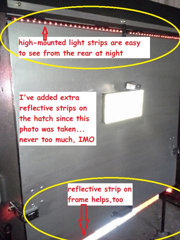

  • My squareback TTT is only 72" wide, fender to fender, with a 48" cabin width, so I never had to install any such lights. However, after nearly getting rear-ended at night, I installed a high-mounted set of LED taillight strips, that serve as extra, very visible, sequential turn signals and flashers, running lights, and brake lights. edited, from an earlier thread:
    working on it wrote:... I've long considered an easy add-on, that stands out at night... a "line of fire" type LED light bar (like added to many pick-ups). There are some that have multi-functions, and a four-way connector for easy hook-up to the trailer wiring. It's on my to-do list.... Decided on a high-mount, then I taped and screwed (using PL adhesive to waterproof the screw holes) the light strip to the hatch. The control box is inside the galley, and the 4-way plug is there too; I used a matching 4-way to mate with it (so I could use an existing hole in the galley floor to connect it under the trailer to my Spectro wiring center), then I ran the wiring inside the hatch seals for a "hidden look". Programming the sequential turn signals took 20 seconds, and done.
    High-mount LED's, and reflective strips for max visibility.jpg (164.04 KiB) Viewed 4879 times
173193172890148599
