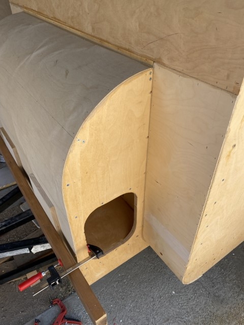

I had originally intended to build my own 8x10 compartment doors. But finally decided ease my anxiety and bought some prefab 9x12 Challenger doors instead.
I re-routed the original cutout so the new door now just barely fits top to bottom.

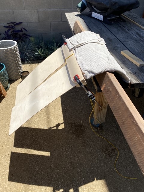

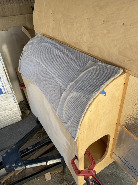

Pre-bending the curve...
This portion of plywood was threating to crack when I tried bending it dry. Soaking it did the trick!
Here's where it stands today basically. So far, just the tongue box has a coat of poly.

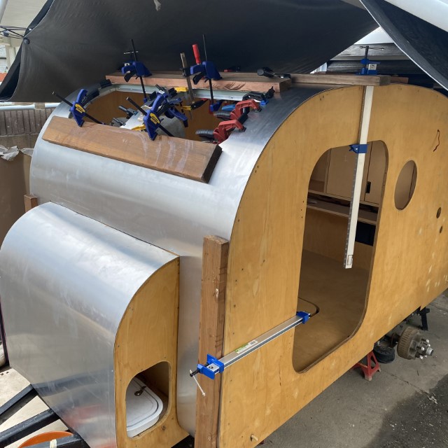

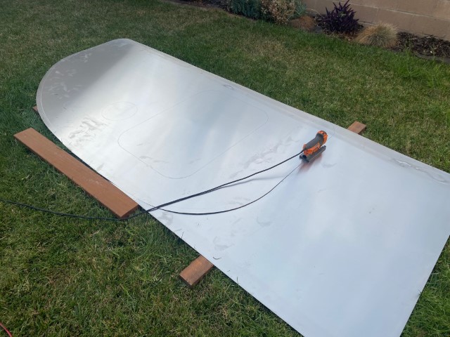

This Labor Day weekend I started cutting aluminum!

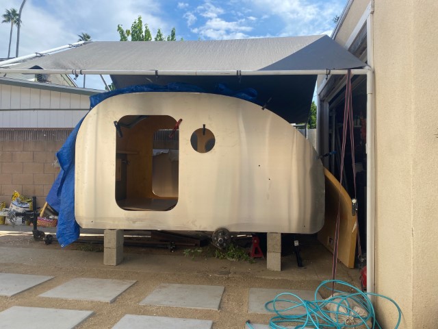

FYI, if you ever considered using cheapo Harbor Freight pneumatic metal shears, don't bother. I barely got it to snip more than 4 inches at a time! A jig saw works just fine.
Side walls rough-cut and dry-fit.

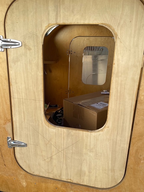

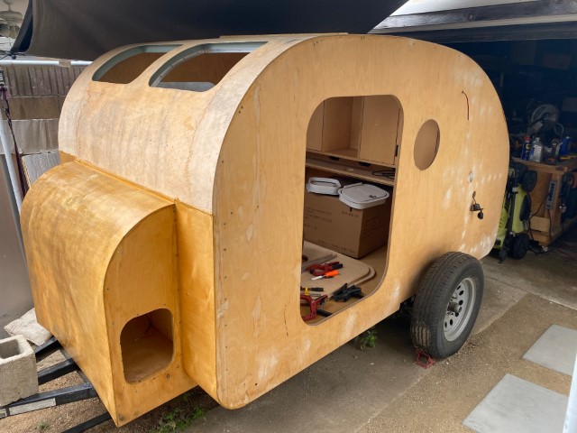

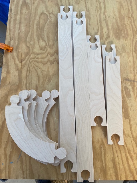

I decided to add wood doorstops. My local hardwood shop will mill the parts for cheap...not much more than the price of the sheet of plywood these were cut from! Totally worth it.

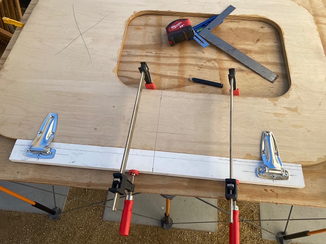

Used Tony's method for locating the hinges. Worked out well!

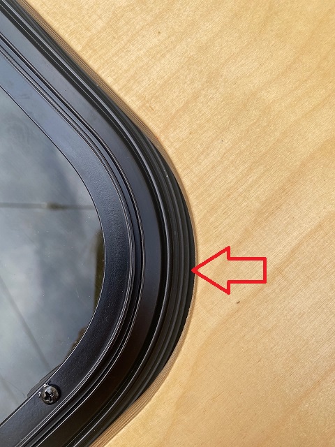

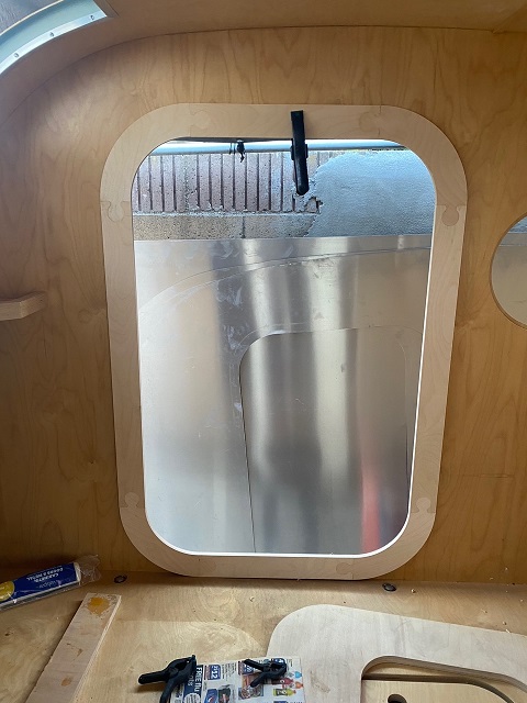

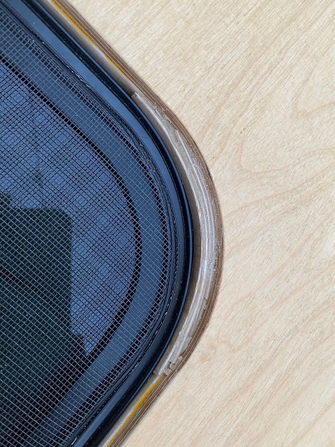

Discovered that my cutouts were too big for my windows (shouldn't have trusted the dimensions and corner radius specified by the manufacturer). Oddly, the trim ring fit perfectly. To make sure the rubber seal has solid backing I glued in strips of balsa.

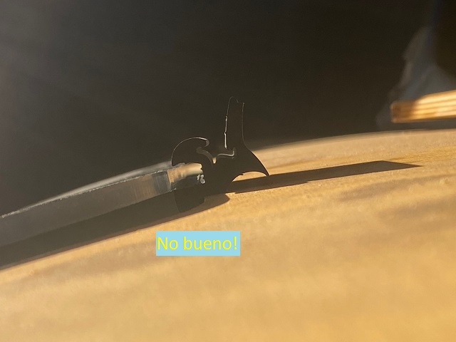

I finally decided it was time to throw my acrylic sheets in the oven so they can be bent to a 24" radius. It all went well until...Big surprise, just like Shrinky-dinks from the days of yore, they had shrunk by 1/4" all around!! Thankfully I have a local plastics shop that cut me some new ones while I waited (on a Saturday even!). The new ones fit perfectly!

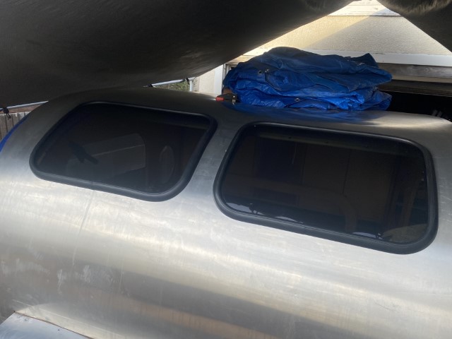

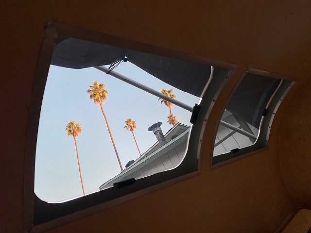

Progress update... Skylights in!

Postby Capebuild » Thu Dec 22, 2022 4:39 pm
Looks really great! Your skylights came out very well!! Nice!! :thumbsup:

Postby Onajourney » Thu Dec 22, 2022 4:59 pm
They look fantastic!! :twisted:

Postby eLink » Thu Dec 22, 2022 8:38 pm
Onajourney wrote:They look fantastic!! :twisted:
Thank you!
Capebuild wrote:Looks really great! Your skylights came out very well!! Nice!! :thumbsup:
Thanks John,
I was encouraged to get them done after seeing how well they worked out on yours!
