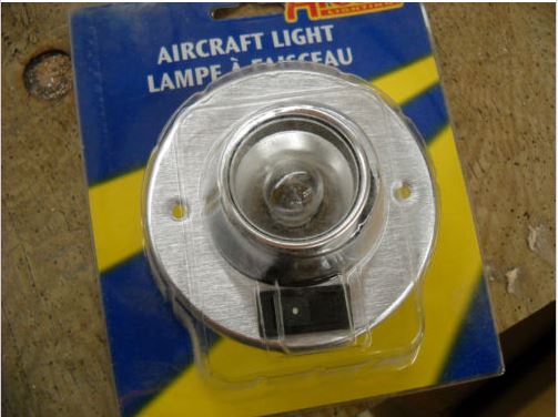

I've been looking for lights that suited the cabin.
Criteria wasn't real strict:
Older style appearance would be good.
Prefer surface mount to cutting holes in liners.
Prefer in-built switch.
Prefer Australian seller. Have nothing against foreign sellers, but the last thing I ordered from overseas has failed to materialise - freight has been disrupted I guess.
So I ordered a couple of these:
cabin light.JPG (40.02 KiB) Viewed 4007 times
Ordinary incandescent bulb kinda appeals. Given proposed size of battery, I have a 250 watt solar panel, I figure if it uses a little more power it'll be worth it to avoid the harshness of LED's. They work out at $14 each with the freight.

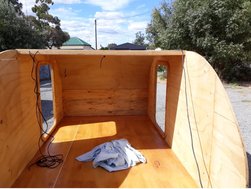

Small progress.
Drilled some holes to run some cable.
Cabling will be minimal - up front will be, two 12v lights and a usb outlet charging of phones. There will be no mains power circuits in this rig.
If I find I frequent caravan parks a lot, I might consider a shore connection and battery charger.
Bought some double insulated cable - 1.85mm2 - about 15 awg.
Allegedly good for 15 amps - so I reckon I might fuse it at 10! :lol:
(Trust no one - then you are never disappointed.)

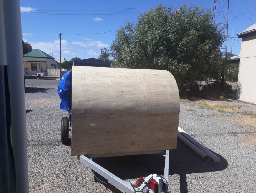

Trimmed the ceiling panel and test fitted it.
I consider the outer skin, glued and nailed to framing and walls, as a structural element.
Hence only test fitting the inner skin. I'd rather able to see how well the outer skin faced up to the glueing surfaces.
(Very nicely, thanks. :) )

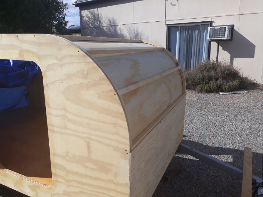

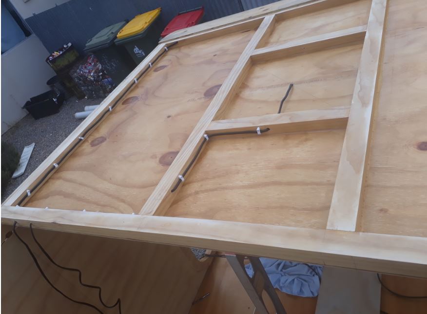

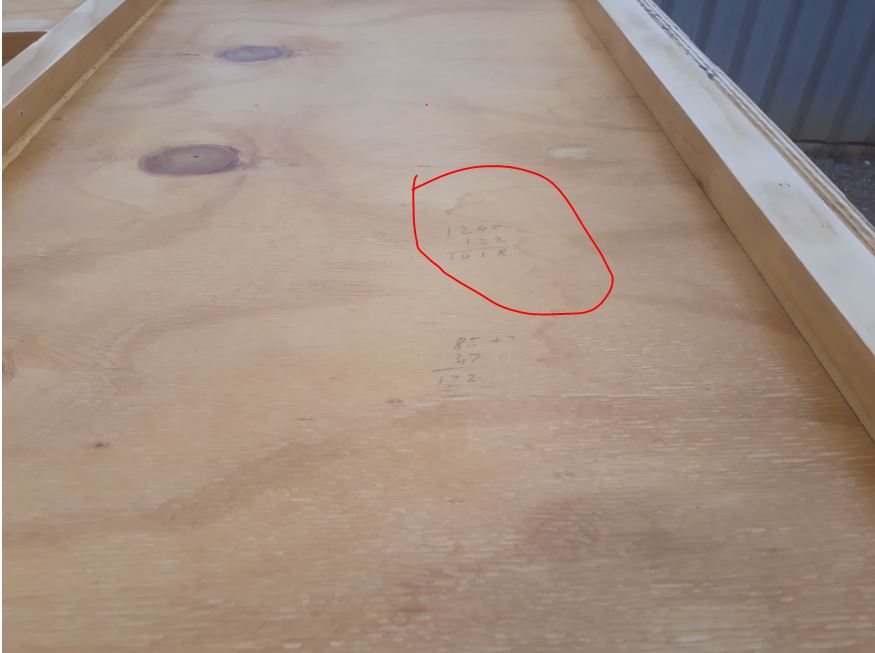

Postby MickinOz » Tue Apr 07, 2020 2:12 am
Putting a camber in the roof.JPG (57.92 KiB) Viewed 3859 times
Cables in roof.JPG (66.58 KiB) Viewed 3859 times
Cutting and varnishing panels, hunting up electrical bits, running repairs to the truck, and trips to hospital don't bring many photo ops.
The truck is a Ford (Fix Or Repair Daily), so there is no surprise there are running repairs required.
Like every Ford I've ever owned, goes great, fun to drive, but there is always bits of trim falling off, or little ancillary items that stop working.
Today I lifted the bonnet to try one of my new cabin lights on the battery, and discovered that most of the clips holding the grille in are either broken or missing altogether.
That was challenging.
But I digress, again.
Installed cable for my minimalist cabin lighting and power, and then fitted the roof.
My electrician son said I could just let the cables lay in the cavity, but I couldn't resist clipping them in place.
I helped build a few widespan sheds and carports when I was a pup, We always tried to build a little camber into the roof. The idea was to try not to have the beams sag past the horizontal when the supports were taken away.
So I did the same here.
We'll see how that turns out.

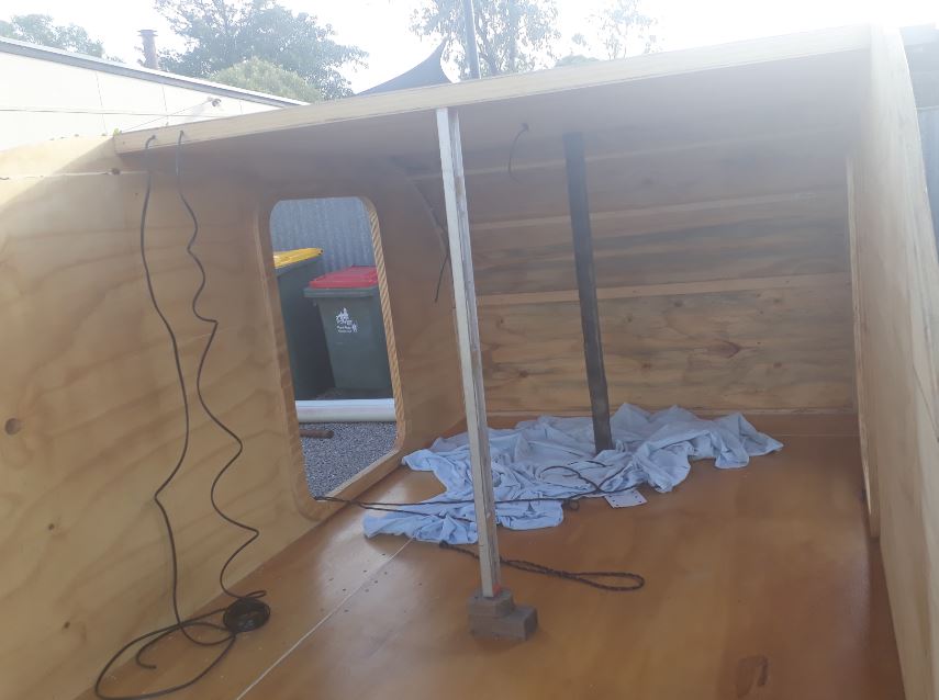

Got the headlining and head board fitted. So pleased with progress that I had to go inside and reward myself with beer and raw beef.

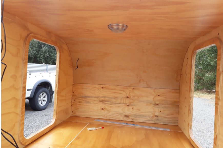

Cabin dome light arrived today.
Looks just right. I fitted it while the missus was out, She was pretty happy with it when she saw it installed.

Then I created a template to mark the cutout for the swiveling reading lamps in the shelf I made yesterday.
I've made a decision with regard to the wiring. Installing the ceiling mounted dome lamp yesterday, I used a piece of insulated terminal strip and made screw connections.
So much easier than trying to solder wires together overhead. These connector were the ones that have a little strip of stainless steel in them so that the screw isn't chewing up the wire as you tighten it.
I'm not sure if Ill be able to get that type again, but if I can only get the plain ones, my son has an impressive collection of bootlace strips.
So that is it - no soldered connections unless there is no other way.
I believe it will end up a lot neater.

This is the front shelf test fitted with the swivelling reading lamps.
A little heavier than planned. 7mm plywood base.
I had 42 x 19mm bits laying around so that is what the frame is.
My fervent desire is for this to be stiff enough that I only need to mount it at the ends.
We'll see.
Plan is to slip the shelf in as a pre-wired unit that just need to connect to the tail I left hanging out of the headliner.
Pleased with the domelight - incandescent bulb, real glass lens.
I could have gone lighter, and used less power, but somehow these seem more in character.
The two reading lights and the dome light will draw 3.4 amps between them ( I measured it).
I'll wear that.
