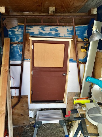

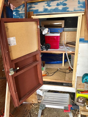

Well, I suppose that this is the only Tiny Trailer with a 1920 REO door. (My best guess is that it is a late teen, early 20s REO part, any help on that ID would be appreciated).
So, it works! The frame is complete structurally. The latch works. It is cat proof, although not bug proof yet. I’ll be working inside now to strengthen the side wall and build cabinets and fill the missing ‘window’ areas left from the door installation.

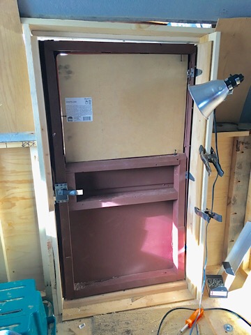

And, a view from the inside with the door closed.
Yes, I’m having fun. I can now just turn the handle, step on the little step below the door and enter the trailer. That will make continued interior work MUCH easier. When I went out to take pics, it was about 40 degrees outside and 70 inside the trailer. No extra heat, no insulation and lots of holes left. This should make a fine little mobile ‘home’.

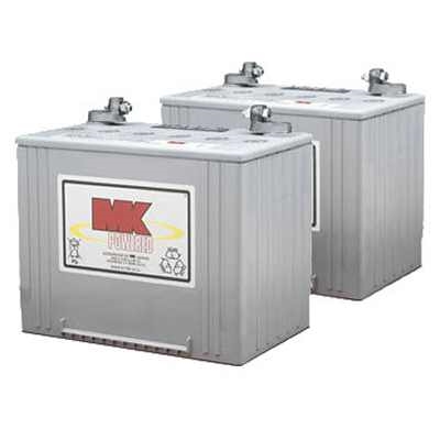

My batteries arrived today, these will be installed (probably in the back, in the galley).
That’s two 74 AH gel cells. I’m looking at the list of ‘stuff’ necessary to make it all work right. I found a really neat switch that will allow connecting one, both, the other or no batteries. Like that. I also think there will be a dedicated, switched 110 volt outlet in the electrical box to allow the battery charger/maintainer to be disconnected too.

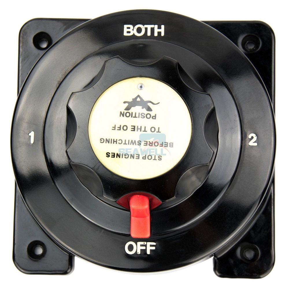

Postby swoody126 » Fri Jan 10, 2020 7:19 pm
hey NB
¿ you mean one of these ?
had one on the boat and have one on the firetruck
jam handy when wired properly to isolate one from the other for reserve
you can also wire a charging feature thru the trailer light plug to top the batts off while running down the road just like on a REAL RV ;)

Postby swoody126 » Fri Jan 10, 2020 8:41 pm
NB,
if the knob doesn't have some kind of brail bump or wrinkle for the pointer(red on my pic) put something there that you can feel in the dark
trust me on this YOU WILL KNEAD IT
sw

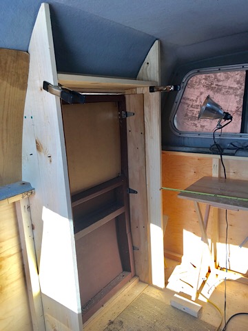

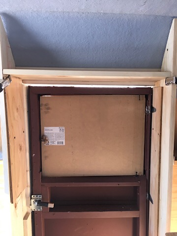

I took advantage of a good sunny day to get the door casing glued in place. It was 80 degrees in the trailer when I finished and still 75 a couple of hours later. Glue is good to go. It is 40 something outside, with about 6” of snow on the ground. Figured I needed to get this bit done.
And a view of the little shelf above the door.

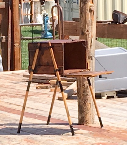

The space at the front of the trailer, next to the bed will become a cabinet (the part in the corner) and the open area where the little table is will hold my ‘campaign’ desk. I modified the legs to be vertical and the thing will be held in place with a bracket so it is still removable for use outside.
The campaign desk is made from a wooden battery box from long ago, the lid is made from pallet boards and the legs are military surplus tent poles. Making them vertical will make it work in the trailer.
