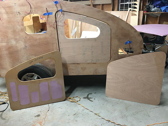

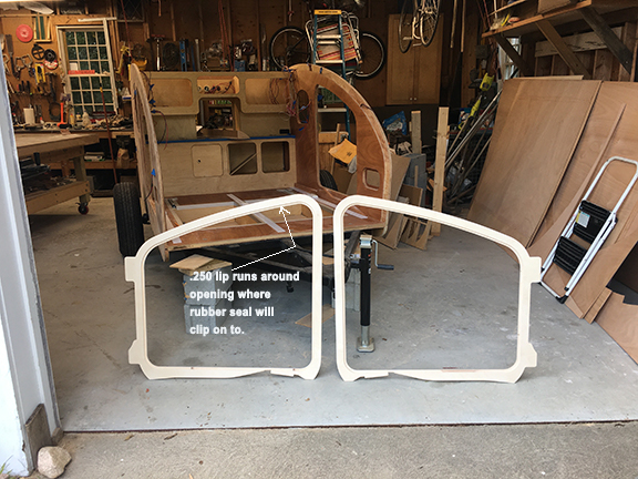

Postby Capebuild » Tue Sep 28, 2021 5:24 am

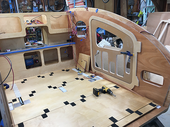

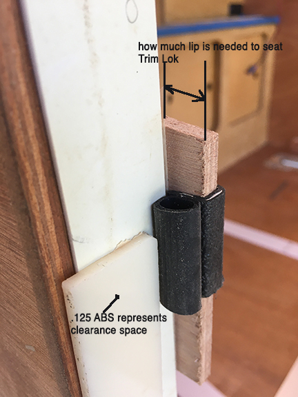

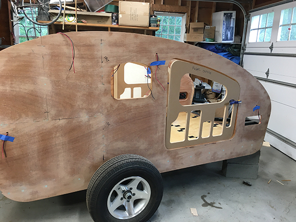

Tomorrow I'm planning to get the door panels, hatch struts and inner door moldings CNCd.

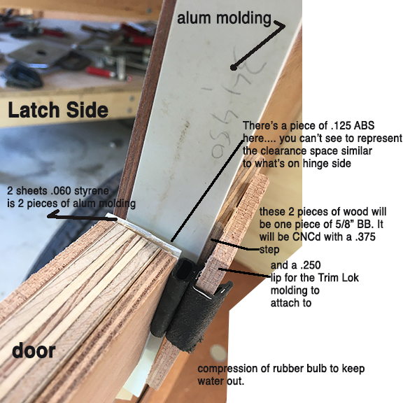

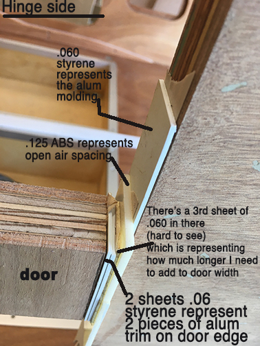

I was still not sure how much clearance was needed for the doors (how wide to make the doors)...... so I built a mock up of sorts which I'm hoping will provide a better idea.
Luckily the Trim Lok seal I had ordered arrived just in time to help with the mock up. There's another seal I had order that would go on the cabin opening (on top of the aluminum trim
moldings) but not sure I'll use it, or order something else.

Postby tony.latham » Tue Sep 28, 2021 8:26 am
John:

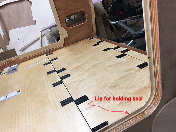

I assume your doors will only compress the seal about 50% or less?
Re: CapeBuild Build Journal
Postby Capebuild » Tue Sep 28, 2021 8:45 am
tony.latham wrote:I assume your doors will only compress the seal about 50% or less?
In the second photo it shows (an estimate) of the seal compression. I'd estimate it to be less than 50%. However the aluminum trim I'm planning on using on the door edge will have a return on it that wraps around the edge of the door that would also contribute to compressing the bulb another .060, I'd assume. But I'd think, even with that, the compression would not exceed 50%.
But thanks for making me think about it :)

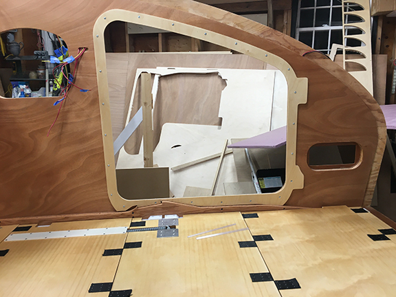

Postby Capebuild » Mon Oct 04, 2021 3:19 pm
October 4, 2021
Over this past weekend received some additional CNC parts (like the doors, interior door and window moldings... few other parts).
Starting to glue up the door assemblies. Now that I have the interior door moldings I was able to finalize the tracks the bed platform runs along
(actually needed to bump it out a bit to clear the door moldings. So now the bed platform is fully installed in place.
I was going to install the headliner but there always seems to be other items popping up that would be easier to install now prior to installing the headliner.....
so taking care of those items (like some electrical work.
Speaking of electrical.... had a real screw up the other day when I accidentally drilled though the data cables feeding the battery monitor and the solar monitor. :x
They were buried in the side wall. Really annoyed at the time (duh) but ordered a couple of new cables and will run them an alternate way with some other cables I'm running
though the galley walls. So be it :beer:

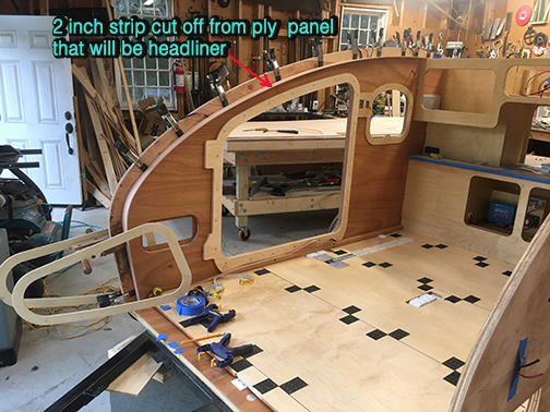

Postby Capebuild » Fri Oct 08, 2021 6:10 pm
10.8.21
I was struggling with how to get a good, precise measurement for how long to cut the ply for the headliner. I tried a couple of different tape measures, a plastic coated flexible tape a seamstress would use.... but going around the curved surface of the side wall I wanted to be sure of the measurement. I knew what the width needed to be and cut a 2 inch + strip from the 10 foot ply I had to be the necessary width measurement. Then had the idea to use that 2 inch strip to wrap it around the rabbet where the headliner will fit. I slowly kept cutting it back till it fit nicely and will be able to take the measurement from the length of that strip to determine how long the headliner ply should be.
The clamps are holding the test strip down against the rabbet.
The two pieces at the front of the trailer are moldings that go around the interior side of the window in the doors (they're drying for the night from just being urethaned this afternoon)
John
