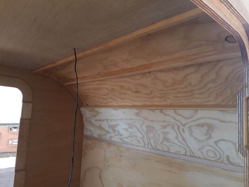

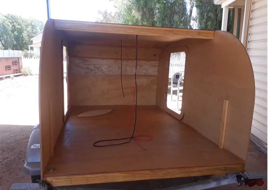

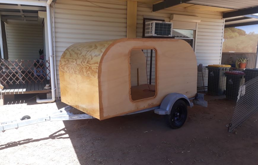

Right, here we go - pictures.
hiding from the weather under mums carport.JPG (73.17 KiB) Viewed 393 times
just about ready for rear bulkheads and counter top.JPG (70.5 KiB) Viewed 393 times
Ready for last interior lining panel.JPG (52.12 KiB) Viewed 393 times

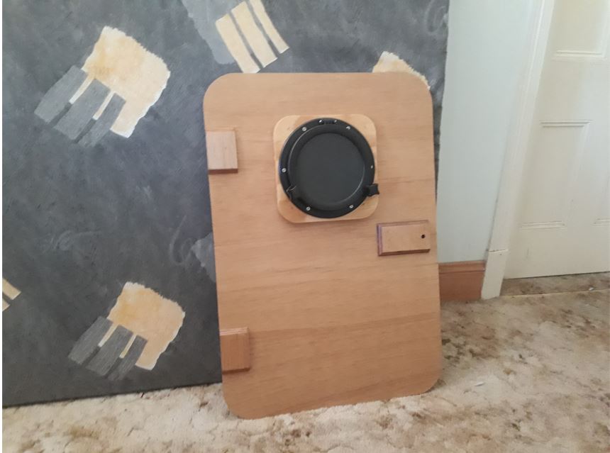

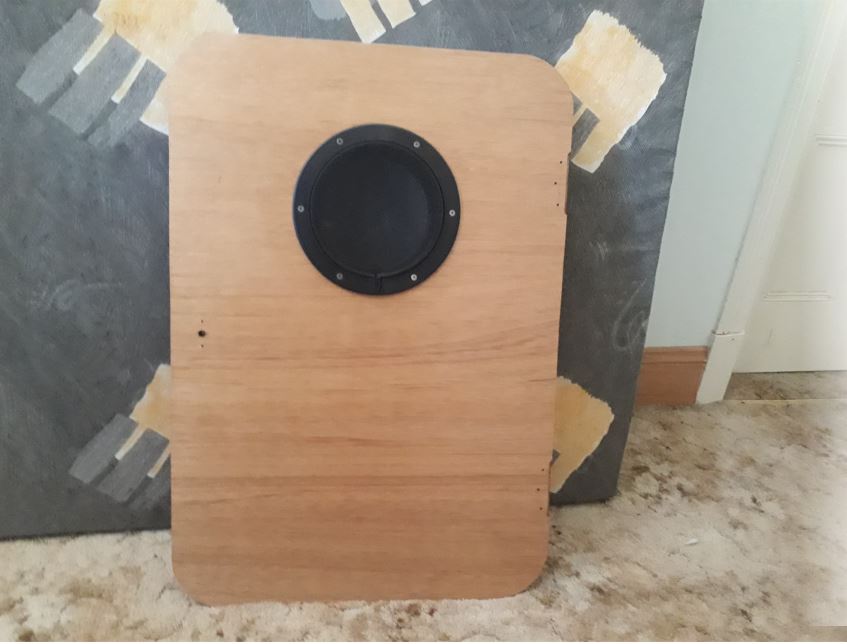

Doors are ready. Storing them in my hallway wit the mattress. Going on last, to minimise the risk of wear and tear.
Finished door exterior.JPG (58.89 KiB) Viewed 390 times
Finished door interior.JPG (58.45 KiB) Viewed 390 times

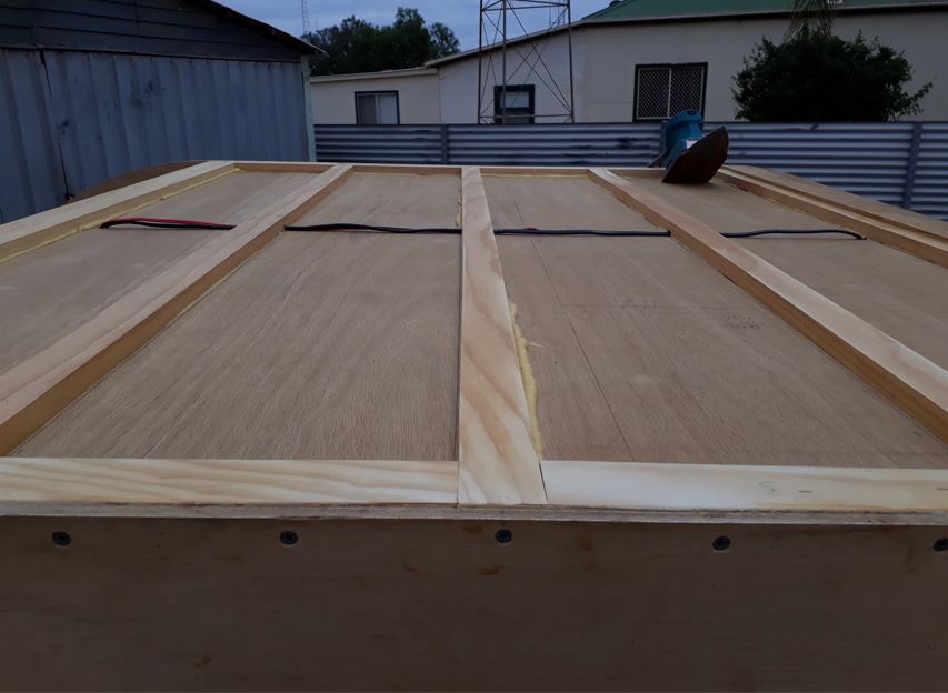

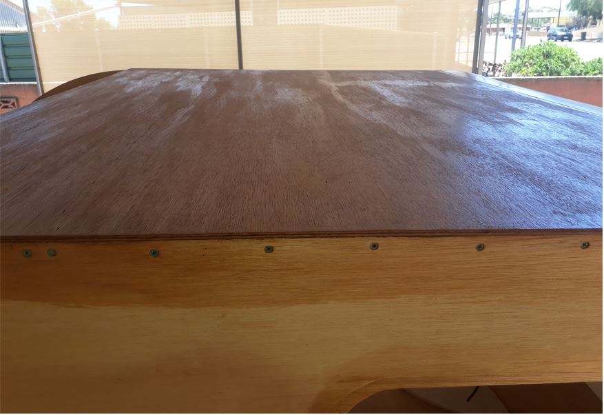

Roof panel finished up OK. Toyed with running wires in the cabin where they could be seen, decided on concealment where possible.
roof spars and wires.JPG (61.6 KiB) Viewed 388 times
Roof panel on one sealer coat.JPG (73.18 KiB) Viewed 388 times

The other thing not in the photos. I consulted with my electrical contractor son, regarding should I pin those wires down.
I didn't want them vibrating and rubbing, but at the same time I thought it would be handy to be able to pull them through if they got damaged in the build or whatever.
He said in enclosed cavities, he does the minimum securing possible while still keeping them in place, in case he has to pull 'em.
The only exception would be singles strand wires, they are less flexible so more prone to fracturing and should be secured for minimal movement.
So those multi-strand cables now have a blob of silicone on them in each cavity, to secure them a bit, but to allow them be pulled free if necessary.

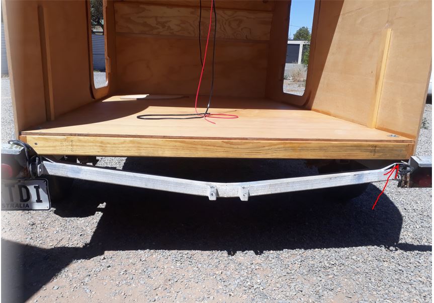

Staryder61 wrote:The pictures help see the process. Really really good. :thumbsup: Looks like that boat trailer is working for you. I had started with a boat trailer, found out that it was in bad shape (twisted) so scrapped it and had a trailer custom built. Was glad to see you were able to use yours.
You had mentioned staples earlier. When I was working on ours. I too had flipped the skin the wrong way when putting it on. Shot a couple staples right through the fantastic fan wire. Didn't catch it till later date. Things happen (Only if you tell them) . :lol:
You're doing a great job on it mick :applause:
Thanks mate.

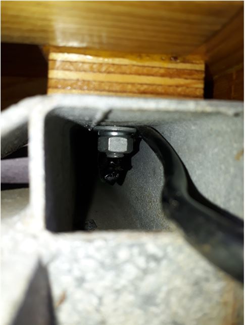

Mine is warped/twisted too. From the factory as far as I can tell, They come with adjustable rollers and bilge boards, so in their designed application they are as straight as they have to be, and you'd never know different.
But when I went to use it as a flat, straight frame for a TD - ugly, man.
I tried to pull it straight with a 20t jack, and some RSJ and chain, bit that just blew the seals on the jack.
So I levelled the trailer up on a flat floor and measured up what spacers had to go under each frame bearer to get the floor flat and level.
Seems to work, but I had to carry the wall panels down 20mm past the floor frame so the spacers can't be seen from the side.
Interesting thing this is a commercially made trailer, possibly the biggest boat trailer manufacturer in Oz.
Frame a bit warped.
Ol' #1 is built on a home made trailer. the side rails are straight
Spacer under rear right corner.JPG (96.19 KiB) Viewed 385 times
MickinOz
Posts: 1305

MickinOz wrote:From the factory as far as I can tell, They come with adjustable rollers and bilge boards, so in their designed application they are as straight as they have to be, and you'd never know different.
True on the trailer's mick... once framed and welded, most won't give enough to straighten out. But you worked around that. And your build is going great..

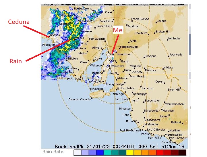

We are about 440 km's east of Ceduna, which got nearly 2 inches of rain over night.
Weather moves west to east here, so it'll hit us soon. It's lunchtime mid-summer and awful dark outside as I type.
Radar says its on the way.
Of course, you know that time in the bible where it rained 40 days? We got 40 points. :lol:
