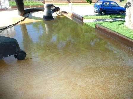

In my last post, I had turned my teardrop upside down. I sanded the previously applied CPES (3 coats), applied 1 coat of epoxy, sanded the epoxy coat, and applied a thin layer of automotive undercoating.

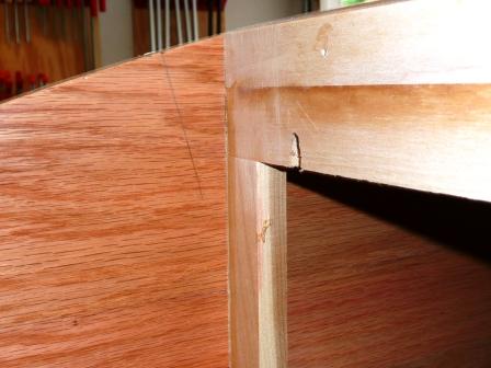

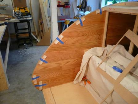

And, as you can see, I turned my teardrop over to right-sde up. Then my attention moved to the hatch. My galley bulkhead wasn't perpendicular to the profile, so I needed to add a wedge-shaped filler strip. (The pencil line shows the header angle I needed for the galley hinge to fit correctly.)
Filler strip installed.

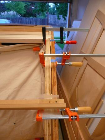

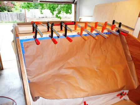

Then I began the hatch assembly. First I installed spacers (1/4" sides and bottom, and 3/8" at top for galley hinge.)
I managed to get both outside hatch ribs fitted and installed (each outside rib is doubled-up) and the hatch header and the bottom hatch spar installed, before I ran out of time yesterday.
