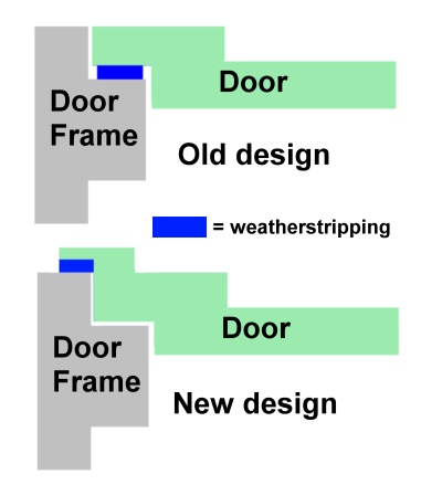

Postby Jim Edgerly » Sat Nov 12, 2011 9:45 am
As previously mentioned I am redesigning my doors because of a warping issue. I should have know better than to think a 30 inch wide door made of pine boards would not warp over time. I also had an inherent design flaw that would make the doors prone to leakage. Although I did not have an immediate issue with leakage, once The Shack is exposed to "real rain" or "highway rain" it is just a matter of time before water finds it's way in.
As you can see by the Old Design photo I was allowing water to make it's way part way into the door seam before encountering the weatherstripping. The weatherstripping was just sitting on top of the piece of wood.
In the New Design you see I have added another piece of thin wood forming a lip that goes around the door, and moved the weatherstripping to the very edge of this piece so that no water is allowed to enter the seam before encountering the weatherstripping. I also will route a rabbit into this lip to mount the weatherstripping in. That way I can plan on a 1/8" gap but use a 1/4" thick piece of weatherstripping. The weatherstripping will compress as far as needed to fill the gap, yet will not be totally compressed so I should get a really good seal doing it this way.
The finished door will look pretty close to the original door on the outside, but will look different on the inside. My wife liked the look of the "barn board" type of inside door, but she understands that "no pine/no water" is preferable to the "pine/water stain" look. I have not been in a real hurry to make progress because The Shack is stored away for the winter and won't see the light of day before April sometime. I will take the doors out and install them in the garage when ready, but no one will see them until spring.
