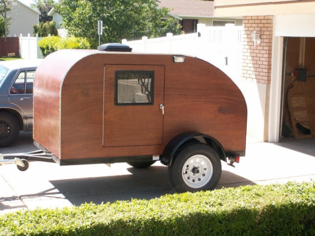

PSBreen wrote:Didn't get as much done as I'd hoped but a little more progress is better than none.
It looks wonderful! :thumbsup: :applause:

@ Sharon ....Thanks for the compliment. Cynthia really likes the look of the stained wood to. I'll have to say that it has certainly complicated things at times though.
@ Becky.... Dang it you jinxed me. We wrestled with the hatch for hours last night. Appartently the sealing tape under the hinge moved it back just enough that it wouldn't close properly. A little work trimming here and there and it's closing now.
Tonight we check the door and galley seals for water leaks. :frightened: If it all checks out we are hoping to do a "test trip" (local overnighter) this weekend without the battery or galley countertop. :worship:

The trim is installed on the cab section. The hatch will get trim when the binding screws arrive. I don't want to use rivets in case I have to take it off. We did a leak check and found a few. One in the corner of the hatch, easy fix with a scrap of weather stripping. The other leaks are between the doors/hinges and wall/hinges on both sides. It appears that some goober (me) forgot to put any type of water barrier (weather stripping, putty tape, etc) under the hinges :oops: So we are praying that the weatherman is right and it doesn't rain. I'll have to pull the doors off when we get back. I can hardly wait to do that. :cry:
Oh we also got the trailer weighed. We have a certified weight slip stating that the trailer weighs 740 lbs. Here in Utah that means that we do not have to register the trailer. :applause: It also got me thinking ..... What would it have weighed if I had used a 5x8 Red Trailer instead of the heavy duty 350 lb frame we have?
I'll try to post some pictures when we get back.
