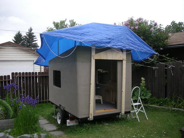

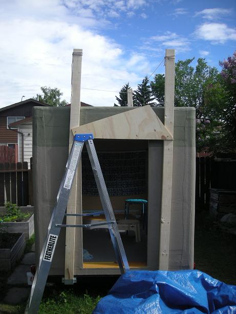

We threw together another rain shelter today, so that I could paint the roof. 2x4s are set in the stake pockets of the trailer, braced to each other, and tied with rope at the top. Then my biggest tarp is spread over them and anchored to trees & fences in the yard. It worked fine and I got a coat of paint put on the roof despite "isolated showers". :twisted:
roof rain shelter.JPG (59.38 KiB) Viewed 1585 times
frame for rain shelter.JPG (53.29 KiB) Viewed 1585 times

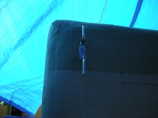

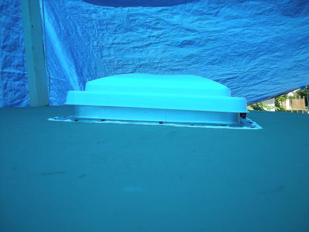

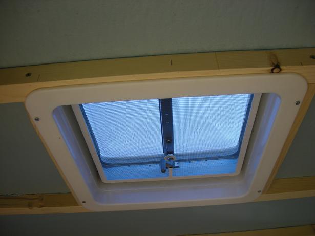

I had the morning to work on the trailer today, so I installed the roof vent and attached rope cleats to the four upper corners of the trailer. I want to have lots of place to attach lines when setting up tarps in a campsite. I also did some more work on building the door, which is almost done.
Some of these pictures are taken from under the rain shelter, so the colour is off. But it gives you an idea of why I felt so good when I went to work this afternoon! :D
rope cleat.JPG (37.31 KiB) Viewed 1513 times
roof vent inner.JPG (31.96 KiB) Viewed 1513 times
roof vent outer.JPG (39 KiB) Viewed 1513 times

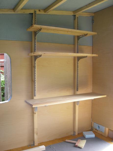

Oh, I can't resist, I also must show the knock-down shelves I installed on Wed. When we are moving the trailer, I will take these shelves down, but when we are camped they will be easy to put up again. The bottom level is my fold-down counter.

Shar wrote:Oh, I can't resist, I also must show the knock-down shelves I installed on Wed. When we are moving the trailer, I will take these shelves down, but when we are camped they will be easy to put up again. The bottom level is my fold-down counter.
That's a great idea!

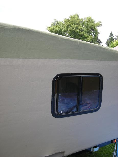

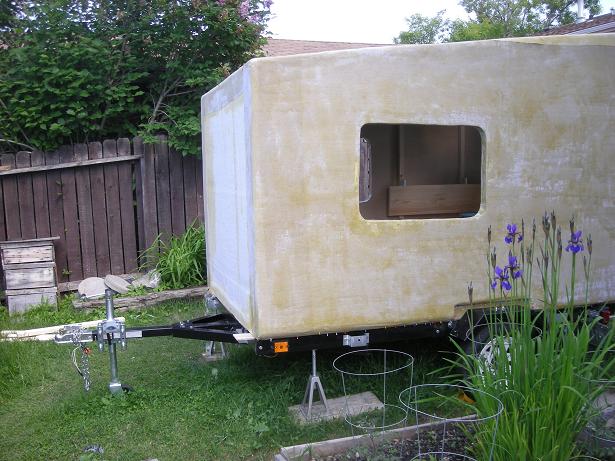

The basic shell of the trailer is complete now, with only the door and windows to install to make it weatherproof. Today we put the windows in, using machine screws to fasten the (outer) window to the (inner) clamp frame that came with it. I applied putty tape between the window and the outside of the trailer, then caulked around the edges as well. I figured it can't hurt to take every precaution against those sinister raindrops. 8)

Here's a picture of one of the windows. Can you see my secret helper?
windows at last.JPG (32.6 KiB) Viewed 1444 times

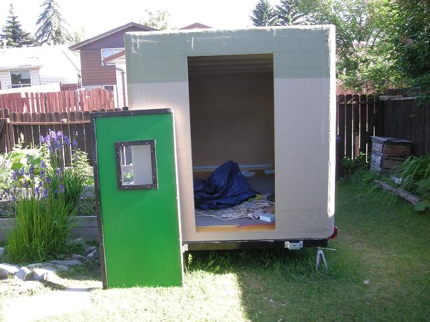

Yesterday, got the door ready to install, then discovered that somehow, the top half of the door is 1/4 inch narrower than the bottom! :shock: Clearly some shims are in order! Being a newbie, it took me a while to figure out how big they should be and where they should be attached. In the end, it was too late for power tools by the time I knew what to do, so after work today I will give it another go.
Here's how the mostly-finished door is looking. The window (grizzly-detector) is just a sheet of plexi that I screwed/caulked to the frame. It can't open but it was cheap and easy to install.
