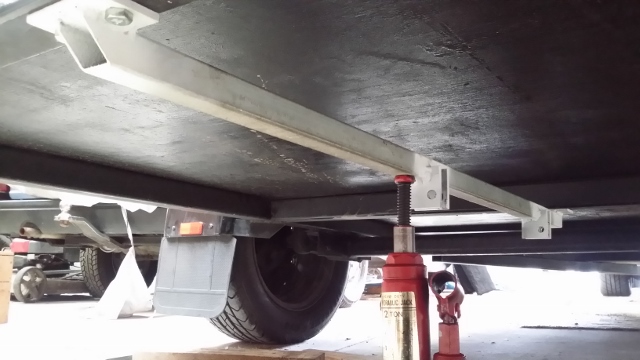

I didn't want to mount a wheel on the tongue, preferring to mount it behind the axle. :thinking: The ideal position I am looking at is under the floor, just behind the left wheel. (That is the curb side here in NZ). A full size spare was going to hang too low so we have been looking for a space saver. Stupid thing was that even thought no one seems to like these things the $10 - $20 ones were the wrong stud pattern and the ones with the correct pattern, people were wanting silly money for. We finally managed to acquire one for nothing. It is only about half the width of a standard wheel so will only hang about 50mm below the frame, plus 22mm for the carrier that I am making.

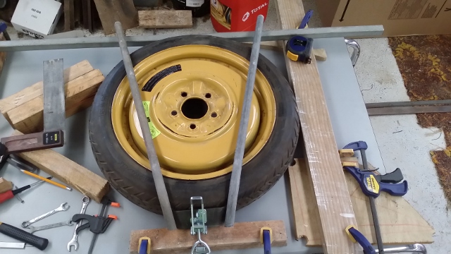

Progress so far on spare wheel carrier. Had a hunt around the shed to see what I had to make it from.

So its just going to be a hinged a frame kinda setup?
dales133
Posts: 4605
Re: Sleepin Around, New Zealand. The Build
Postby Sheddie » Fri Jan 30, 2015 4:20 am
dales133 wrote:So its just going to be a hinged a frame kinda setup?
Just like under a lot of jap vans, with an over centre latch on the outside frame.

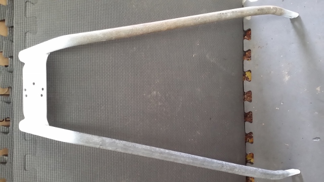

2015-02-01 11.05.13 (640x360).jpg (132.46 KiB) Viewed 2469 times
Carrier frame drilled, welded and primed.
2015-02-01 11.05.50 (640x360).jpg (122.52 KiB) Viewed 2469 times
Drilling and tapping to bolt mounting under trailer.
