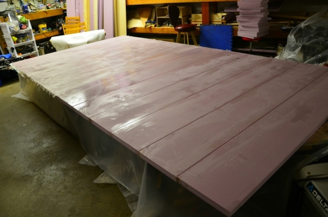

Postby OP827 » Sun Aug 23, 2015 9:04 pm
Mike, I use 13" wide planer as you can see. But a large flat surface is required to assemble, that is why I still use the trailer floor, all panels are built and stacked on the shelves. Here is the photo of roof panel assembly today's work. I went with no spars :shock: - will see how it works with both sides laminated with 6oz epoxy for the roof. Need to add another three panels for the complete roof, it is quite large (6.5' x ~15.5ft), estimated the weight within 80 lbs for roof, total. Hope to make it light so it can be lifted by hand from one side at a time.
Waiting for the epoxy to set and then while it is still green I will start fiberglassing one side, maybe working late tonight...
Thanks for reading.

Re: Foldable foamie transformer - Now for the roof build!
Postby OP827 » Mon Aug 24, 2015 1:47 am
Third of one side roof panel is laminated, good enough for today's work. :beer:
