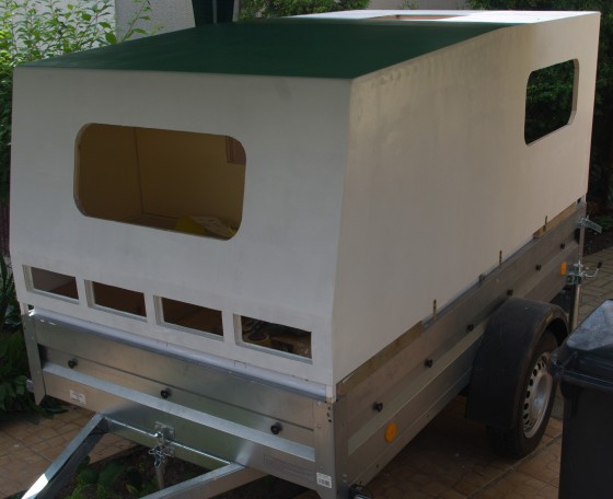

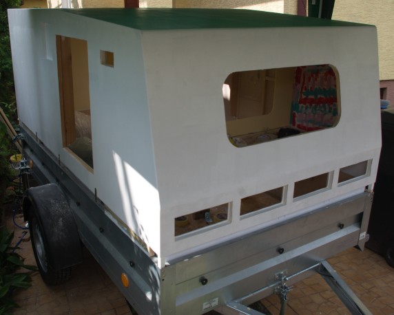

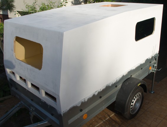

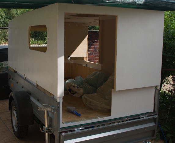

I covered my caravan box with a first coat of paint. It covers very well and I think the paint went into plywood and filler deep. Now I go to get canvas and then will make a test how to apply canvas on a trailer.
Please note lower part of the capsule installed within trailer boards.
I plan to install handles on corners of the box as well as pieces of plywood to cover gap between capsule and boards.

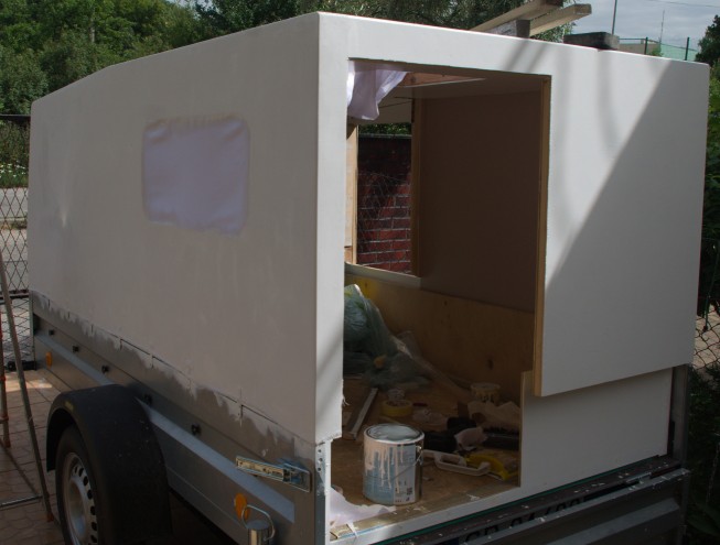

I decided to do the B option. Still, I can cover edges with a glass cloth on the top of canvas.
As there is sun today and forecasts say it will not rain I take a chance and do the work.

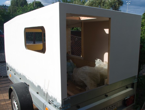

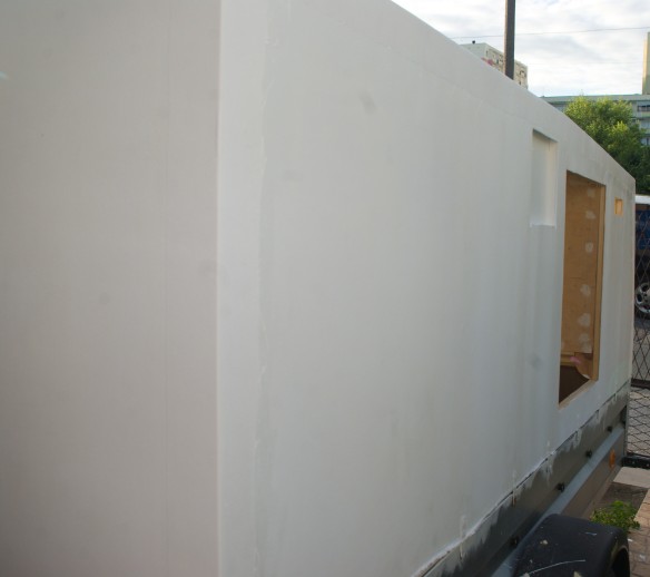

First came the left wall. Covering whole with paint and then applying canvas failed as paint dried before I set canvas properly on its position. I realized that when I put canvas on a fresh paint then paint appears on the other side of canvas as well, so paint goes through canvas, between its threads.
So I appllied canvas partially, placing first the whole canvas on the wall and then painting it from outside. Sticks very well, after a couple of minutes it is glued to the wall. I overlapped the roof by some 3 inches. So far, I am happy. Now I washed the brush as it caught some threads after cutting. When it dries, I will do the second wall.
ipy
Posts: 92
Images: 15
Joined: Fri May 08, 2015 4:25 pm
Re: Small caravan box by Tom

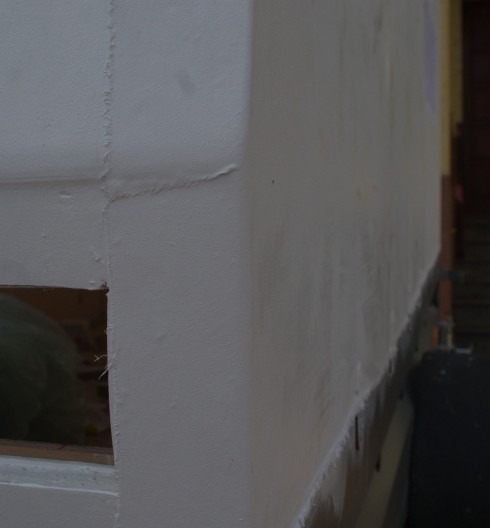

Postby ipy » Sat Jul 11, 2015 12:30 pm
I have done what I planned for today. The whole capsule is covered with canvas. Does not look perfect but still it is acceptable. On Monday, if there is no rain, I will paint whole thing last time and then I am ready to install windows.

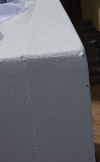

Postby dales133 » Sat Jul 11, 2015 7:03 pm
Looking good bud
If you've got bubbles try putting a damp towel over them and iron it and see if that helps get them out.
You will probably need a few coats of glue to make sure it's right into the fibers as this is what makes it waterproof.you can also sand between paint layers to get a better finish.
