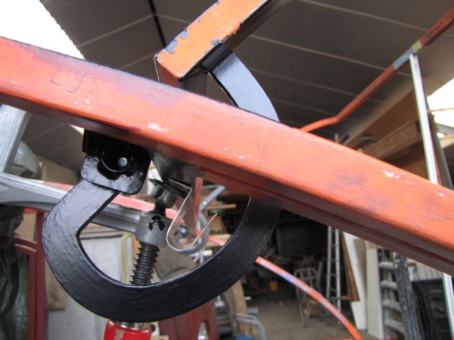

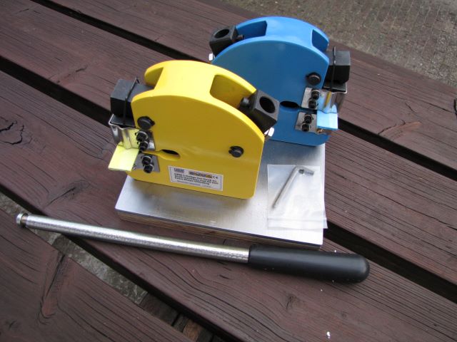

For making the "rainwatergutter drainsystem" i already bought some tools.
Maybe you know what these are? ( see fotograph)
(When you work with metal you surely do).
I mounted a set of 2 on a thick steel plate so i can clamp the whole thing on my workbench when in use.
Well that's it for now.
Greets from the Netherlands, Kees.

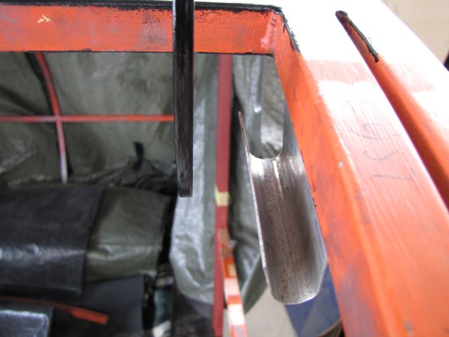

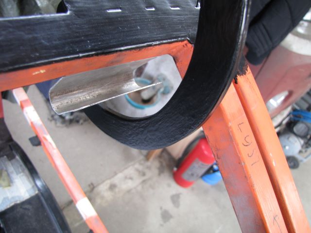

Postby smeerkees » Sun Jan 14, 2024 10:41 am
Hello Everybody,
Here is a small update as promised about the "overall" design idea of the "raingutter" system.
Espessially for Tom, and Shelly.
I made a bunch of pictures in the hope to give you an idea.
From the underside: with hatch in open and closed position.
IMG_2782 verkleind voor tnttt.jpg (47.29 KiB) Viewed 2468 times
IMG_2779 verkleind voor tnttt.jpg (44.94 KiB) Viewed 2468 times

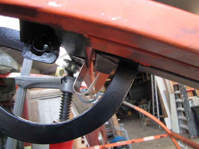

Postby smeerkees » Sun Jan 14, 2024 10:49 am
And from the topside.
There is about 2/3 a 3/4 of an inch space between "gutter, and hatchhinge so enough space for the rubber seal.
IMG_2806 verkleind voor tnttt.jpg (43.17 KiB) Viewed 2461 times
IMG_2813 verkleind voor tnttt.jpg (37.72 KiB) Viewed 2461 times

Postby smeerkees » Sun Jan 14, 2024 10:57 am
Here an idea for the underside of the hatch.
The "gutter" will probably be a little less deep here and there, that is according to the depth i need for mounting the rubber seal.
The last picture is the underside of the hatch, and because water won't run uphill, i have to make 2 little drainpipes (both on the left and on the right side) with hoses through the floor of the trailer.
Yhe inside diameter of those drainhoses will be about 2/3 of an inch.
So In case of much water to dispose the biggest exess will run through the gutters outwards the underside of the hatch, and since that is not exactly the lowest point, the last bit of water will be gone by the 2 drainpipes left and right.
I hope you get an idea of it all.
The idea at this moment is to first form the sides 1 by 1 and Tig weld them together, and than glue those gutters to the existing beams. (For the hatch, and both the doors ofcourse) It has no structural strength to it, and i avoid a lot of heat in the structure. (espessially to avoid for the bended beams)
I know that there are solutions in the automotive world for things like this. Products like panelbond from 3M. Or something like JB Weld.
I have to say, the hinges fit remarkebly well. there is no play at all.
However there is one little thing to remember.
Since i didn't know the exact outcome of the hinges i did not make bumpstops for a maximum openig of the hatch in the design of the hinges.
I now think about 90 degrees of opening will be plenty.
Now i can use a pair of hatchstruts for maxumum opening (as also used in cars), or i can make some kind of bumpstop on the hinges itself.
In that case something a little adjustible would be great.
Either way i need to make something to not destroy the "gutter system" when the hatch will be opened to far.
So now i have to learn some skills for bending, stretching, and shrinking and otherwise manipulating thin metal plate.
The big blue and yellow things in a previous update are shrinking, and stretching blocks i bought already.
Metal can be pretty manuable but you have to learn some skills how to.
Well, thats about it for now.
I hope this update makes one and other a little more clear.
So for now greetz from the Netherlands,
Kees.

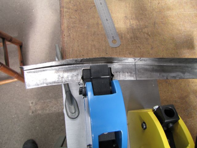

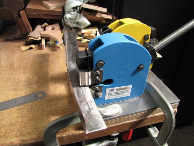

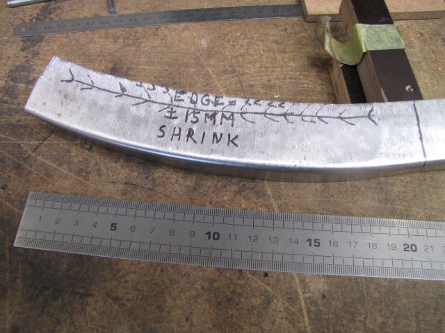

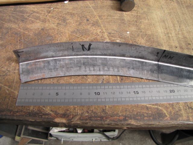

Postby smeerkees » Sun May 12, 2024 3:57 pm
Hello everybody,
Here an update from the Netherlands.
Next project is how to form metal for the "raingutter system".
How to form (sheet) metal in multiple dimentions.
For this i had a big help from a YouTube channel called: Make It Kustom. (By Karl Fisher).
Here i learnt a lot about shaping and forming (sheet) metal with a minimum of tools.
Most tools are hand tools, and some of the tools you can make yourself.
One of the most important things i learnt is to see (sheet)metal a bit like childrens playdough or formingclay.
It is way more manuable then you think.
So i bend some L formed strips of 1.2 mm thick strips of sheetmetal and worked it with both my shrinker and stretcher press.
Here some photo's of the first try's.
IMG_2856 verkleind voor tnttt.jpg (45.34 KiB) Viewed 1943 times
IMG_2857 verkleind voor tnttt.jpg (54.39 KiB) Viewed 1943 times

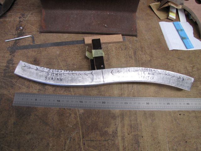

Postby smeerkees » Sun May 12, 2024 4:08 pm

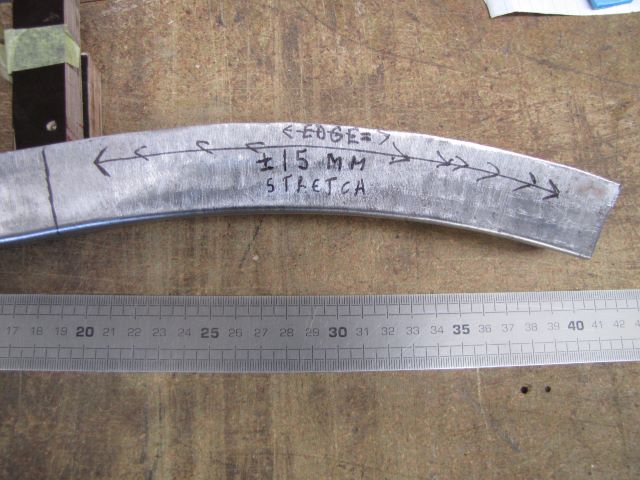

Ok, now both shrink, and stretch on the same piece of strip.
IMG_2883 verkleind voor tnttt.jpg (53.53 KiB) Viewed 1941 times
smeerkees
Posts: 111
Joined: Thu Feb 26, 2015 6:03 pm
Location: Netherlands
Re: Meanwhile in the Netherlands,...

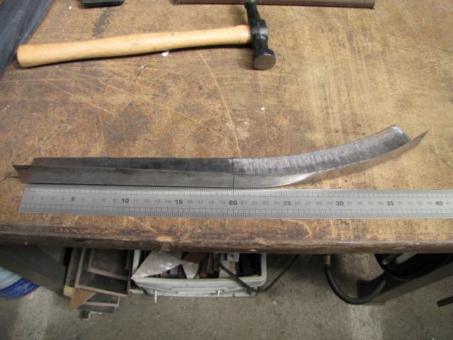

Postby smeerkees » Sun May 12, 2024 4:09 pm
The shrinking part,
IMG_2884 verkleind voor tnttt.jpg (57.19 KiB) Viewed 1940 times
smeerkees
Posts: 111
Postby smeerkees » Sun May 12, 2024 4:11 pm
And the stretch part:
IMG_2885 verkleind voor tnttt.jpg (59.75 KiB) Viewed 1944 times
smeerkees
Posts: 111
Postby smeerkees » Sun May 12, 2024 4:31 pm
You literally shrink and stretch the material.
In the case of the sample about 15mm (3/5 of an inch) on a length of about 20cm (about 8 inch).
So 3/5 inch stretch in 8 inch, and 3/5 of an inch shrink in 8 inch.
When you look at it it seems pretty much. :shock:
Also when you measure the thickness of the material with a caliper you can see the changing of the thickness .
The stretch side got about 0.1mm thinner,
and the shrink side about 0.1 mm thicker.
Now remember to take it slow and work from the edge slowly inwords.
Very small pumps and not to heavy with the handle of the forming blocks at a time.
And working on your actual workpiece, keep your workpiece at least 1 inch longer per side. This keeps the teeth of the formingdies away from the edges, and your "bend" wil go till the end of your sheetmetal piece. As you can see on image nr.2864 on the left side of the bend.
The complete S shape took me about 20 minutes

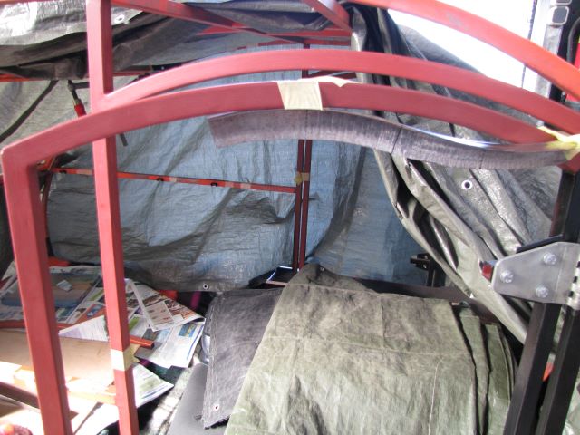

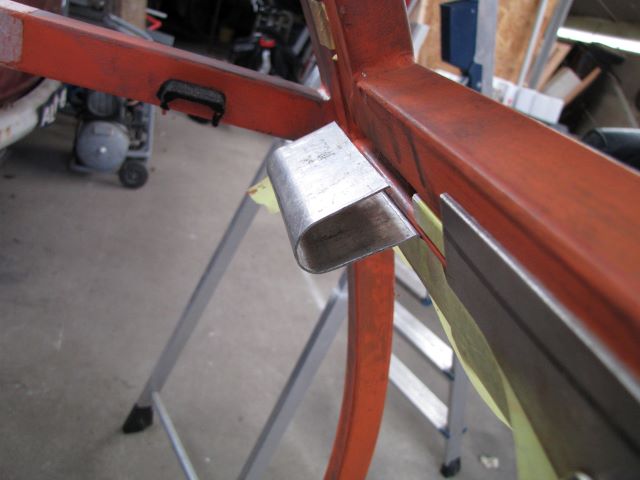

Postby smeerkees » Sun May 12, 2024 4:43 pm

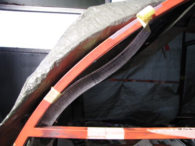

So, how much did i bend the metal piece approximately?
Well, more than enough for my project.
I taped the sample piece on the sharpest bends of my project, (the sides of the hatch, and the top of the doors) and as you can see, more than enough.
Thats it for today.
Next side project is how to make a slider/giding system for my anglegrinder to make realy straight cuts on a big piece of sheetmetal.
Greetz from the Netherlands, Kees. 8)
IMG_2886 verkleind voor tnttt.jpg (46.67 KiB) Viewed 1941 times
IMG_2892 verkleind voor tnttt.jpg (62.17 KiB) Viewed 1941 times
