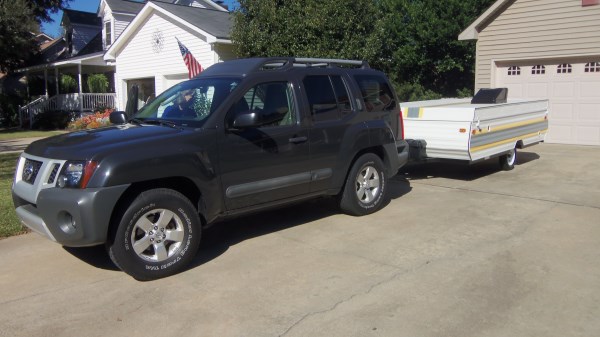

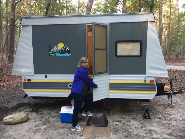

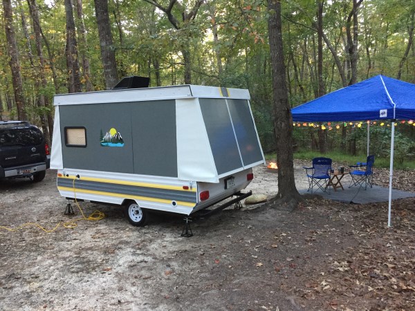

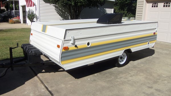

The weather finally cooled enough to take QBOW (Queen Bed on Wheels) on its maiden voyage. Yes, we had to name it so I "borrowed" an idea from another member here. With the new Dexter axle, the trailer towed like it wasn't even there and I could see over it while towing (one of my initial criteria). Set up time with the portable hard walls takes a little longer than the weekender but well worth it to me. Everything worked exactly as planned with only some very minor lessons learned. The biggest issue was the movement of my stacked walls while driving. I thought they were heavy enough to stay in place without bracing but they moved slightly forward during the trip to the campground (nothing damaged). A simple fix on the return trip was to store some of the larger containers between the stacked wall panels and the dinette seats to fully wedge the stacked panels in place. The rest of the lessons learned simply involved how to better store our gear in the available spaces within the camper for towing and setting up camp. I loved my little weekender but being able to stand up and having a port-a-potty indoors plus the indoor galley is lots more convenient.
TV hooked up. Ready for maiden voyage.
Ready to roll.

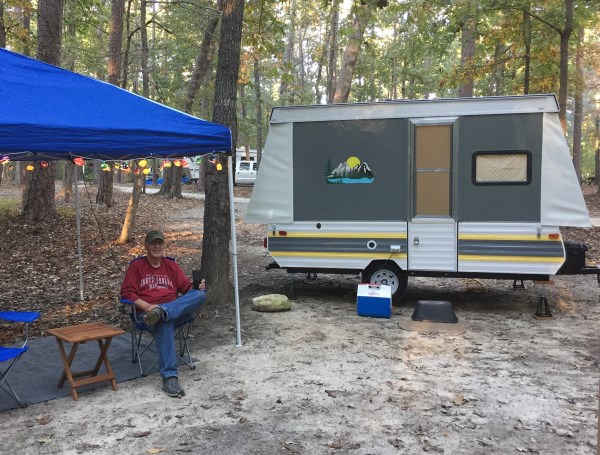

All set up and ready for that first beer.

Rear angle view. The white line in the center of the rear walls is actually gym floor tape that covers the crack between the two panels. I found it much easier to use the tape than to devise a seal in this area. The tape peeled off with no problem when we broke down camp. One roll ($8.00) will last for about ten trips.

Very nice job on this conversion. :thumbsup: I like the picture on the sides it's a nice touch. Did you paint it or is it a sticker.

ELM wrote:Very nice job on this conversion. :thumbsup: I like the picture on the sides it's a nice touch. Did you paint it or is it a sticker.
It's a decal that I got on Ebay. It looked kind of plain on the outside without something to jazz it up. Judy is looking for decals for the inside walls now. She thinks it is too plain. Can't hang anything on the walls since they have to stack while driving.

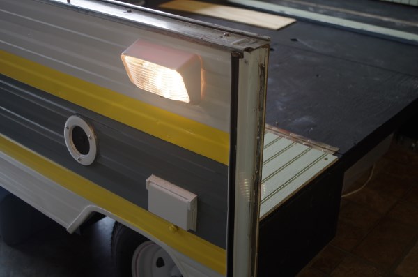

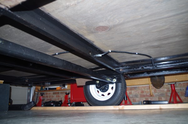

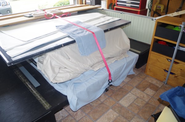

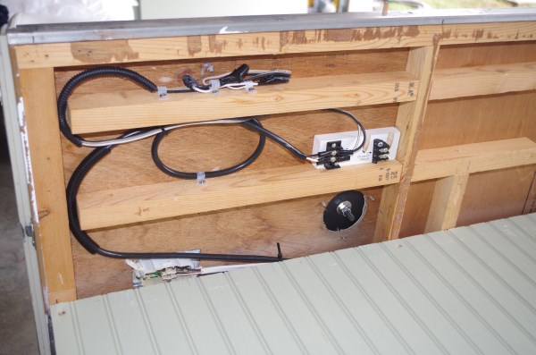

The only notable issue I had with our first camp was the stacked walls moving around during transit. I thought they would stay in place under their own weight but they shifted forward about a foot but caused no damage. My fix for that was the installation of D-rings front and rear to catch a ratchet strap that would fasten down the middle of the load. The stacked walls are pretty well wedged in from side to side with bedding, chairs, and other gear. While I was at it, I decided to add a porch light. Because it would have been a little complicated running the wires in the roof section, I decided to go under the trailer and run them to a location near the door in the wall of the bottom shell. I re-purposed an old three wire 14 ga cord that came off an old electric power washer and used two of the three wires. I was able to run it under the trailer through all of the old holes that the propane system ran in on the original pop-up. I used plastic cable clamps and 1/2" silicone tubing as conduit through each hole and filled it with silicone to keep it in place. In my original planning, I installed my interior bead board paneling with screws so it was easy to remove the section I needed for access to install the new wiring.
Two D-rings and a ratchet strap will keep the stacked walls from moving forward (hopefully). I use a lot of old sheets, towels, and styrofoam strips to keep the panels separated as they have latches, handles, hinges, and window frames that can damage the paint if allowed to rub together.
Wiring to the new porch light ran easily under the frame through the holes where the old propane piping had been on the original pop-up.
I left a lot of slack and ran the DC wires through a small terminal block in case I want to run additional DC fixtures later. Using screws to fasten the interior bead board paneling made it really easy to access the space.

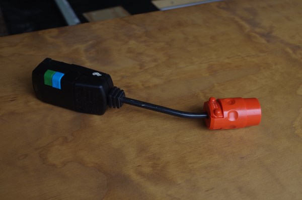

One side benefit of using the old power washer cord was the GFCI plug that came with it. After cutting it off, I simply added a female plug and I now have a portable GFCI that I will keep in the camper in case I need one.
I used a standard porch light purchased on Amazon with an outside switch. I think having it down low and pointed down will be perfect lighting for what we will need. Still need to caulk and paint around the light.
