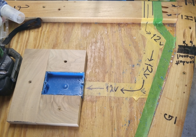

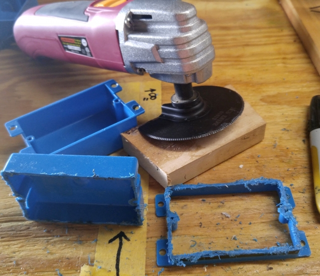

Meanwhile, I'm grappling with another (probably stupid) electrical question, which is whether or not to put plastic boxes behind my light fixtures.
I played around with one today, and if I use my cheapola vibro-tool from Harbor Freight, I can cut it down to a height that fits my walls. I blocked one in just to see what I think. It's clearly doable, but is it worth the trouble? I mean, what are those boxes really for, anyway? Fire protection? Because the open face will be covered by wood, so how much protection can they offer?
Here it is held in place by scrap blocks, which is what I'll be screwing the light fixture into (the screwholes on the fixture, interestingly, are j-u-s-t wider than than the blue box).

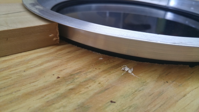

I also cut out my first window hole today, which made me exceedingly nervous.

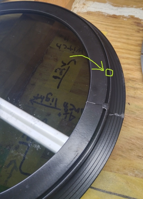

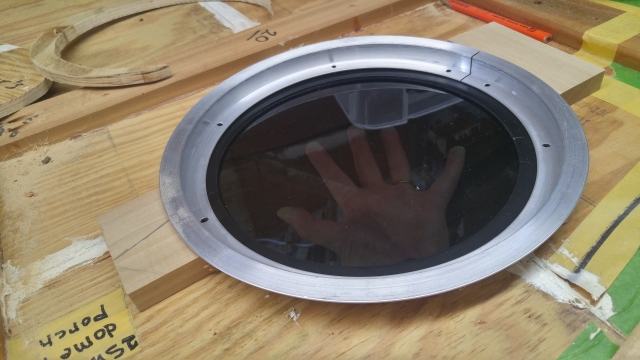

Went fine, except that I'm not 100% sure how the things are supposed to assemble. When I fit it all together, the metal rim didn't sit flat on the skin--it was slightly above. And when I install my interior skin, it will be even higher. Is this a problem? Or should I just plan on slapping sealant every-which-where to bind it all together?
See? Not perfectly flush:
Here's a birdseye view. The creepy hand under the window is mine, holding it place. Not, as you might suppose, some miserable prisoner that I keep chained under my workbench.
I'm also not perfectly confident about what I'll be screwing the metal frame into. The screws are supposed to go into this gap that goes all the way around the window, yes?

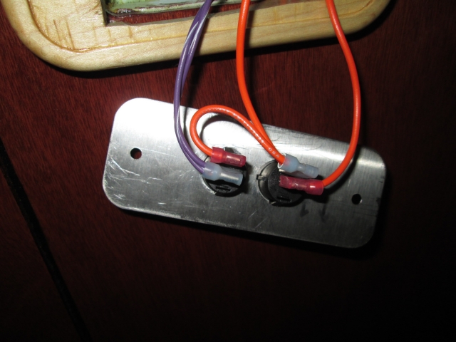

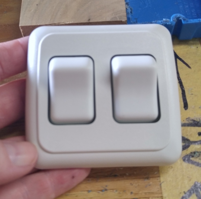

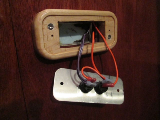

Lastly, I just received my first light switch in the mail, which I'll be using to control the passenger-side porch light and the light over the luggage shelf inside.
Only... it has two small plugs on the back. Why plugs? I was just expecting wires, like on a normal light switch for your house. Does this mean I have to buy some other item to plug into? If so, what?
Electricity! I love you, but you're a pain!!

plectrudis wrote:... it has two small plugs on the back. Why plugs? I was just expecting wires, like on a normal light switch for your house. Does this mean I have to buy some other item to plug into? If so, what?
They're not plugs; they are tabs. Tabs for "spade" connectors. If you have limited space behind your switches you can get 'F' of flag style spade connectors which will help. They provide a little more back clearance than the straight type and you don't have to allow as much room for the wire to train in a radius. They come in different crimp sizes for the different wire gauges and in a couple of different spade/terminal widths.
On the windows, they are probably intended to be used with trim/clamping rings which would be where the screws go. The clamping action of the trim ring, which must be sized for your wall/door thickness, would likely fatten the flange out and take up the gap (that and the putty tape/sealant and/or gasket).

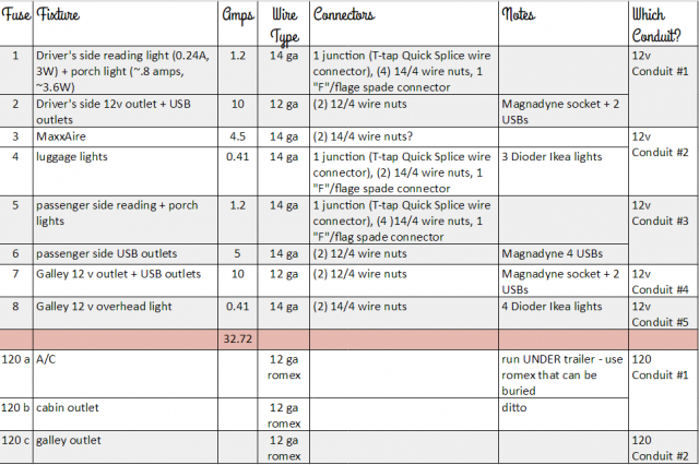

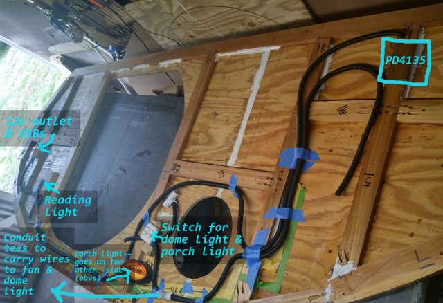

I tried out some 3/8-in "split loom" (conduit), and I think it will work! I've been figuring out how many sets of conduit I'll need to run (two 12v on driver's side; one 12v on passenger's side, one 120 AC under the floor, and one 120 AC in the galley). Also, making sure the various tees don't run over one another.
Here's where we are, mocked in place with masking tape, the Hesitant Teardropper's Best Friend:
And here are the actual figures:

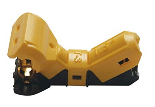

There are 3 places where I need to tee off a wire to run a couple of fixtures in parallel. I'm thinking of using these connectors to make the tees. Does that seem... okay? I like that it looks tidier than wire nuts.
https://www.amazon.com/Electrical-Connectors-T-tap-Splice-Stripping/dp/B01M6E4WSS/ref=pd_sbs_60_4?_encoding=UTF8&pd_rd_i=B01M6E4WSS&pd_rd_r=B2EHN0CX8XBP4VM5MH8N&pd_rd_w=5No3d&pd_rd_wg=lG6Qr&refRID=B2EHN0CX8XBP4VM5MH8N&th=1

Postby KCStudly » Sun May 21, 2017 9:25 pm
plectrudis wrote:Mostly been standing in the garage staring at the prone drivers-side wall, muttering to myself.
Been there, done that, welcome to the club!
T-taps make me cringe. The only place I have ever used those is where they were totally exposed on my UT (The Charcoal Briquette) when I just didn't care about cost, time, or having to do it over again some day soon.
Ditto wire nuts on a moving object where flex is a constant concern. They are not allowed on boats, so why would I use them on my camper where all of the same issues exist (constant flex and water proofing issues)?
Just saying, you have come this far, if you are not willing to learn how to solder and use shrink wrap, then get you some good quality crimp connectors and crimping pliers. (There is a whole 'nuther argument for why soldered joints are not ideal in flex situations, but I won't go into that here; I've used them for many years with no issues. Nuff said.)

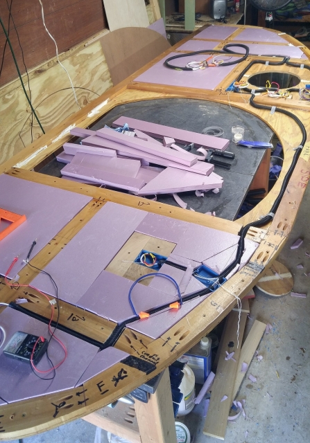

All the wires in the driver's side wall are now run in their conduits, and after thrashing about quite a bit trying to avoid it, I finally caved and soldered some stuff. And now I remember why I had been avoiding soldering--that stuff is crazy ornery. Probably my soldering iron is under-powered, and definitely I'm operating under an epititude deficit, but the upshot is joints that look more like small wads of aluminum foil than like a nice, smooth union of wires. And since these were three-way connections, I couldn't use heat-shrink, so they're solder blobs surrounded by electrical tape blobs. I did test with an ohm meter and they do function, but still. Barf.
I left plenty of spare wire sticking out of every junction and fixture spot, so I can cut the joints out and try something else if looking at my handiwork just makes me too sick. Maybe closed end crimp caps?
On happier news, I acquired a new favorite toy: a label maker that prints on (among other things) heat-shrink tubing! Every wire in my wall is now labeled at both ends. So tidy.
And the driver's side wall is now (almost entirely) insulated. It's starting to looks more wall-ish!
