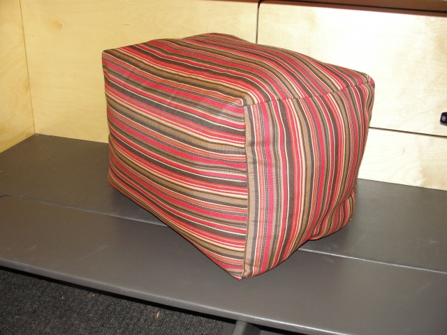

We had enough material left over from the futon to make a storage bag for our comforter. Mary cranked it out pretty quick.
Her initial thoughts on dimensions were a little big. I knew the comforter would scrunch down pretty good since it's filled with Primaloft. She made it 12" x 12" x 18".
Once we placed the bag inside the teardrop cabin, Mary realized it would make a great ottoman...and it does! We move the remaining underfloor storage board to place the ottoman for maximum comfort. Glamping???

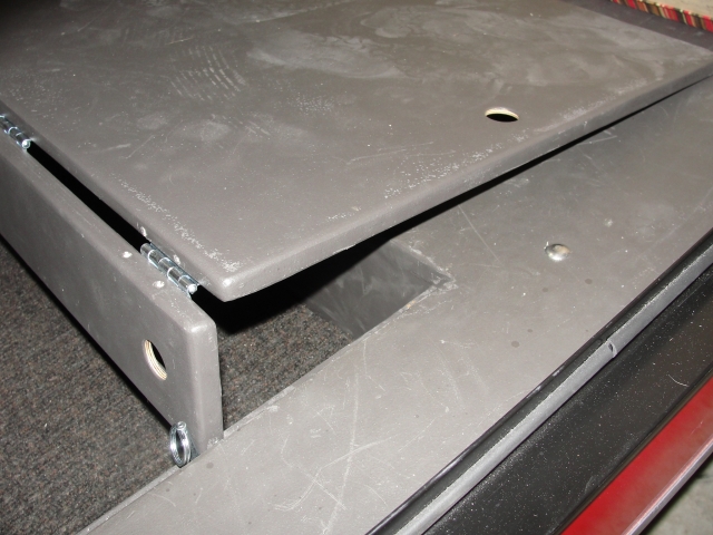

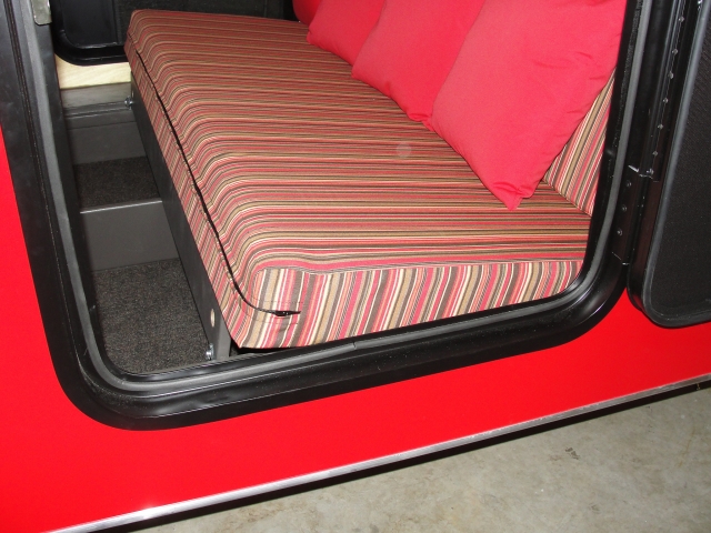

Postby Dusty Mark » Tue Jul 05, 2016 12:12 am

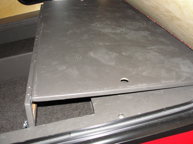

Thanks! Here's a little more detail about our sofa. It uses two of the three sections of the underfloor storage covers as a base. Those two sections are joined together by hinges. The covers are 1/4" Baltic birch with 1/2" Baltic birch stapled and glued around the edges and also additional reinforcement strips for the wider pieces. This keeps them light enough to manage while converting between bed and sofa mode.
The short section which elevates your legs is 4" deep and the section you actually sit on is 21.5" deep. I insert a pin in front of the frame on each side to keep it from sliding forward and collapsing. A cleat with a dowel might work and look better, but I'm starting with the metal pin. I haven't seen a need to restrain the frame from rearward movement since the plywood base of the cushion is 25" and it contacts the floor solidly.
I leave the underfloor storage divider in to support the pieces in the middle.
Converting from bed to sofa involves folding the hinged pieces and moving/sliding them to the headboard area. I then lift the bottom cushion up and slide the underfloor storage covers in place. This can be done solo, but it's easier with two people. The hinged cushion that forms the backrest rests against the headboard area. The free cushion, which is normally the foot piece of the mattress becomes the cushion your back actually rests on.
I think the sofa is going to be a "game changer" for comfort. If you need more pictures or explanation, let me know. I hope this helps...

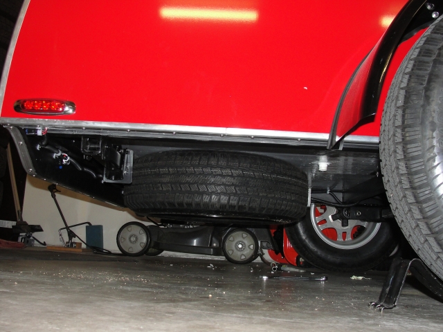

Spare Tire Holder

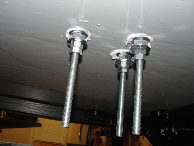

Postby Dusty Mark » Tue Jul 05, 2016 12:29 am

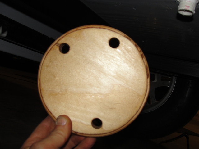

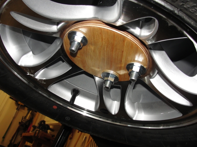

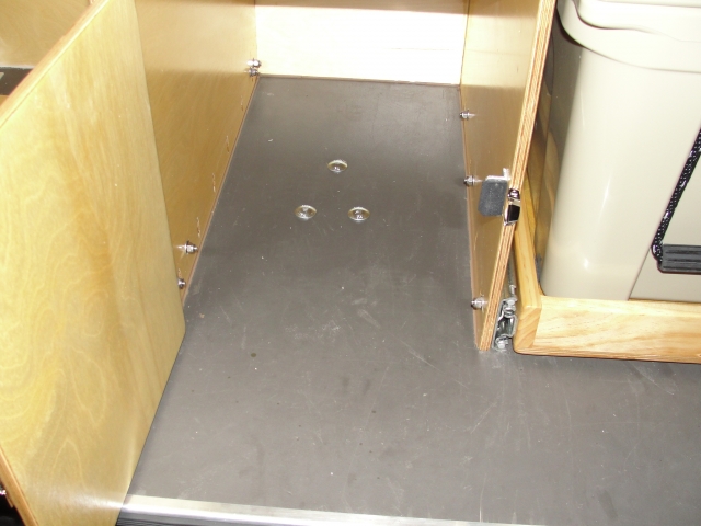

A good friend and I were surveying the teardrop and he suggested there was room for the spare under the galley. He was right!
I used three 1/2" carriage bolts and drove them through the lower galley cupboard floor.
The bolts weren't threaded quite far enough, so I used a bigger nut as a spacer. The nibs in the elastomeric paint are from a disintegrating roller. You're the only ones who will see that!
I made a disc from scrap 3/4" Baltic birch to protect my rim from the washers. I coated it liberally with CPES.
It's tricky getting the tire mounted, but it comes off real easy! I'll replace the plain nuts with lock nuts tomorrow.
I've got 8" of clearance with the full-size spare mounted. I'm sure that will be enough, but if I'm wrong I can move the spare back to the car and cut the bolts flush with the nuts. (Nothing ventured, nothing gained.) Another plus is that it reduced my tongue weight!

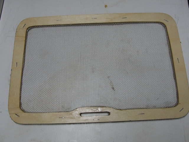

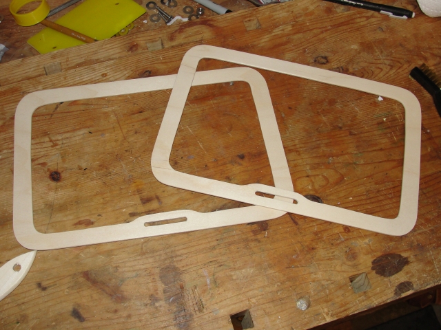

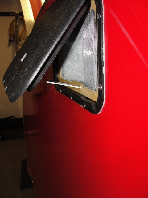

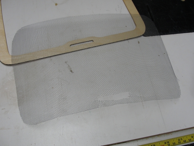

Postby Dusty Mark » Tue Jul 05, 2016 2:04 pm
The little details "kill" you as you try to finish up a build. I have a large marine hatch on the passenger's side to supply fresh air for the air conditioner. That's an entry point for bugs. I decided to make a friction fit screen and also a prop to hold the hatch open during AC operations.
Frames were fabricated from scrap 3mm plywood from the ceiling/roof to sandwich screen material. I experimented with the first one until I had a "good enough" fit and traced the second one. A liberal coat of CPES was applied before assembly.
The screen and prop slot were cut prior to assembly.
A liberal coat of polyurethane construction adhesive was applied before stapling with 1/4" staples from the back side. The staple tips popped through a little on the front side, but not enough to be a problem.
The prop is made from 1/8" thick aluminum and is designed to wedge into the AC side venting and the ribbing of the hatch.
It looks like everything should hold well in the winds without any additional fastening. I'll paint the screen frame black once the glue sets up better.

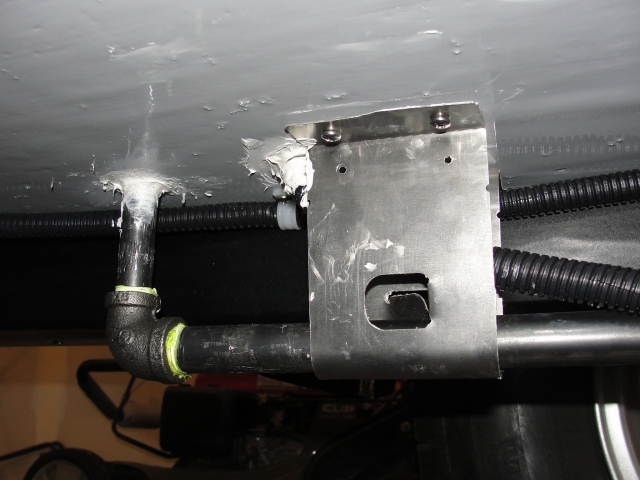

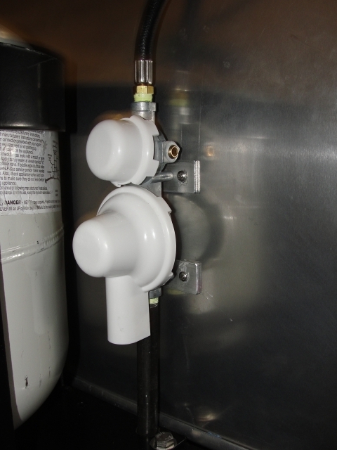

Propane System Plumbed

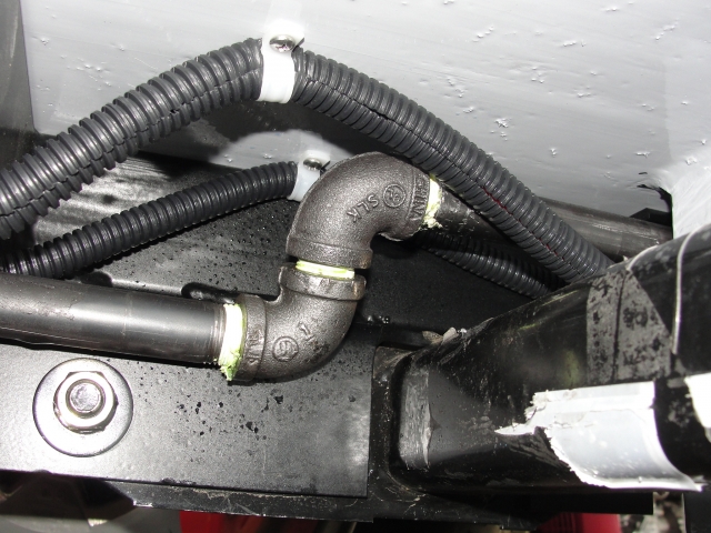

Postby Dusty Mark » Wed Jul 06, 2016 2:50 pm

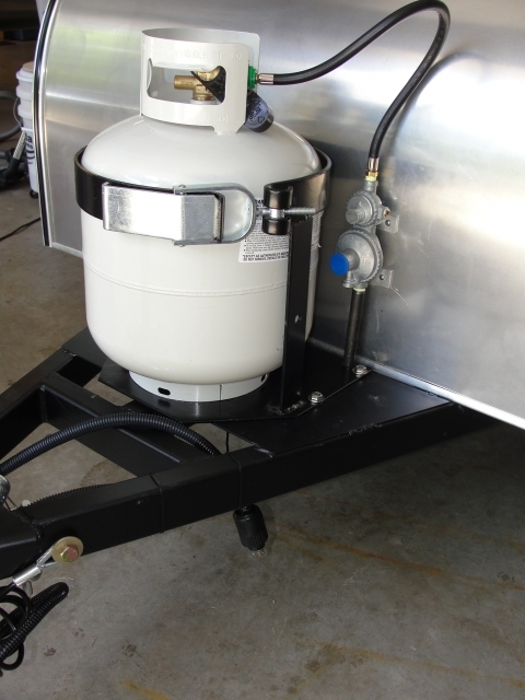

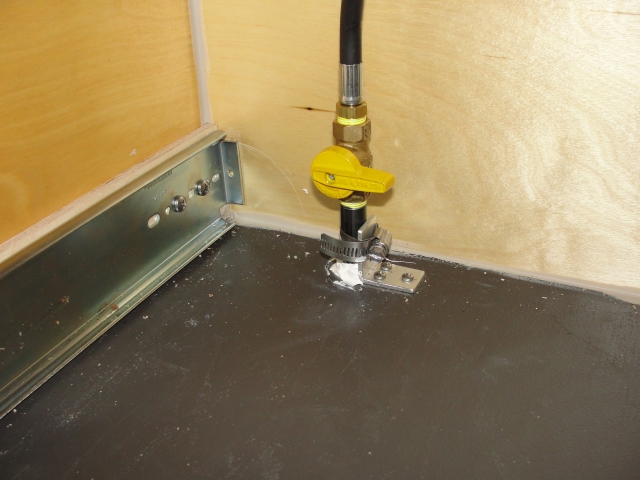

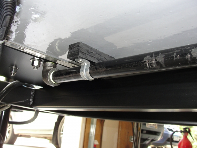

I plumbed the propane system plumbed last week, but didn't post about it until I had it free of leaks. On my first attempt, I stripped the regulator while installing the hose from the tank to the regulator. That was the only joint that leaked when I sprayed leak detector on every joint. Since the regulator is mounted tight against the front storage module, that meant I had to drop all the pipes to replace the regulator and supply hose...ouch! I replaced the stripped components this morning. The system is leak free and the oven and stove work great.
I bought the propane stand on e-Bay. The tank is a 20 pounder. The regulator is a Camco vertical two-stage.
Seeing the previous picture reminded me to go out and re-install the protective plastic covers on the regulator! The output is 3/8" black pipe. The brackets are pieces of 1/8" aluminum stock that is screwed to the regulator via it's pre-threaded mount holes. This provided a secure means to screw the regulator to the front storage module.
While framing the storage module, I pre-positioned a 3/4" thick piece of wood in the front wall to provide a place to securely screw in the regulator.
This elbow transitions the system from 3/8" to 1/2" just under the regulator. I couldn't find long lengths of 3/8" black pipe locally, so I was forced to use 1/2" black pipe under the trailer. The support blocks are UHMW plastic that won't rot.
This is the leading edge of the underfloor storage. It was a convenient place to change direction and work closer to the floor.
The pipe routes over the axle and then back under the next frame crossmember.
This aluminum bracket from Oregon Trail'r is pretty handy. The pipe goes through the galley floor to the back side of the stove. The elbow transitions from 1/2" back to 3/8".
It makes good sense to have a shut-off valve at both ends of the system. The simple bracket and hose clamp hold the pipe solidly.

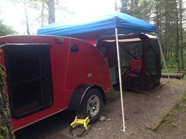

Put it to Use!
Postby Dusty Mark » Wed Jul 13, 2016 1:48 pm

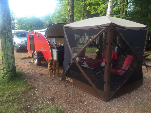

Mary and I have camped in our teardrop twice now and really like it.
Our first trip was two nights at Little Sand Bay Campground on the Apostle Islands National Lakeshore in WI. We combined camping with sea kayaking. The kennel system and vent worked well for Copper to be secure and comfortable back at camp for a little while as we paddled.
We really like how easily the Clam 6' by 6' screen house sets up. Our plan is to fabricate a tunnel that connects the teardrop galley to the screen house. I'll be ordering material for that tomorrow.
I made Mary a quesadilla for our first meal from the galley. She liked it...
Mary prepping ingredients for stir fry. Our mini wok worked well. However, we need to make some wind screens from scrap aluminum to keep the wind from robbing all the heat.
Copper likes to be near us, so the area under the table is a good spot for him. We'll bring his outdoor pad next time.
Copper probably did about 30 retrieves in Lake Superior over the course of two days. He was tired after all that swimming.
On the way home from the first trip we stopped at Cornucopia, WI and bought some locally smoked lake trout and smoked Gouda cheese. We set up at a wayside rest along Lake Superior and made some quesadillas.
We gave a lot of tours of the teardrop at that stop!
We've had 30 mph winds up here and are finding that the camper tows super stable. There is no sway and the winds don't even make it wander. Our Subaru Forester with a manual transmission tows the 1,700 pound load well. I need to build spacers to raise the A-frame jack about 1.5". It rides dangerously close to the road. I'll start that modification today.
Our second trip was two nights and called for heavy rains, so we brought the EZ-Up canopy. It worked well to keep us dry while working in the galley. I do have a small leak in the hurricane hinge that wets the upper galley shelf. I'll start by caulking that to see if I can stop it without removing the hinge entirely.
The Clam screen house did well at keeping the bugs out at a buggy campsite at Cadotte Lake in the Superior National Forest in northern MN.
