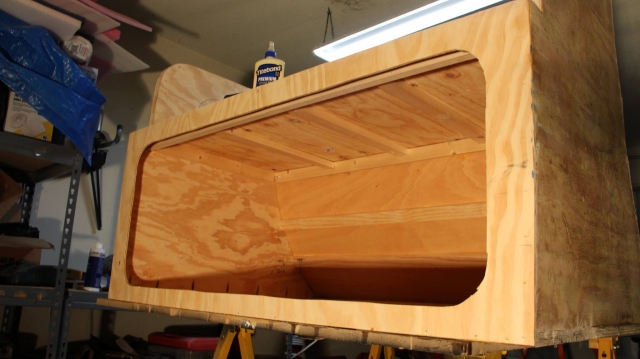

Looking nice. That's some very interesting grain on that piece of plywood.
My Build journal. viewtopic.php?f=50&t=65395
ELM
Posts: 277
Images: 176
Joined: Thu Nov 26, 2015 5:49 am
Location: Sutter Creek CA
Re: Off Road Grumman 2 (5x5x10) Build
Postby DWT77 » Sat Dec 16, 2017 10:10 pm
ELM wrote:Looking nice. That's some very interesting grain on that piece of plywood.

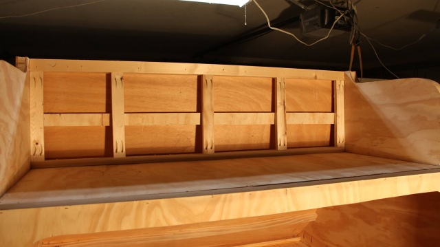

That is the bendy plywood that has all of the grain going in the same direction. I used it for my ceiling as well. I used the mix on my ceiling and I liked the way it came out with showing the grain.

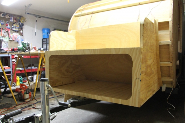

Postby DWT77 » Sat Dec 16, 2017 10:15 pm

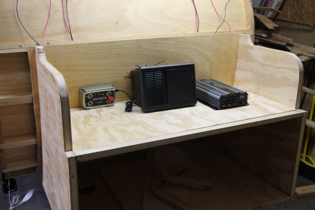

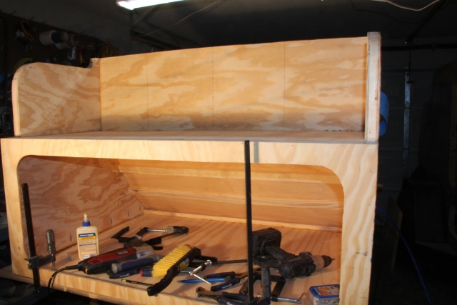

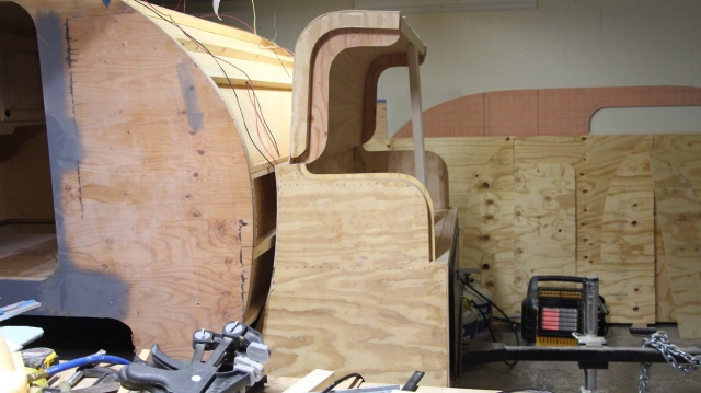

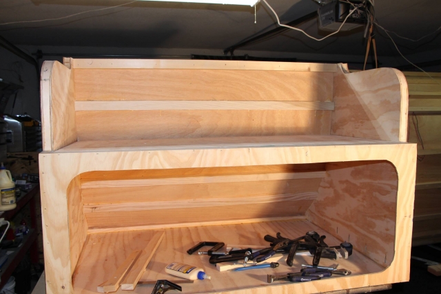

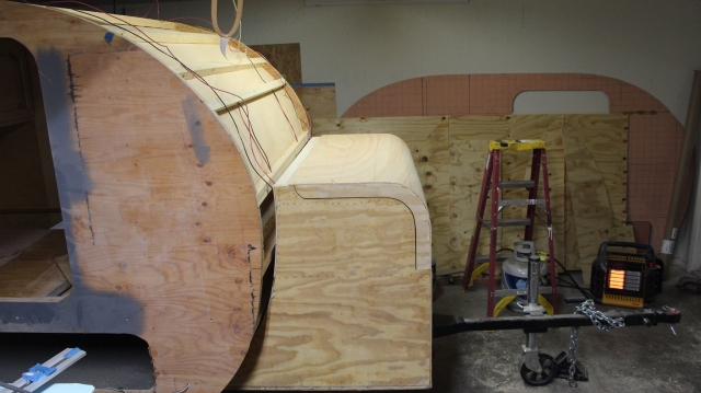

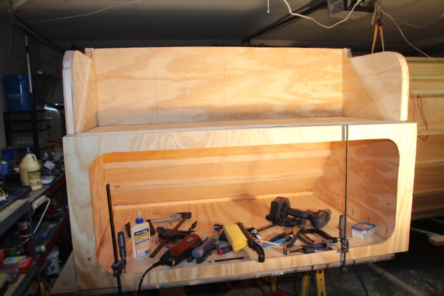

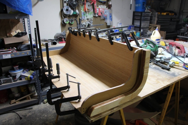

I made my tongue box into two sections. The top will house all of my electronics and the bottom I can store a generator, A/C, or other bigger items.

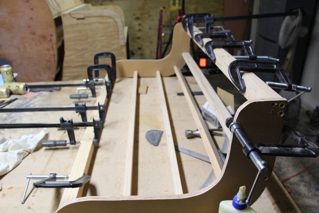

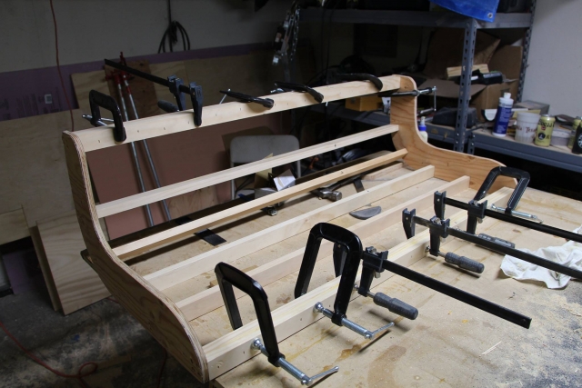

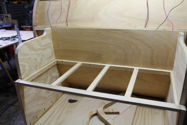

Postby DWT77 » Sat Dec 23, 2017 7:20 pm

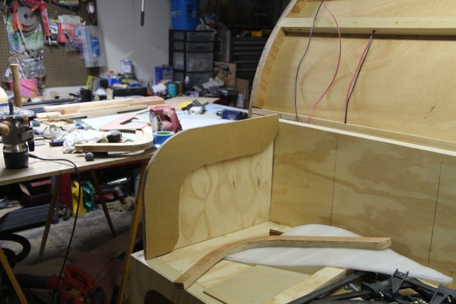

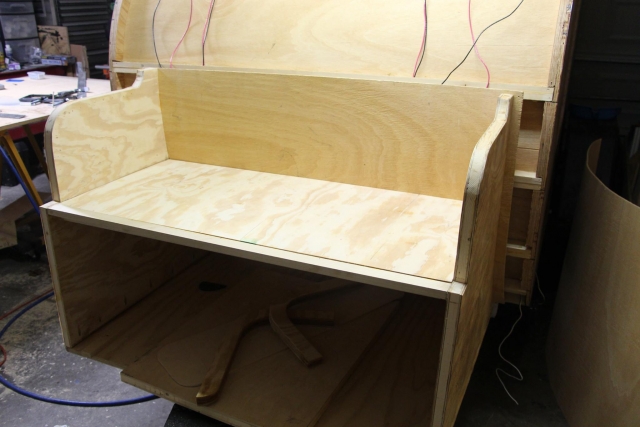

Back to work on the tongue box today. It's turning out to take longer than I thought it would lol. I added some additional spars for support. Then I framed up the top section. I thought it would give it a cleaner look plus it gives me some space to hide extra wiring in case I ever need to do any maintenance.

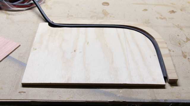

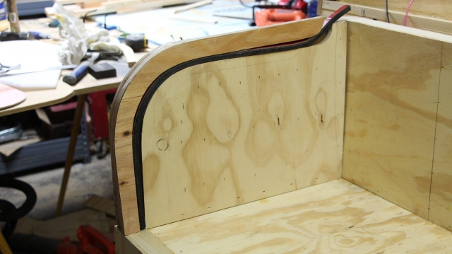

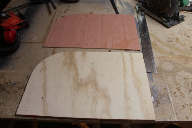

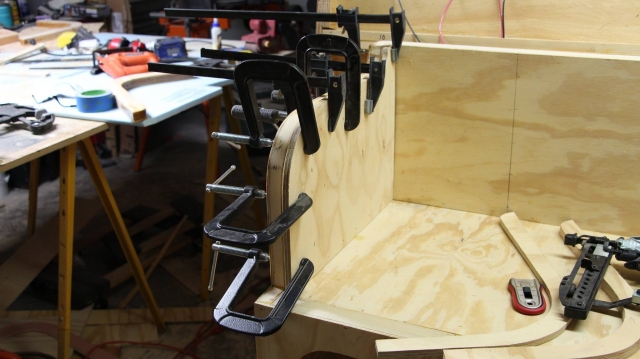

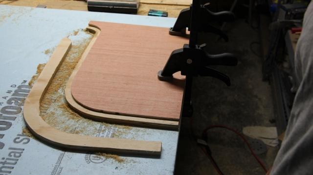

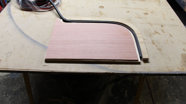

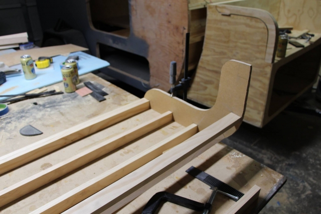

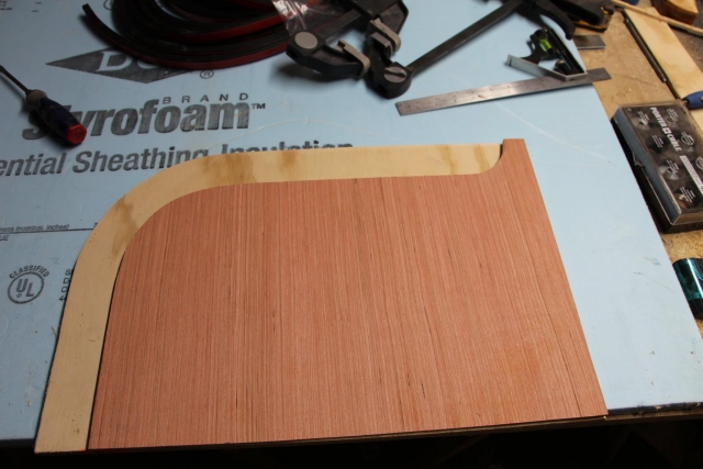

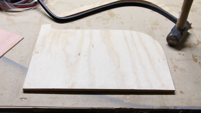

I am making the hatch for the tongue box the same way as the galley hatch (Steve Frederick's method). So this is good practice when it comes time for the galley hatch.
I cut my 1/8" spacer and 1/2" off set for the seal
This is the 1/8" thickness and 1/2" thickness offset pieces
The two pieces laid on top of each other
Cutting the piece out that will eventually end up being the template for the 3/4" piece the seal will attach to (Note the 1/2" offset between the two pieces)

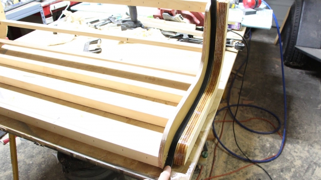

A few examples of how the seal will lay in the hatch
Example of how the seal attaches to the 3/4" piece and opens with the lid
Gluing the 1/8" and 1/2" piece to the tongue box side wall

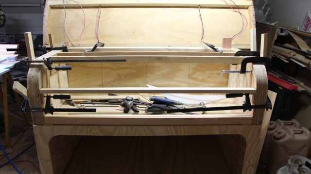

Postby DWT77 » Sun Dec 31, 2017 10:07 pm

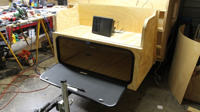

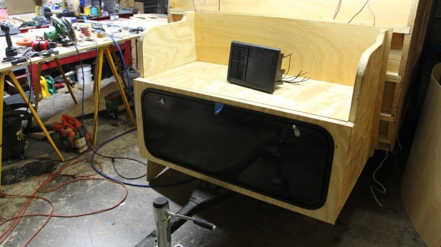

Working on the tongue box hatch/lid. Got the gusset cut, spars cut and screwed in/lined up. Next up is lining the interior with the bendy plywood

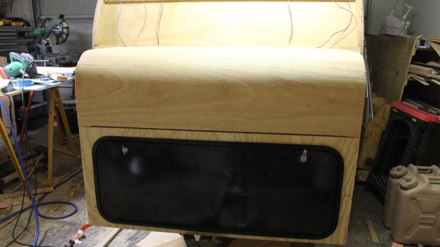

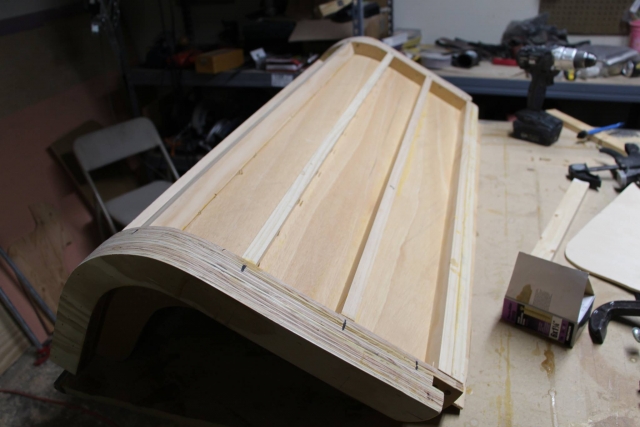

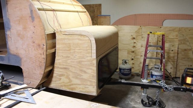

Postby DWT77 » Fri Jan 05, 2018 9:10 pm

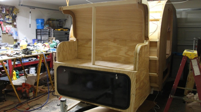

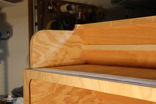

Got the interior and exterior of the tongue box hatch/lid skinned.
