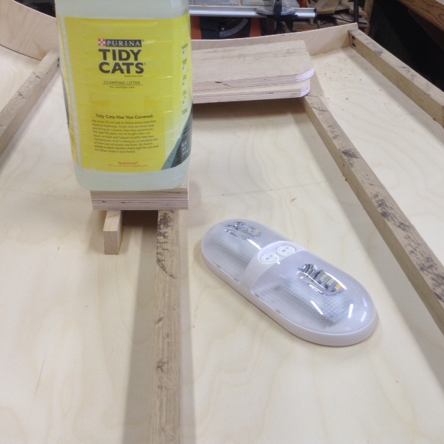

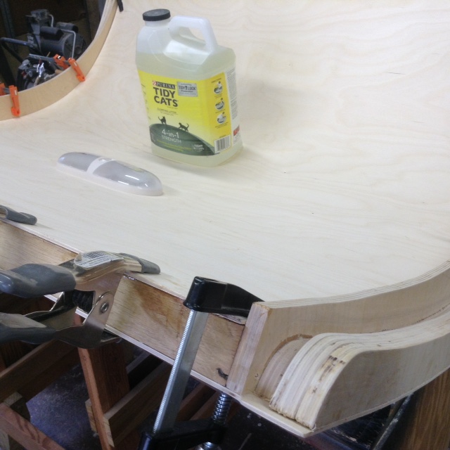

Hatch inner skin ... Done. I really hope this hatch still fits when I put it back on the galley tomorrow.
Galley light fixture blocking
Glued and clamped

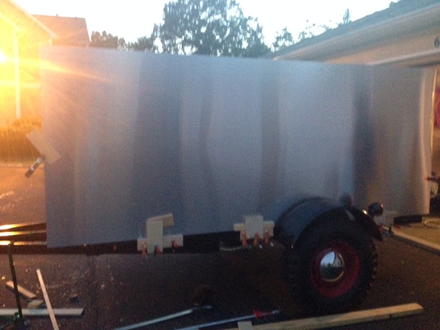

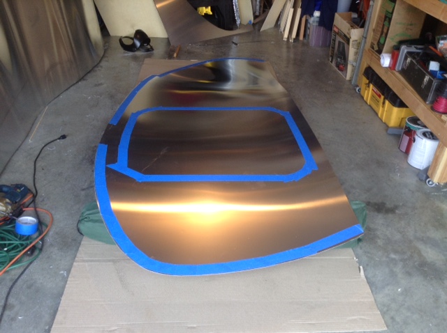

Today was Aluminum Day 8)

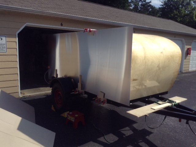

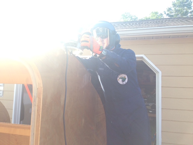

Reyerson messed up my order, so I found semi trailer shop that was willing to cut a 20' long piece of .040 mill finish aluminum off a spool for me. No protective film. It has a light scratch he and there, but, like I said ... this is Aluminum Day. So I bought and got started. The router bit kept clogging while trying to trim the roof piece :x. I'm going to try to cut the walls tomorrow without that hot chip slinging, aluminum melting, infernal contraption. Router speed, worn out bit, or bad technique? I don't know, maybe all of the above :roll:
The aluminum trim hasn't arrived yet.
Aluminum bending
Dry fitting the top
Trimming with router

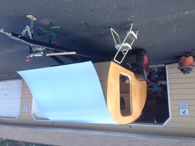

Postby kokomoto » Fri Jun 16, 2017 9:34 pm

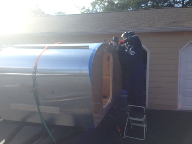

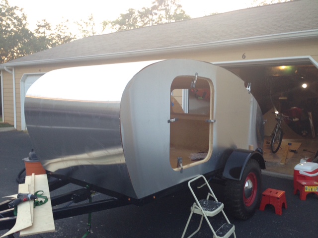

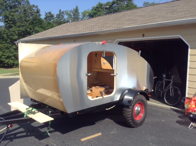

Aluminum skinning
The galley...so far
Port side started

Believe it or not, kerosene makes a very good cutting lubricant for aluminum.

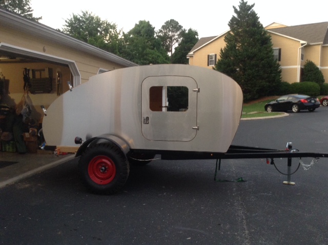

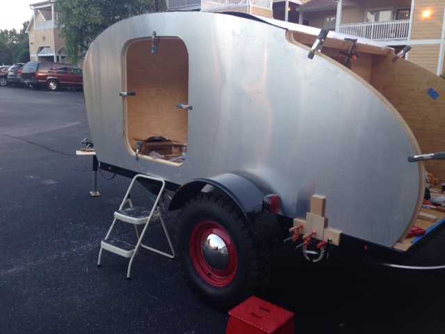

Starboard door mounted on hinges tonight.
Starboard door

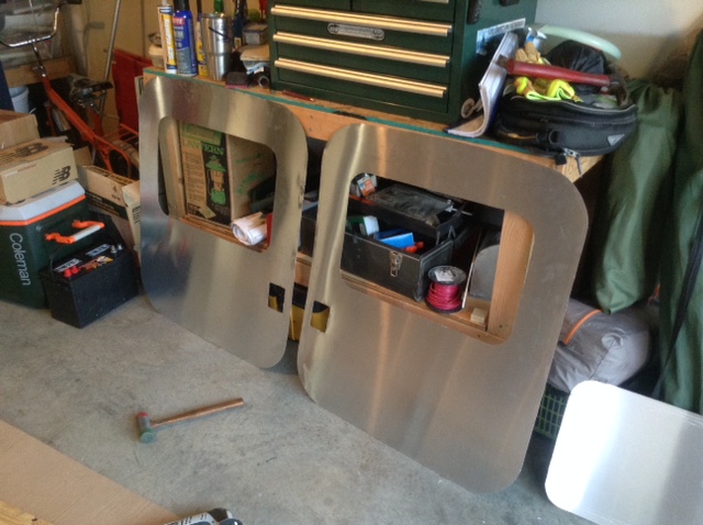

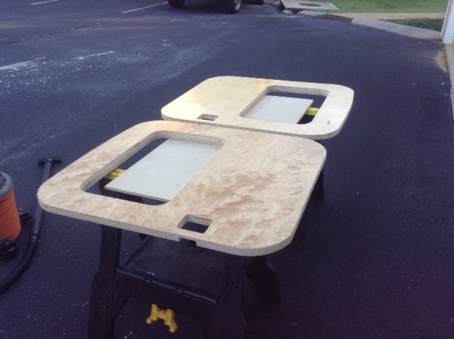

p.s. How'd you cut your doors out? Router and template? They sure look good.
Re: Off-road Teardrop Design/Build
Postby kokomoto » Thu Jun 22, 2017 12:23 pm
tony.latham wrote:That thing looks FAST!
Zero spring-back, right? There's a reason for those gussets.
T
Thanks Tony!
Yep, I hope my gussets keep on gusseting. :lol:
I didn't do a good job of keeping the door openings identical, very close they are, but not identical. Each door opening was traced onto a sheet of 1/4" ply, and cut it with a jigsaw on the fat side. Still didn't fit the door opening perfectly, so I carefully sanded it down so that it fit like a glove. I then marked it short 1/4" all the way around, and cut it with a jigsaw. I used that piece as a pattern to cut the 3/4" plywood with a router/pattern bit. Then I put the inner and outer 1/4" plywood on the 3/4" plywood, and trimmed those down flush with the router. :oops: I'm still not sure what will happen when I get the "T" molding on them, and see how well they seal. I was studying the ATMA build with similar door, and discovered that he had to trim the "T" molding to get a bend around the corners. He also had to add a 1/8" spacer under the hinges to obtain a good seal. I also ordered a small RAKA kit with gray pigment to seal around the door opening.
I could have saved a whole lot of work by carefully cutting the darn door openings out with a jigsaw when I built the walls. That and going the extra mile to cut the door openings in the walls using some method that would result in them being perfectly identical.
