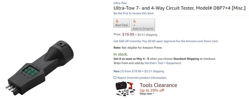

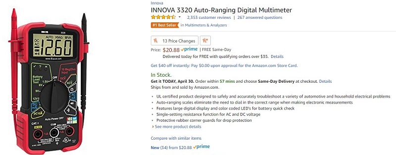

  • Usually, trailer adapters have to be checked for corresponding circuitry, wire to wire. The pins may not be transferring power to the particular circuit that you assume it will. There seems to be no standard followed, manufacturer to manufacturer, in the US; I've had to re-wire many adapters to work on various tow vehicle/trailer combinations, using both testers and multimeters (with long test lead extensions), one circuit at a time.
  • It's not so bad now; I've not had to re-wire any molded/sealed adapters lately, but in the past, before factory trailer hitch/wiring became common, it was a very frequent thing to have the trailer circuits screwed up by the installer.
  • I'm not sure I can diagnose the problem in your situation,; perhaps your Suburban has a loose connection at the bumper (my '04 2500 HD pickup did), or similarly on the controller (my '98 GMC did)>>>both were causing dead shorts. Get a tester, a multimeter, long test leads, and your son to help...I'm sure you can locate the problem, or take it to a trailer hitch installer, or a U-Haul center...they usually have expensive testers there that can identify the problem quickly, or have employees that have seen it all before.... Good luck.

Great advice and tools! Short a very high chance. To drain the battery so quickly. Also a hint. No fuses blown? No fire, hot wires? Melted wiring? A simple check suggested by Working on it will find it. REMEMBER: The bulbs usually complete a circuit. Causing a ground to show up, (at least in the old bulb days).
This will be solved and you will be camping soon!
