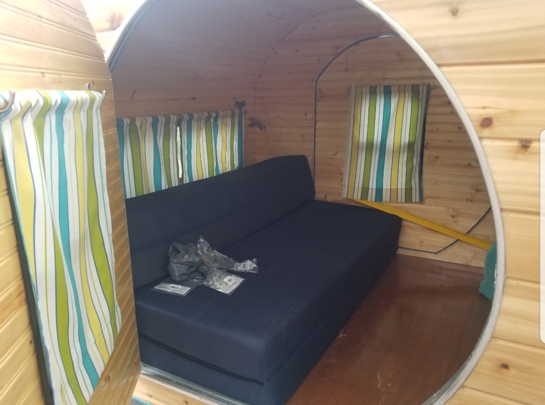

Thanks!! I recently made some curtains for it and we got those up. We plan to start working more on the galley soon, but we have been busy with yard work and building a raised garden box.
Curtains

Postby TimC » Wed May 27, 2020 2:42 pm
Where did you guys source the Foldy mattress/couch? Something I'd like to do in the future.

Postby nicoleandkyle » Wed May 27, 2020 2:50 pm
Hi Tim- here is the link for the mattress we use. It's really great to be able to do both!!
https://www.amazon.com/gp/aw/d/B00NB2NP ... asin_title
