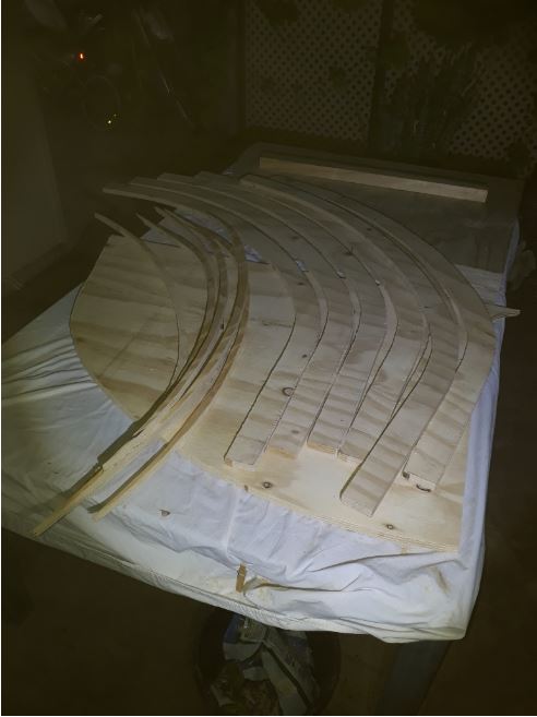

Made ribs.
I made a template to make a template.
I used the stapler to stick enough off cuts of 7mm ply together to get a piece I could stand up in the galley and scribe the profile of the left side wall.
Cut it out with a jigsaw, and used that to mark my 17mm sheet.
Cut that a little proud of the line.
Marked a heap of spots 55mm in from the first line, knocked in a heap of small nails, bent an off cut of 3mm around the curve and scribed the inner line.
So the cross section of my ribs will be approximately 55 x 17.
So I cut along the inner curve, and got myself a rib.
I clamped this back onto the side or the trailer, and used a trimmer bit in the router to trim exactly to the shape of the side wall.
By the time I finished that I had a rib that fitted perfectly alongside the rear radius(es).
So I used that to cut out 6 more ribs. Traced around my template rib, and roughed 'em out with the jigsaw.
Then I cooked dinner for the missus when she got home from work.
Tomorrow I will screw the template rib to each of the others in turn, and use the router again to trim them all the same.

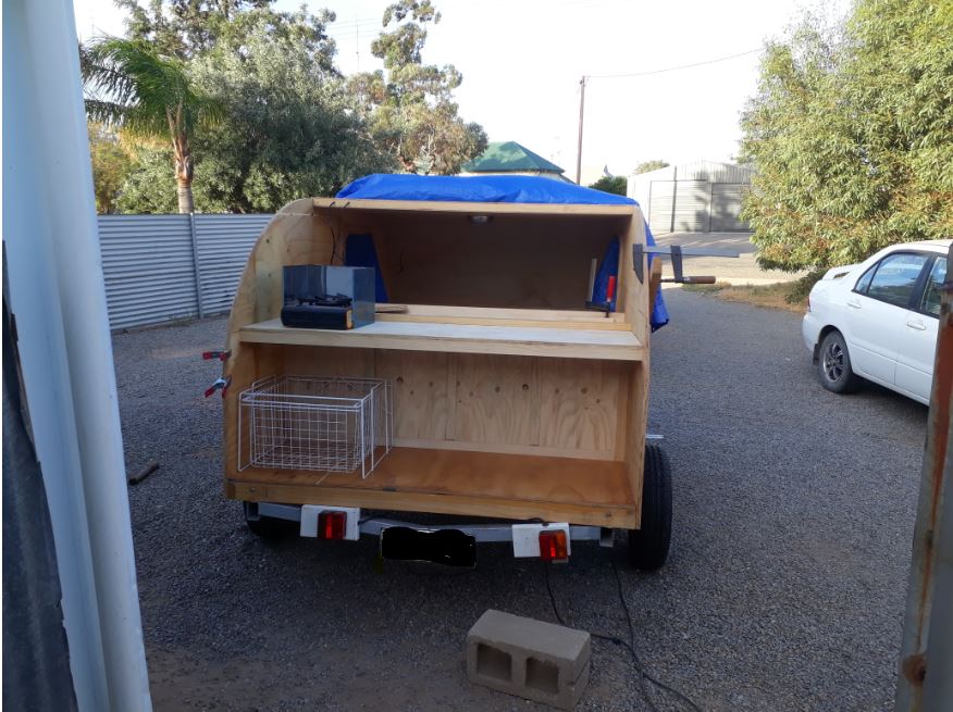

Advances this day.
Fitted the lower bulkhead/foot board, and installed the counter top.
The lower foot board is 7mm plywood, with three "stiffeners" attached to the galley side.
Pretty happy with the accuracy of the fit, and the way we are managing to pull everything straight as we go.
The 7mm ply I am using is actually made for the job of bracing frames square.
The 15mm ply I used for the counter is very strong
My electrical contractor son was installing GPO's in a home where they were pulling out a melamine laundry cupboard due to some white ant damage.
There was a stack of salvageable panels that he uses for installing load centres in shed wiring jobs.
There was also a couple of these sliding wire basket things. There is room for one under the counter on the left side, with a slide out for the stove between it and the counter.
The other two thirds has room for battery, fridge and water. Looks like I'll be able put some sort of drawer or slide out counter under the right side as well.
