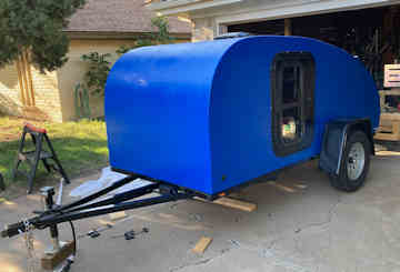

Friday was a big day. It started walking through the process to register the drop. We went over to the TxDOT office and clarified the requirements for getting a VIN number which included getting three forms necessary to fill out. What's the Government without lots of paper. We also drove down to Palo Duro Canyon State Park and verified that I could park my teardrop in/at a tent site. The day finished with the cabin moving off the wood and on to the metal. First we jacked up the front and placed a couple of 1 inch PVC pipes under the front of the cabin. Once on the pipes, the cabin rolled along nicely. Here is the cabin moving along over the chassis.
20210827_181402 Small.jpg (34.68 KiB) Viewed 1217 times

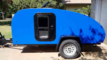

I'm not sure why but the wood build stand was a couple inches higher than the chassis. I don't know if it was an angle exaggeration or if something is dimensionally different. The fenders are covered with some practice scraps from when my wife started quilting to protect the cabin and especially the doors. The doors turned out to be a tight fit sliding past the fenders. If you have the ability to build the whole thing in a shop or garage, I would wait to add the manufactured doors until the cabin is on the chassis. Anyhow, the cabin pushed out over the chassis until it reached the balance point and tipped over. We had another piece of pipe to catch the cabin. It continued a little further when we needed to raise the nose to place another pipe under it. Everything continued along until we got to the end of the wood stand. My son realized that if we continued further, the cabin would fall the couple inches to the frame and possibly damage something. We jacked up the back end, rolled the stand out of the way and lowered the cabin down to the chassis. After that, it everything moved along quickly. Everything lined up easily and we lowered it in to place.
13511 Small.jpg (26.89 KiB) Viewed 1217 times
20210828_114433 Small.jpg (34.6 KiB) Viewed 1217 times
The Pipe rollers worked very well the relocation went a lot faster and easier than we thought it would.
Today, I drilled the holes to bolt the cabin down and then put varnish on the holes as well as another coat on the floor of the galley. I also started assembling the stove shelf. Tomorrow, I will bolt the cabin and chassis together, Despite my best efforts, I think all the steel in the chassis is bowed. Some corners appear pretty significant so I get to see how many of the washers will be used between the cabin and the frame to take up the space. I will also wire up the brake light and drag it around the neighborhood. Hopefully, I will have diamond plate Monday for the front and everything is ready to go Wednesday morning. I have to register the trailer Wednesday since I reserved a camping spot at the park today for Thursday. Nothing like deadline :D

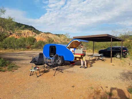

I really need to find out how everyone attaches more than three pictures to a post. I haven't figured it out so here is the continuation of the above post. First, here it is right after we arrived
20210902_173159 small.jpg (37.16 KiB) Viewed 1117 times
A nice sunny day after a rainy morning. I'm glad I asked about putting a teardrop in the tent sites because it all worked out fine. This site allowed me to pull around so I did not have to try to back it in. A good thing, since backing the trailer is a skill that needs to be developed further.
The purpose of this trip was to give it a check out prior to heading out for a weekend. Everything pretty much worked flawlessly, except for a couple things.

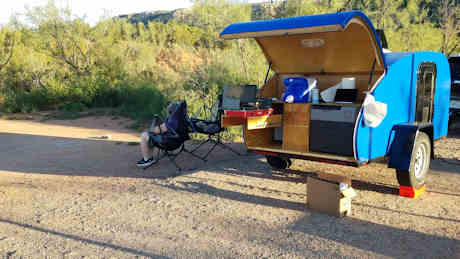

20210902_192107 small.jpg (44.45 KiB) Viewed 1117 times
Those that have read Tony's excellent book may be asking why the water jug is on the counter. It should be conveniently stowed beneath the stove, out of the way. When I pulled the stove shelf out, I also pulled the water jug out and on to the ground. What I think happened is stove shelf got installed with a slant. Since I installed it Wednesday morning, the cabin was on the chassis and not the stand. Hitch ball is pretty high on my vehicle so the trailer was at a slant with the tongue pointing up. I installed the shelf as level as I could but did not realize the trailer itself was not level. As a result, the shelf is slanted down toward the bulkhead resulting in the back side of the shelf cabinet being lower than the top of the water container. Tomorrow, I will level the trailer and try to reset the table and see how it works. Hopefully, I won't have to trim some of the sides and back off the shelf.
The shelf pointing up was actually a good thing since my stove, with the little green bottle attached, stuck off the end of the shelf far enough that the feet for that side were off the shelf. Since the shelf was pointing up, the stove was still fairly close to level. I will have to cut a piece of board to put under that section of the stove to keep it level after all the rework. One last picture of the galley in the morning after breakfast.

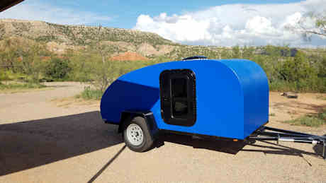

20210903_085659 small.jpg (42.34 KiB) Viewed 1117 times
We have had several inches of rain this week so the trailer has been proven rain tight. Because of the rain, the bugs were terrible after the sun went down. Other than the ones that slipped in when the doors were open, we slept bug free. Unlike the last time we camped, we each woke up happy campers with no aches or pains after a good night's sleep. Other than a few corrections, I think I can call this project done.

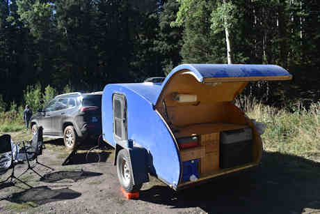

Postby JoeGrz » Sun Sep 26, 2021 6:08 am
Thanks everyone for the well wishes! Since the last post I corrected the stove shelf water bottle clearance issue. Using the power planner, I ended up taking 3/16 of an inch off the bottom to get the shelf to clear the water jug. With that solved, I built a drawer to go under the shelf. The final addition is a paper towel holder. It is nice having things off the counter. This is the final configuration of the galley until I get some more camping under my belt to figure out what, if any, changes I want to make.

Last weekend we took a little trip to further test and explore capabilities of the little teardrop. We took an 800 mile round trip (the Texas panhandle is close to nothing) up to Colorado and spent the night in a couple National Forests. The roads were everything from interstate highway to city streets to Forest Service wash boards. All and all everything went well.
The first night was a pretty little spot in the Pike Nat Forest outside Woodland Park. It was near 40 degrees when we went to bed that night and about the same when we got up. Going to bed, I was wishing I had that Propex heater installed. We opened the fan to vent some air and hopefully keep condensation down. When we woke in the morning, the trailer was warm and comfortable, 50's somewhere, and only a little condensation on the doors and door frames. The second night was in the San Isabel forest. Not quite as nice as the first nights location but what do I want for the side of the road. That is where the picture above was taken. Again, the night was cool, though not as cool as the night before and we slept comfortably and woke up warm. Everything went smoothly and we think we are ready for the next one.
A couple things to address. First, a lot of dust made its way in the galley from the wash boards. I'm thinking that I don't have a good seal at the bottom so I am mulling over two options. The first is to add a piece of 1/8 or 1/4 plywood to the bottom to further compress the seal. The other way would be to follow Garth's lead and place a 1 inch seal along the bottom there and remove the 1/2 inch I have. The second item is paper towels. Yes, they don't unroll on the holder but we found the wind is very effective at unrolling them. We have a rubber band holding them in place but I am going to work on something to hold the towel but allow me to pull one off the roll. Those are the little things. The third item has me really stumped. All my drawers opened just fine when I left. the drawer had to be pulled past the latch but they opened easily. We got to Colorado and by the second night, none of the drawers opened easily. I figured everything was settling into place with the bouncing and I would adjust the latches when I got home and everything would be fine. The problem is that I got home and now all the drawers work fine. We camped both nights above 9,000 ft but I have never heard of elevation expanding plastic and wood. Any ideas on this one would be appreciated. I'm afraid that if I trim or adjust the latches, the drawers won't stay closed on trips to the lower elevations.
The next task up is to build a tongue box. I want to be able to keep my solar panel in the box rather than on the bed. Unfortunately, I can't find one tall enough. If I come up with something, I will post it here to share with other.
One final note. I tallied up the cost and mine came in at about 7,600. Thankfully, I bought the bulk of my wood before the prices shot up. Unfortunately, I had a bit of rework that added a little bit to the cost.
