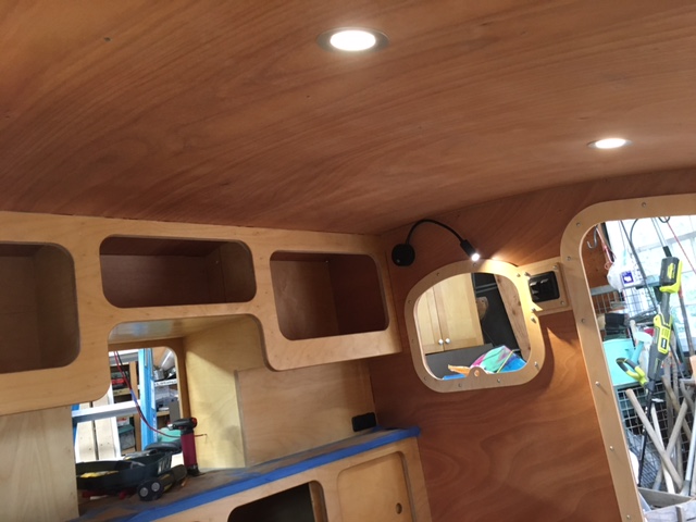

Got the headliner installed today. Like wrestling an alligator getting the ply to bend around that curve in the front. But my able body assistant and I had success. A milestone! If I had to do it again I think I might have wetted the curved area with boiling water and towels. But, it's done and glad to have that behind me. Also got a couple of spars installed... well just another oak piece installed where the hurricane hinge will mount and then a 5/4 poplar spar just off from that. The opening in the headliner is kind of an access area to wire in some electrical stuff. It will get covered with the insulation and outer ceiling. There's also an access panel on the inside for servicing it in case I need to get in there.

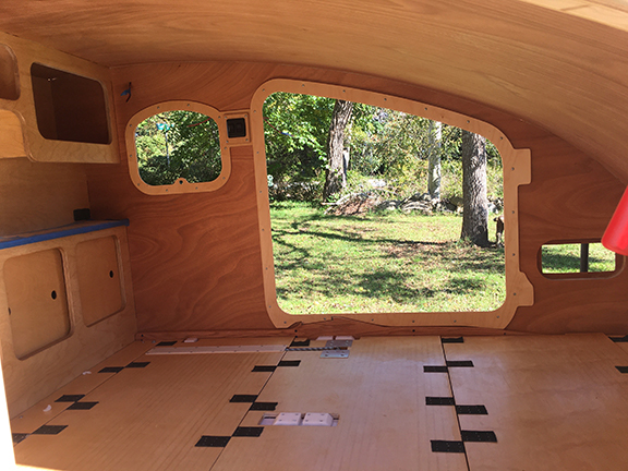

Attached are a couple of additional images I meant to post yesterday after installing the headliner.
headliner installed.jpg (378.96 KiB) Viewed 1256 times
Today I'll be installing the spars. Attached is an image of my "go by"... the rear opening is for the fan, the middle opening is for a picture window and the front opening is for storage.
sidewall-ceiling setup_10.13.21.jpg (241.14 KiB) Viewed 1256 times

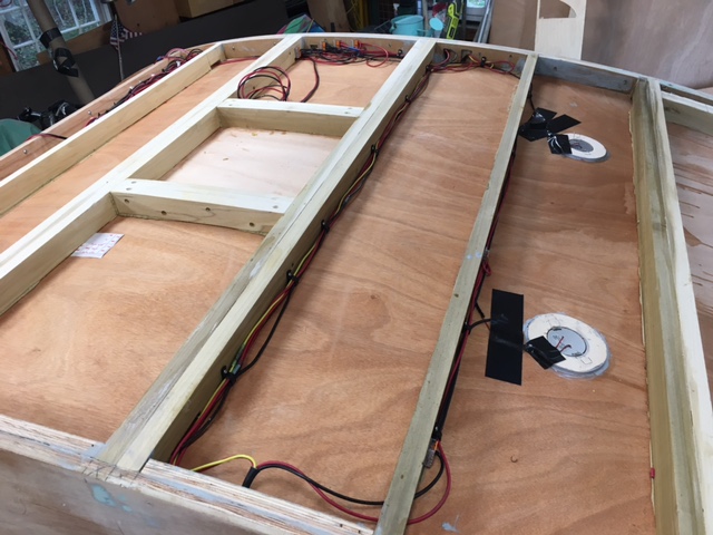

I've gotten most of the spars installed. Just need to install the blocking up on the inside 2 wall edges and then can start to finalize the wiring.
I used a piece of plywood that had a straight edge to check that all the surfaces of the spars were on the same plane especially in places like the picture window, fan and up front storage area where there's four spars in a row.
John

Postby Capebuild » Mon Oct 25, 2021 3:28 pm
10.25.2021
Another milestone.... installed enough wiring to test most of the circuits. All interior cabin lights installed, even the dimmer for the 2 main puck lighting works. The dimmer is nice in that the puck lights are bright. Porch lights are working.... as well as the 3 - 12 volt outlets and the 3 USB outlets.
Surprising how much wire is used. I had started with 100 feet of black and a 100 of red. Used all of that and then ordered another 75 feet of each. Used maybe a third of that so far....although pretty much finished with the trailer wiring connected to the house battery. For some of the connections I used those Wago connectors. Those things are great. They worked out really well. I used the model that accepts 5 wires. On one circuit with a number of fixtures I used a jumper from one Wago to another for another 4 connections. Easy to use and mounted them using VHB tape.
Next to hook up the lighting that will run from the tow vehicle (marker lights, tail lights, etc.) Also need to cut out for the fan and just make sure that works.

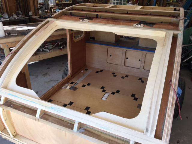

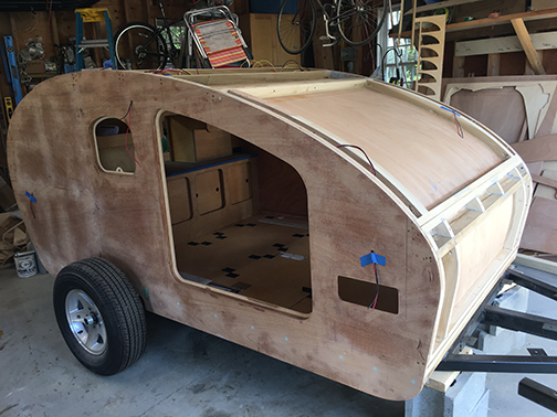

Postby Capebuild » Mon Nov 01, 2021 1:33 pm
Nov 1, 2021
featherliteCT1 wrote:As I watch your build, I find myself smiling with admiration for your work!
Hi FeatherliteCT1. Thank you very much for your nice comment. I appreciate your saying that!

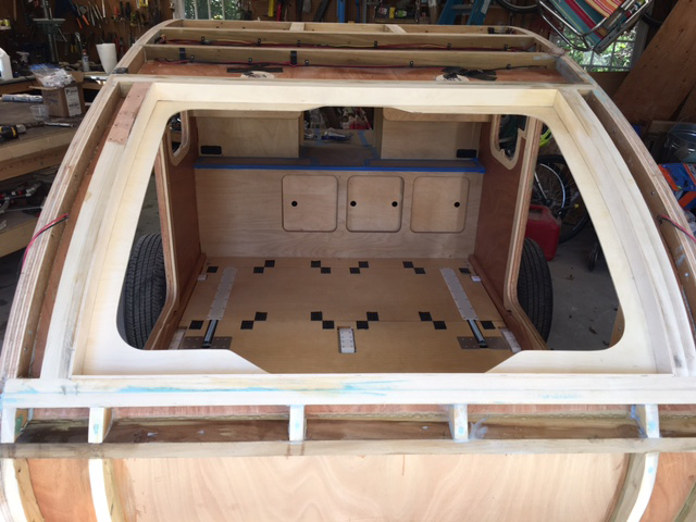

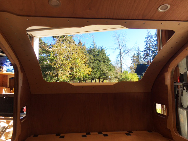

Got the framework for the picture window installed along with the interior frame molding where a pull down blind of some sort will reside between that frame and the window.
Made one frame and needed to change the layout a bit, made another (luckily had an extra sheet of 1/4 inch BB) and that worked well.
Hoping to get a start on the tow vehicle wiring of the lights that are on the trailer (marker, stop, tail lights, etc). Once that is complete I should be
able to start insulating the roof.
Also... on Friday my wife and I drove up to the Boston area and picked up the aluminum for the siding and also a sheet of polycarbonate for the windows.
Kind of a hairy ride home having fit the 6 sheets of 4x10' aluminum in our 4 x 6' utility trailer (took the local roads for most of the trip)... but made it. Made me realize
I need an anti rattle hardware on the connection between our hitch the Subaru receiver.
John

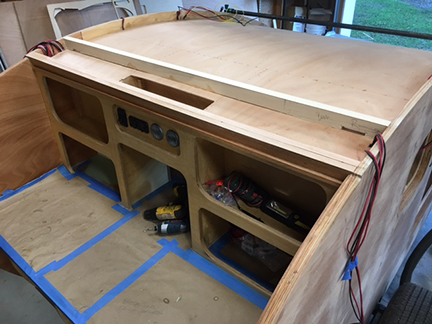

Postby Capebuild » Thu Nov 04, 2021 3:21 pm
November 4, 2021
Started finalizing the wiring from the tow vehicle until I ran out of wire. More on the way.
Cut out the front opening where a storage area will be (accessible from the interior) and started working on the outside construction to close that in.

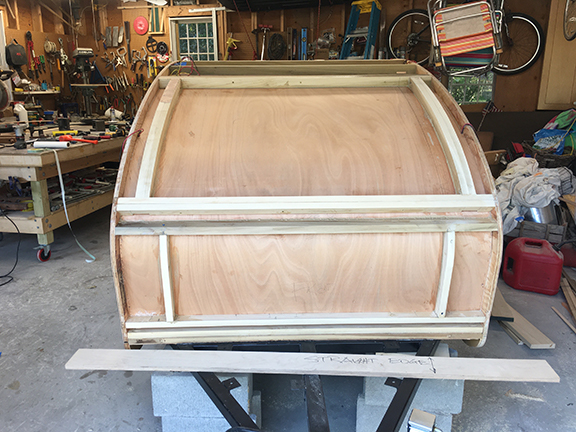

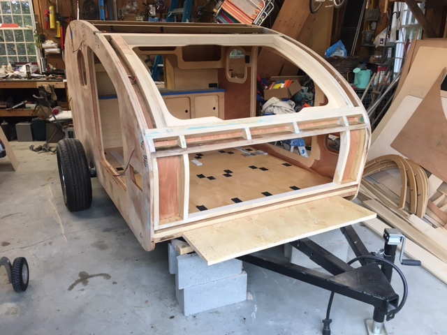

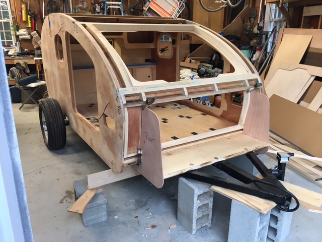

Postby Capebuild » Sun Nov 07, 2021 4:45 pm
11.7.21

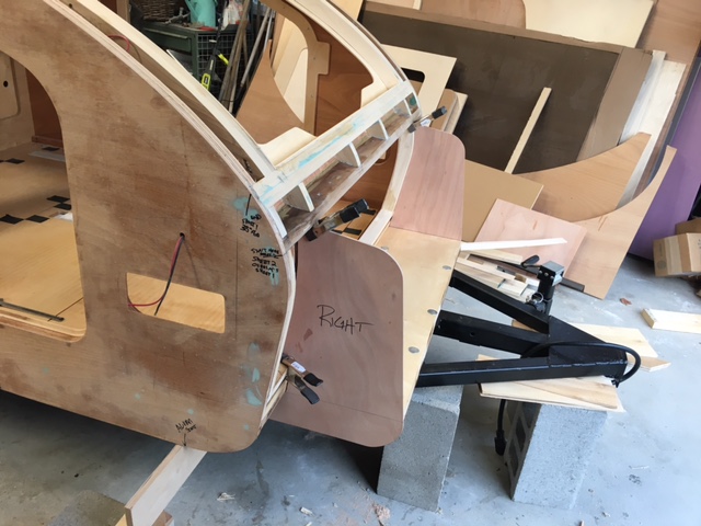

Working on the front bump out storage unit. Integrating the roll pans into that..taking a bit of thought to get all that to mesh and "weaving" it all around the chassis framing :thinking:
The board on the bottom shimmed up on the cinder blocks runs the width of the trailer and is making sure the two side wall's bottoms and the 2 wall bottoms of the bump out are on the same plane.

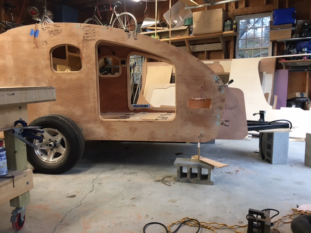

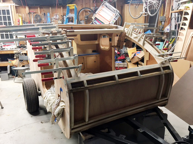

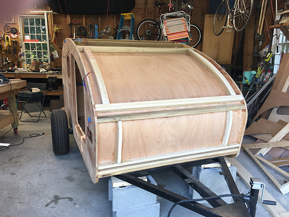

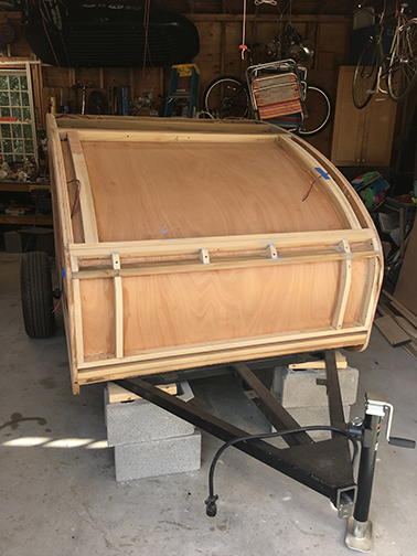

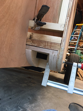

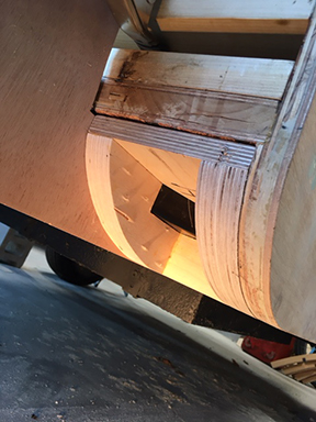

Postby Capebuild » Tue Nov 09, 2021 5:07 pm
11.9.21

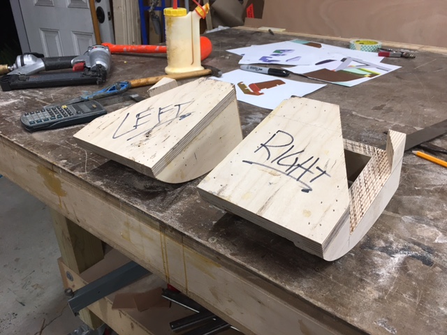

Working on the out side front roll pans (left and right). They will tie into the front storage bump out which also has its own roll pans. I simplified the design of those after looking at how others have done this. Some pics attached. The challenging part is getting them to mesh with the chassis frame members, which is one reason I simplified the pans that are part of the bump out. Will work on those tomorrow.
John

Re: CapeBuild Build Journal
Postby halfdome, Danny » Tue Nov 09, 2021 6:48 pm
Well John, you nailed it, nice roll pan structure's.
The challenging part will be to get the aluminum to go smoothly over your build up.
I found that's a vulnerable area for debris coming off the TV tires.
I put that peal and stick rino liner over that area and it gives a nice offset look.
:D Danny
