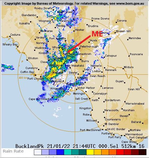

Postby MickinOz » Fri Jan 21, 2022 5:03 pm
Rain started at 7 am, its now 8.24 am and we've had 5mm (20 points/0.2 imches)
So not a downpour, just a continuous gentle rain that is forecast to go on all day.
It took about 24 hours for this rain system to travel 400 odd kilometres. It'll be over us for quite a while.
At least it has knocked down the summer heat.
I've disappeared under the rain radar.

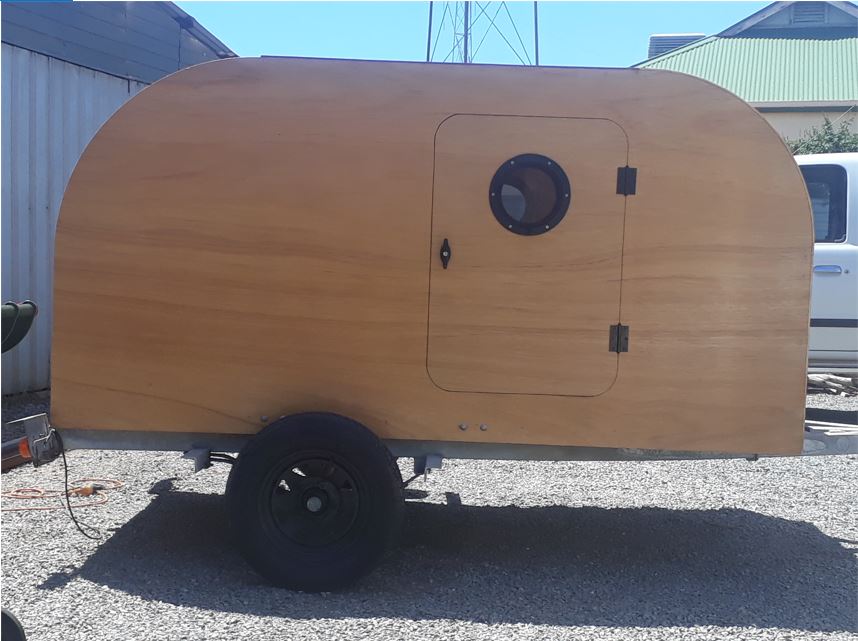

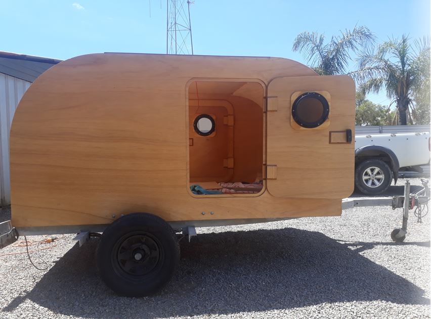

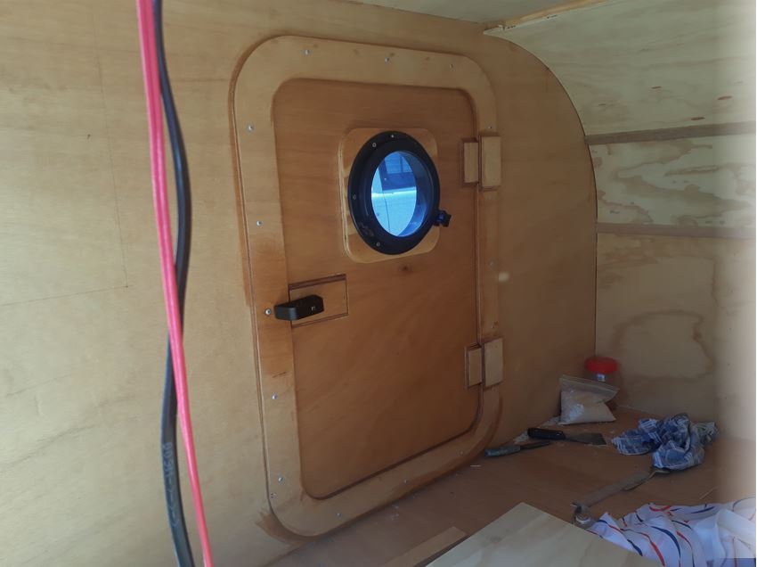

Postby MickinOz » Mon Jan 24, 2022 11:42 pm
One supposes one opens oneself to accusations of bias, but one does feel that one's first attempt at homemade doors came out alright.
One needs to fabricate some little striker plates for the inside, and perhaps one might have waited until later to install one's doors, but one does feel the better for having installed one's doors now. One needs the occasional visible evidence of one's progress to maintain one's enthusiasm and one's momentum.

Postby swoody126 » Tue Jan 25, 2022 7:04 am
MiO, those doors are quite impressive
fit appears to be spot on
been fun following along
your internal trim/door stop is well dunn

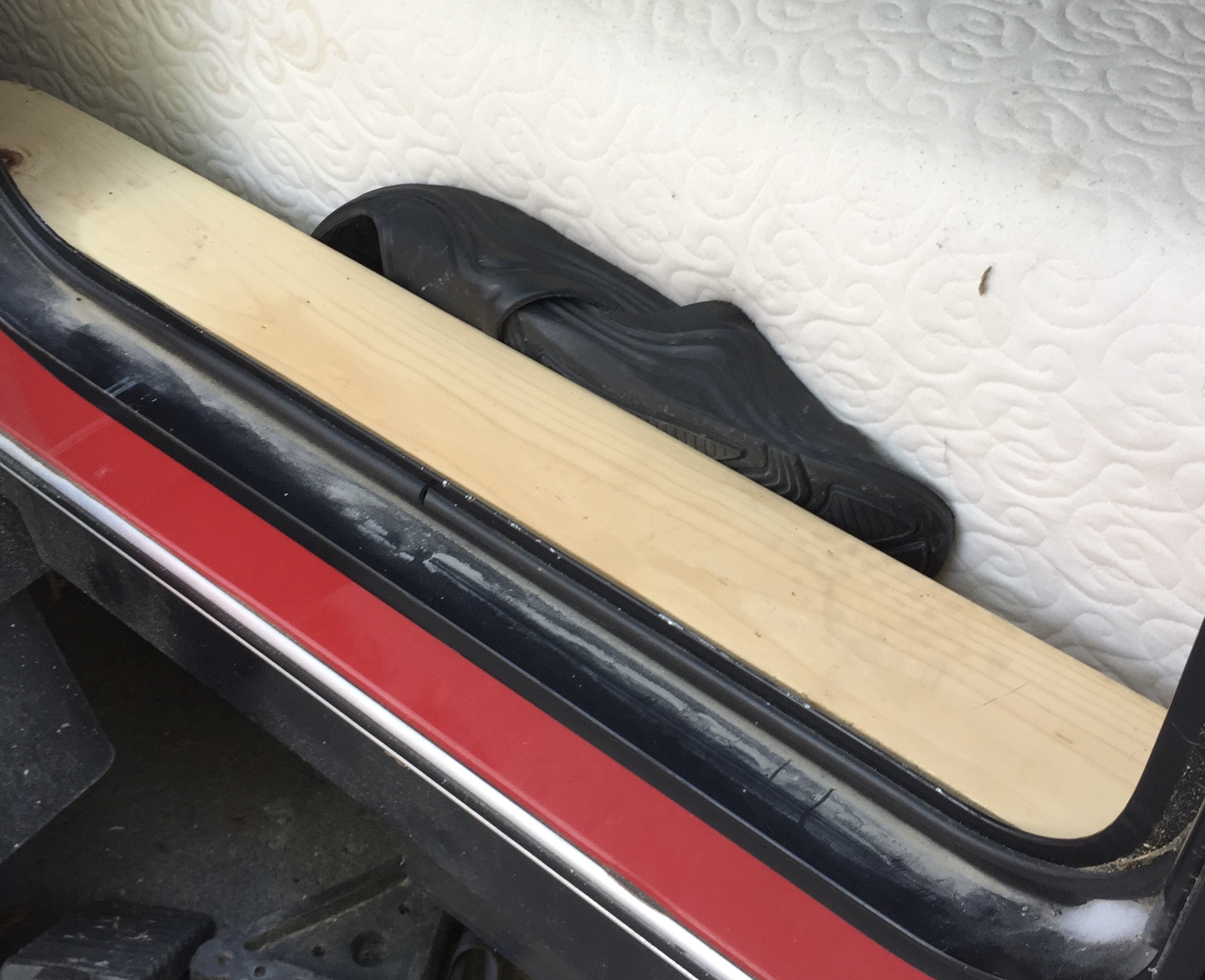

justa point some others have shared w/ me as i strolled a few TD events concerning door stop trim
when one opens the door and turns backwards to sit n remove shoes the door stop trim becomes a PITA so to speak
it tends to cut into the buttox and the sitter wriggles seeking a bit of comfort
when one is crawling into the TD on hands n knees the lip grinds into the shin bone which can be quite painful
one camper simply added a block of wood
IMG_3901 2.JPG (753.26 KiB) Viewed 352 times
others kept a small piece of carpet to place over the threshold
awareness of the potential issue is where i was headed
w/ your fit n finish abiities i figured you might just be able to head it off
KEEP UP THE GOOD WORK

Postby MickinOz » Tue Jan 25, 2022 7:45 am
Thanks mate.
The photos might give a bit of a false impression. The first 4 inches of sidewall on this build is floor framing and floor.
Wasteful I know, but I can't help building for nuclear Armageddon proof.
I have been following the usual advice and aiming for the door stop edge to be only halfway up the side of the mattress, which has worked quite fine on my first build.
The mattress on this build is at least a couple of inches higher than the door stop edge. I reckon the peanut butter jar in the corner is about mattress height.
But I think the mattress for this one is a bit softer than my first mattress. I'm hoping it won't sag too much under my lard ass.
