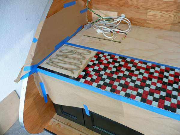

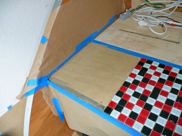

I don't want to derail your thread, but in case anyone is wondering how I attached the tile, here's the sequence:
Squirt on some PL Premium:
Trowel adhesive with throw-away v-notch trowel and apply tile:
Wait a few days to grout. "Squeegee" grout in with rubber grout float/trowel:
Wait till grout sets and remove haze. On epoxy grout, you have to remove haze before the full cure or it will never come off:
Now back to Michael's stunning build!

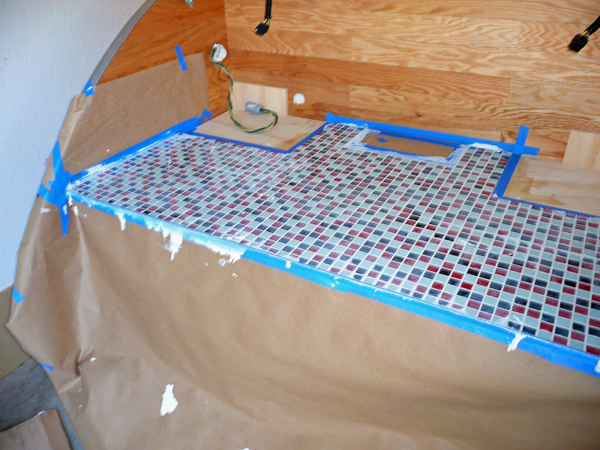

Per Tom's suggestion (aggie79) I located some Epoxy Grout and went to work. As Tom said, the work time is similar to other types of epoxy so you don't want to mix more than you can use before it kicks. Also, you must have it all cleaned up before it goes off! I found a little spot on the countertop that was almost permanent but luckily got it off in the nick of time. Of course, true to my "Swinging-Sixties-Here-I-Come" mentality, I added some silver holographic flake to the grout to give it some "pop." In the light it sparkles like diamonds with an array of colors. When Carrie gets home, she's going to say, "More hooker dust?!" Then roll her eyes and giggle like she always does... But hey I dig the flake, what can I say? Actually I decided on a nice charcoal grey and the flake looks amazing. It's fairly subtle and fits nicely with everything else. I'm pretty happy with the finished result, with the slight exception of the 90° corner but I couldn't come up with anything else, so I'll live with it. Notice the depth of the reflection in the epoxy countertop. Here's a few pix from today, now that the backsplash is complete. Feel free to weigh in on the finished product.

Good call on gray grout, I'd like it better than black as you have black tiles there. Do you have a close-up picture of the flakes on the tile grout? Curious how flakes work with non-clear grout.

Sorry, my bad, you already did the picture, nice!

I wish I were better at capturing the sparkle of the flake but it just doesn't translate in stills well. I'll see about posting a video.
