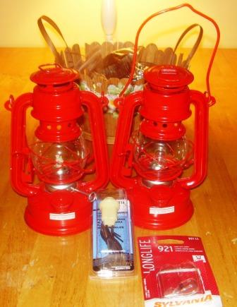

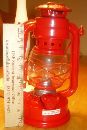

In the spirit of lighting a candle, rather than cursing the darkness, here are the lanterns that I am going to use to light the cabin of the camper.
I bought the two 8" lanterns from www.Amazon.com for $1.98 each + Shipping/Handling = About $14.00 total. They come in red or blue.
My friend David from the T&TTT forum helped me find the 12v socket and bulbs at the auto parts store.
I had to grind down the silver metal piece that used to hold the wick so that the socket would fit better.
Didn't turn out too bad, do you think?
The lamp on the left still has the original wick, the one on the right has the 12v bulb.

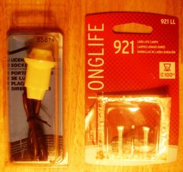

The socket is part#85814 License Sidemarker Socket, the bulb is Sylvania #921
That's gonna look real nice, I think.

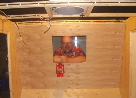

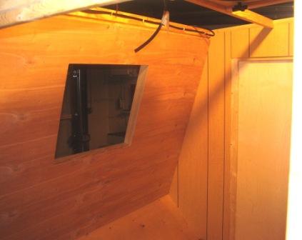

Tonight I used a router with a trim bit for the first time, to cut the front window out of the inside skin. What fun!
The inside front is skinned with 1/4" luan, the opening for the window is cut, and the upper front is insulated. Not bad for a Saturday night!
My sweet Wife says I look like a goof posing in the window with one of my wired 12v lanterns...Go figure! She married me! (Grin)
That was outside looking in, here is inside looking out!
That trim bit did a nice job, huh?
Wish I had known about routers with trim bits way back when I was cutting out the doors using a hand held jigsaw! Learning as I go...This will be important knowledge for my NEXT build!

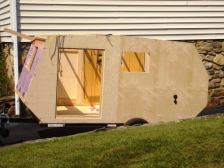

The camper is OK, I dried it out with towels as best I could, then pulled it outside to park it in the sunshine, which seemed to dry it out, over the course of the day. Beautiful beginning-of-Autumn day here in the mountains of Western NC.

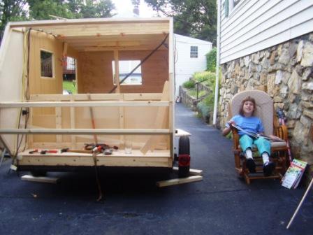

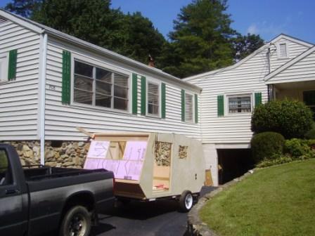

Anyway, this was the first time it has been out of the garage since I put the floor frame on the trailer. This is what it looked like in the sunshine...
My friend David, from the T&TTT list came over this afternoon, and we made lots of progress, but that is for the next post...

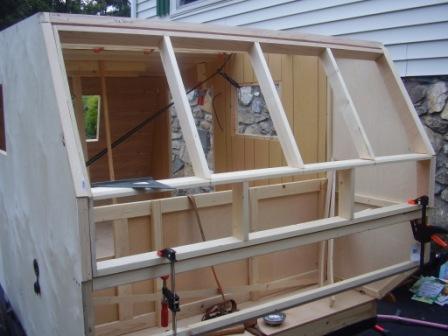

As per my last post, my friend David from the T&TTT list came over today and we made a lot of progress. We worked on the camper outdoors, in the front yard. It was a beautiful sunny, Autumn day here in the mountains.

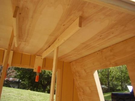

First we put the inner skin on the forward ceiling, 1/4" luan, holding it against the frame with braces and clamps.
Here are the two Zen Camper Building Masters, David and Al, in consultation about framing the hatch.
Oldest Daughter came out for awhile to supervise the work in progress. Like any good supervisor, she scolded us for the mess we were making, and asked why we didn't "just nail it all together" and get it finished...

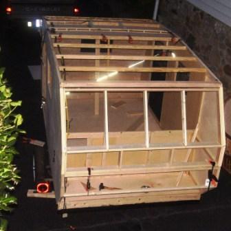

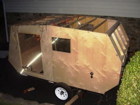

And "Voila", here is the hatch framed. We changed our plans a little in execution, but it looks good!
Here is a "view from above", taken from the porch, as I prepared to move the camper back into the garage.
A view from the side, at night...
So the day started with a flood and a crisis, but ended with some fun building and a lot of progress. Feels great to have the hatch framed out. Thanks to David for all of his help - Thanks to the T&TTT Forum for all the support.
