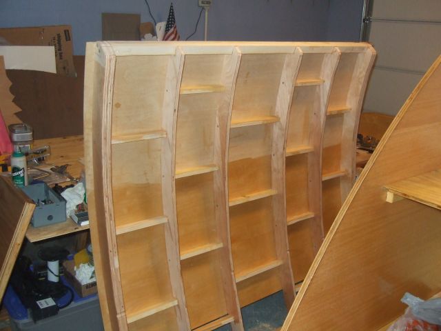

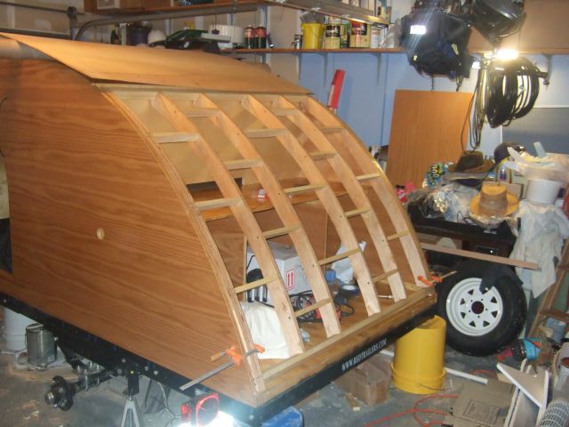

The finished frame is clamped into position. The first piece of skin attached will determine the "set" of the hatch so, I wanted to take some time.

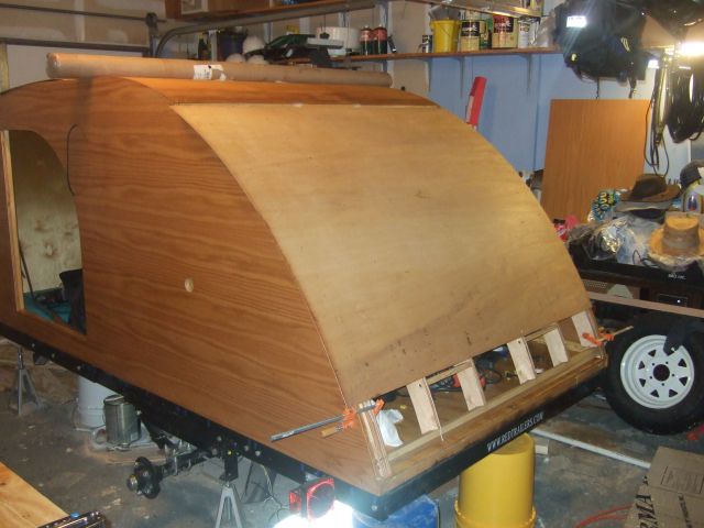

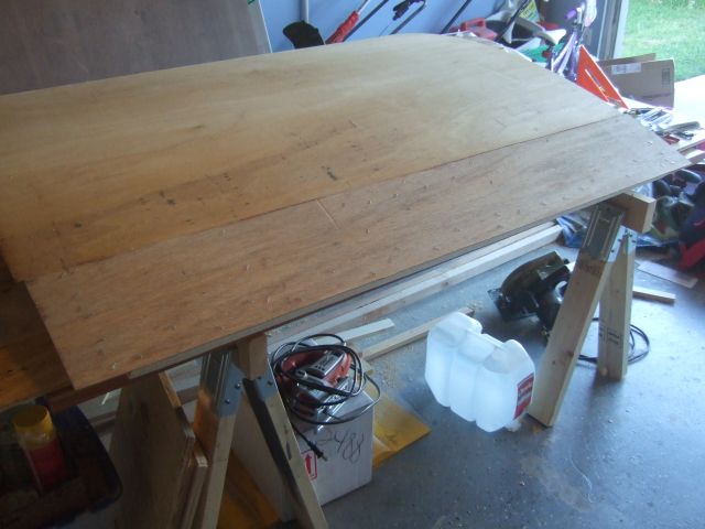

The major part of skin is attached. The roll on top is my outer roof skin.:)
I removed the hatch to clean excess glue off and get pictures of course.

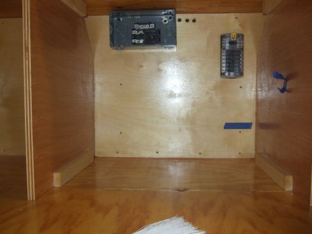

Power panels are in place. Gonna have to cram a battery box in here too. The Chief Designer (Exchequer of Accounts) has decreed a small microwave is needed in the galley.

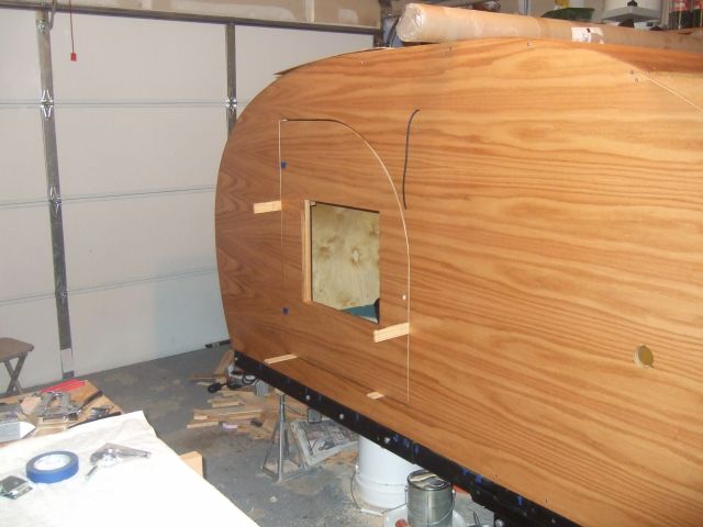

Postby Sparksalot » Sat Sep 13, 2008 7:17 pm

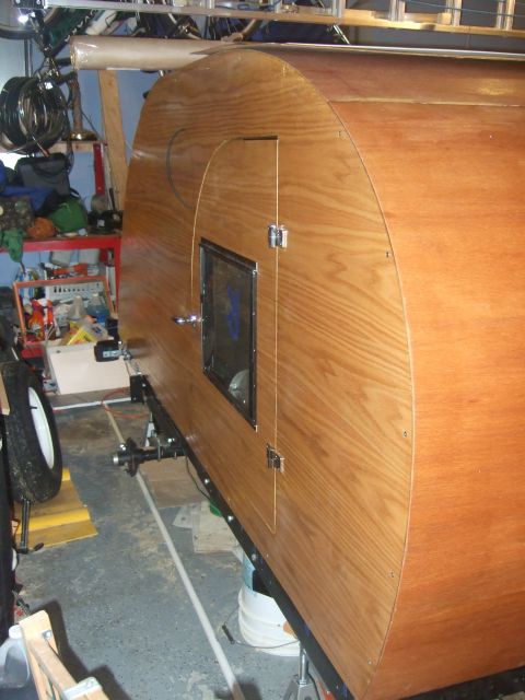

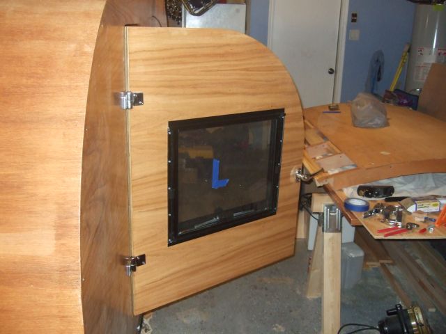

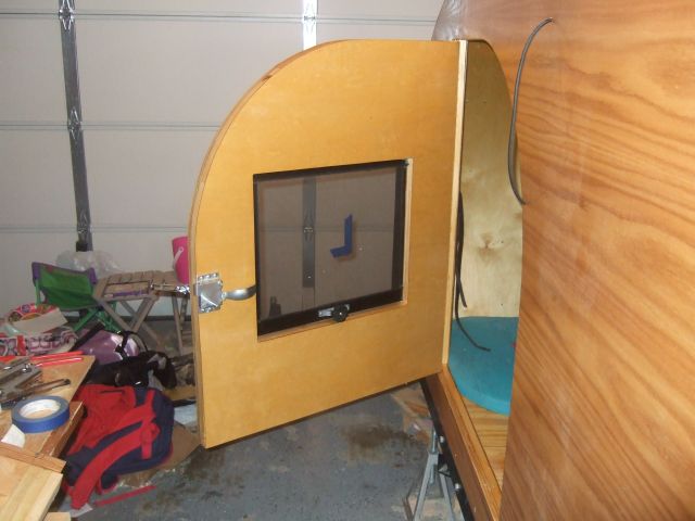

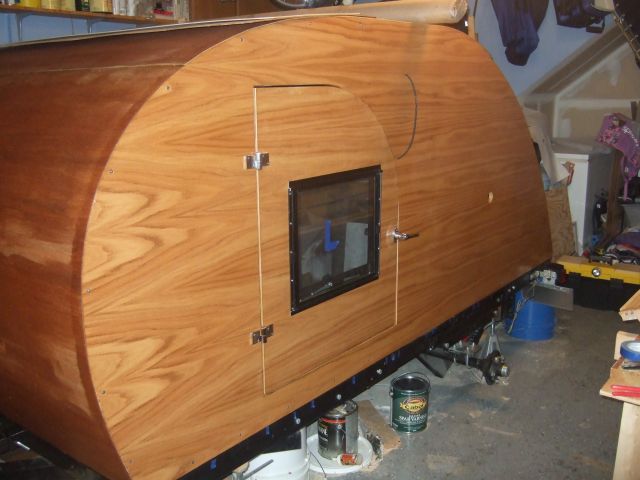

Door held in place with, well ya know, door shims.
All dressed up, and no wheels to go. The door looks much better on the trailer, rather than leaning against the fence I think.
Golly, it opens.
It even features an inner side.
Ventilation function.
Check.

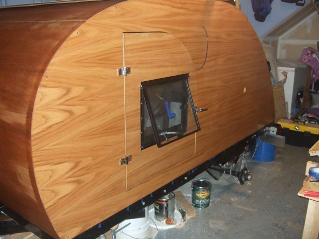

I'll bet ya'll didn't think Rose had a right side didja.

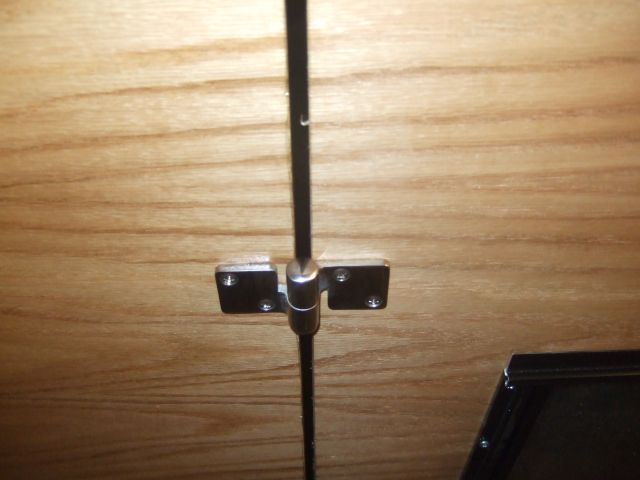

Hinge close up. I'll have to make some spacers to allow the trim to fit around the door and opening.

Postby 2bits » Sat Sep 13, 2008 7:20 pm
Man, you are rolling! ! ! Are those the lift off hinges where you cn remove the door?
Thomas
2bits
2bit Member
Posts: 5132
Location: Lake Tawakoni, TX
Postby Sparksalot » Sat Sep 13, 2008 7:31 pm
2bits wrote:Man, you are rolling! ! ! Are those the lift off hinges where you cn remove the door?
Yes, they are. I ordered them from McMaster-Carr. Heavy suckers too. Each hinge weighs a pound.
I also bought two extra lefts. My plan is to build a second left door sometime to mount a window shaker AC unit in place of the window.

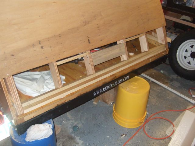

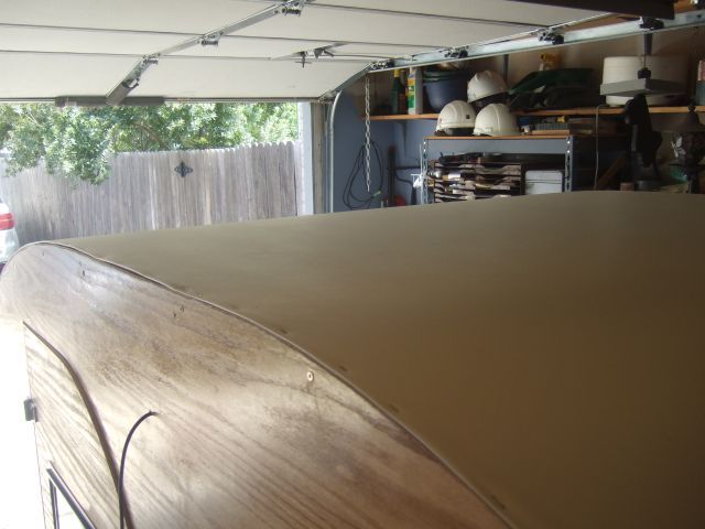

The lower portion of the hatch frame was trimmed up and skinned.
I've just realized the skinning is DONE. Here on out is just trim work.

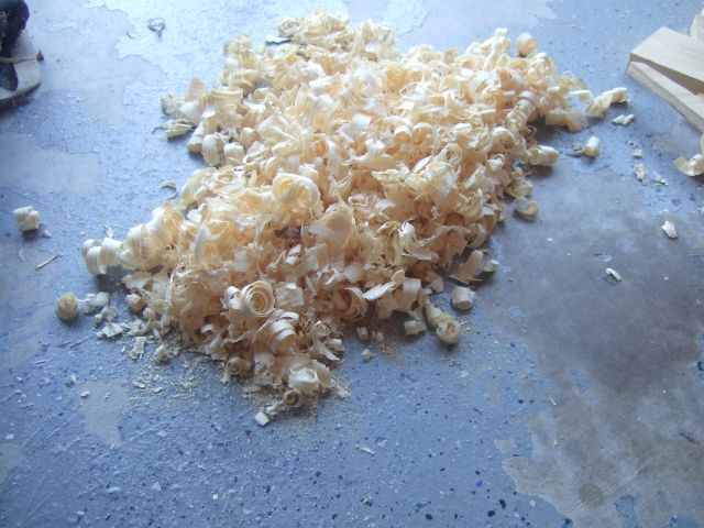

My piles of sawdust have taken on a decidedly traditional appearance.

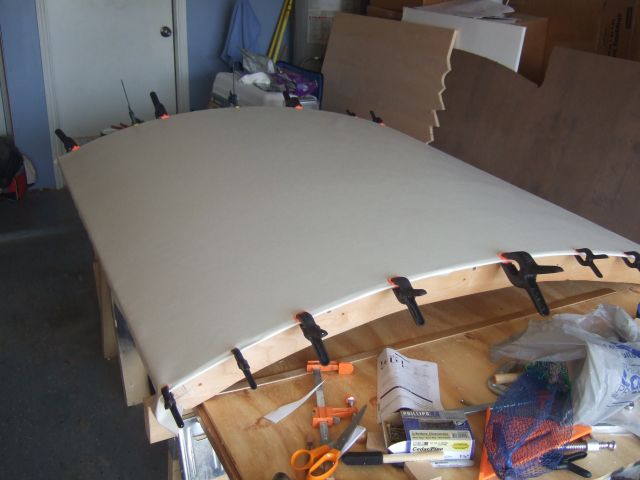

I received my order of foam recommended by DBizer. I glued it to the roof with headliner contact cement. It went on lickity-split.
Foamed up Hatch.

Postby rhltechie » Fri Sep 19, 2008 5:28 am
your build is coming along very nicely! what is this foam you speak of put on for?

Postby Sparksalot » Fri Sep 19, 2008 12:19 pm
rhltechie wrote:your build is coming along very nicely! what is this foam you speak of put on for?
Thanks. the foam is the underlayment for the vinyl roof.

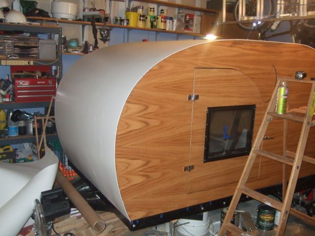

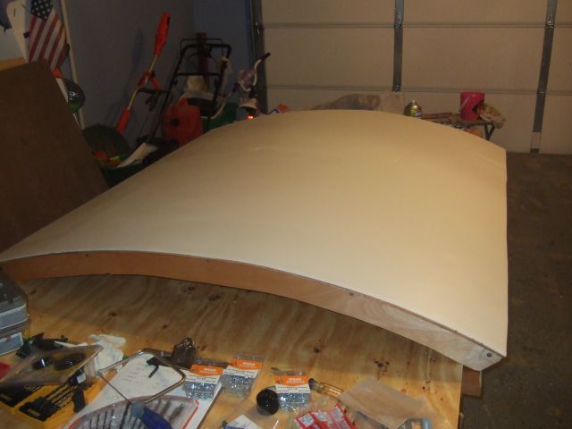

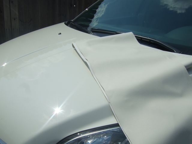

Postby Sparksalot » Sat Sep 20, 2008 4:11 pm
So, somebody is probably wondering what color this roof is going to be.
I hemmed and hawed on that for two month. I had finally decided to do a vinyl roof, but was kind of stuck on the silver diamond plate look Warpony has. I didn't like the $50/yard price, since I needed a 6 yard order. I was looking at the black version when it hit me to check tonneau cover material pricing. At $20/yeard it's much more palatable. So, I showed the Exchequer of Accounts the choice between the black diamond plate and black tonneau. She looked, and asked, "why not the cream white, to match your car?" I figuratively smacked my forehead. Duh, never thought of it.
BTW, It looks great. I ordered from Gary's Upholstery.

Postby Sparksalot » Sat Sep 20, 2008 4:16 pm

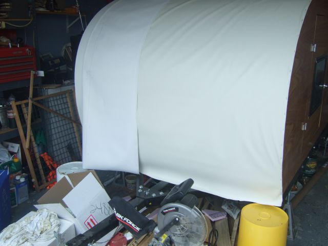

The hatch gets clamped up.
Over the top. One edge secured, and ready to stretch.
A look over the bow, before the fan goes on.

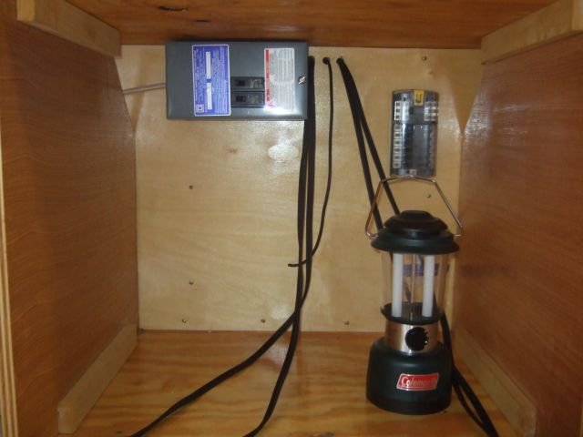

I did a little more wiring in between waiting for the contact cement to get tacky.
