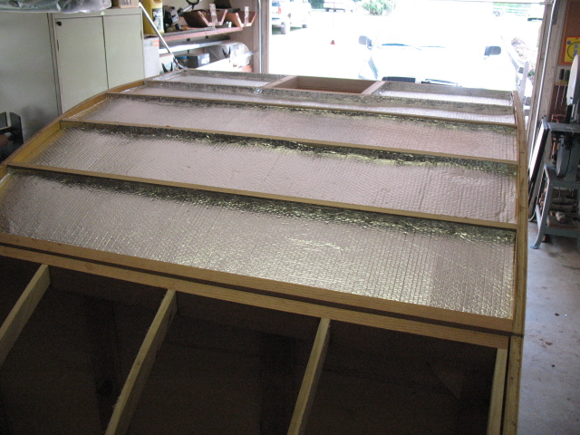

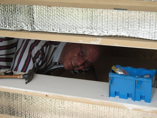

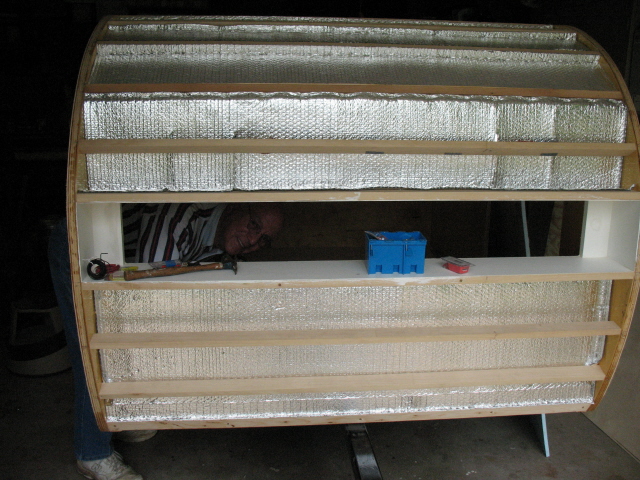

1/2" foam insulation installed between spars and foil-backed bubble wrap stapled over the top.
Grandpa looking through the "windshield" as he calls the front shelf:

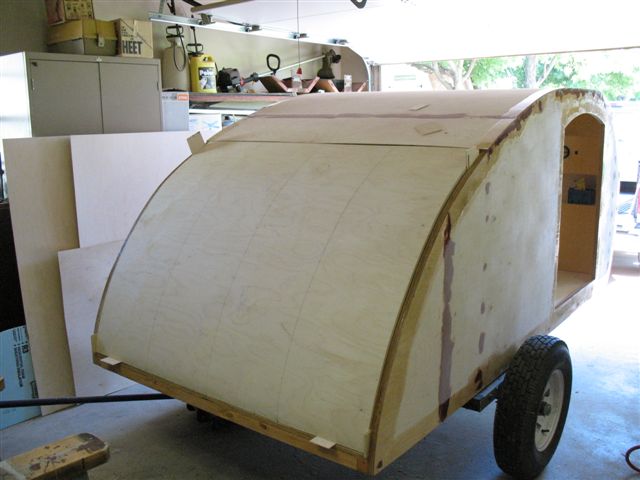

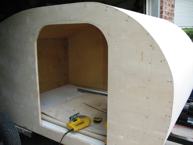

Outer skin attached on front and roof. Before door modification...
...and after.

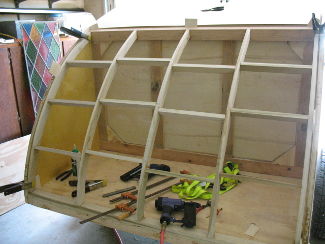

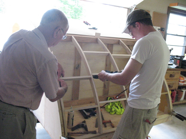

Grandpa and I putting the finishing touches on the hatch framing:
Today, I epoxied the edges. I'll wait til that cures and sand down the filler in some of my screw holes before coating the entire thing in as much epoxy as I have left. If I don't have enough to do all the surfaces, I'll varnish over the top of the whole thing before installing the aluminum skin.

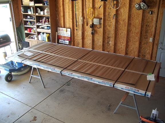

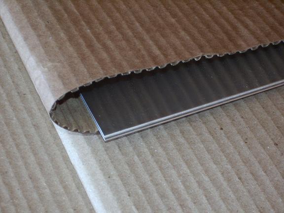

The weather turned today and we had a beautiful 85 degrees with sunny skies. Drove into Wichita to pick up the aluminum from Metals, USA. QUICK PLUG: These guys were great to work with. They are an industrial supplier, but never once did they make me feel like I was wasting their time. For my little order of 1 5x12, 1 5x10, 2 4x10 sheets of aluminum, they built a skid, wrapped each piece in corrogated paper, protected each edge with heavy cardboard, and bound it all to the skid. Then when I showed up with just my pickup truck, they happily donated two extra pallets to build up the floor so we could set the 5' wide skid over my wheel wells. All this plus several 12' pieces of flat stock for other areas on the trailer for $340 including tax. I'm a self-described cheapskate, but this was a real value.

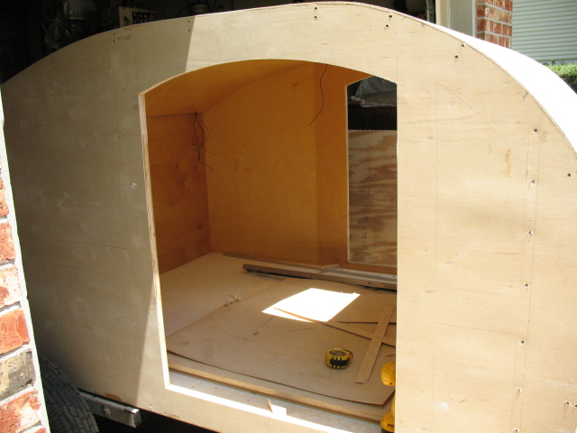

The hatch got skinned and test fit yesterday
It seems as if it will work fine and got two coats of epoxy. I'll be traveling for work each week for the next six months, so build time is steadily decreasing. I should be able to get a little work done next Thursday...
