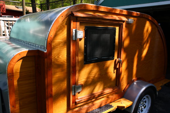

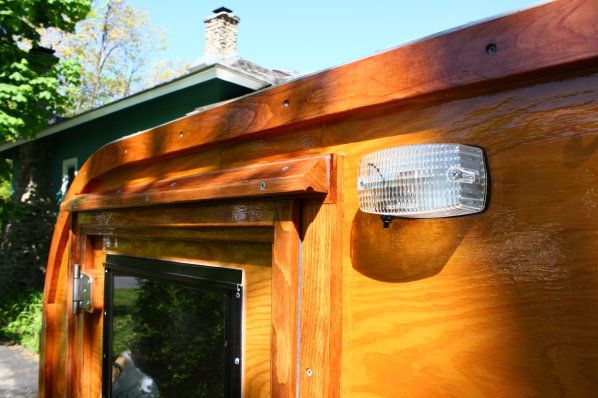

I rebuilt my doors that were slightly warped. Improved the design to decrease the possibility of getting water inside, and added a wooden drip edge over the door so when it rains the water does not run down the side of the camper and try to get in the door, but rather gets directed away from the door and falls harmlessly to the ground. I put a small groove on the underside of the drip edge to make sure that if the camper is on uneven ground the water cannot follow the underside of the drip edge back to the top of the door.
Picture of the door and drip edge follow.

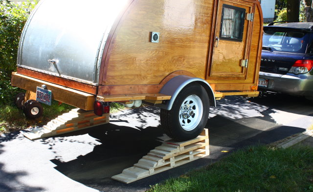

Before I get onto some pictures of the battery cage I am fabricating for under the Shack, a couple other pictures. I built a couple of ramps to drive my Shack up onto. It lifts the Shack almost an extra foot off the ground which makes all the difference in the world when it comes to working underneath the Shack. I only wish I had made these a year earlier so I could have enjoyed them early in the build process instead of at the very end.
